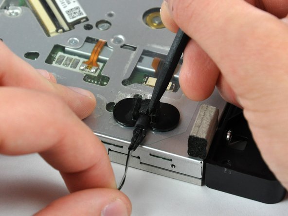

    • The optical drive thermal sensor is still attached to the underside of the optical drive.
  18. Installing iMac Intel 20" EMC 2133 and 2210 Dual Hard Drive, Optical Drive: crwdns2935265:018crwdnd2935265:01crwdnd2935265:02crwdne2935265:0 Installing iMac Intel 20" EMC 2133 and 2210 Dual Hard Drive, Optical Drive: crwdns2935265:018crwdnd2935265:02crwdnd2935265:02crwdne2935265:0
    • If necessary, remove the piece of foam tape covering the optical drive thermal sensor.
    • To remove the optical drive thermal sensor, use the tip of a spudger to lift the center finger of the thermal sensor bracket while applying slight tension to the thermal sensor cable.
    • If your thermal sensor is stuck to the optical drive, skip to the next step.
  19. Installing iMac Intel 20" EMC 2133 and 2210 Dual Hard Drive: crwdns2935265:019crwdnd2935265:01crwdnd2935265:01crwdne2935265:0
    • Use the flat end of a spudger to pry the optical drive thermal sensor bracket up off the adhesive securing it to the optical drive.
    • If the adhesive gets dirty or will not stick to your new optical drive, place some double-sided tape under the two semicircular ears of the thermal sensor bracket.

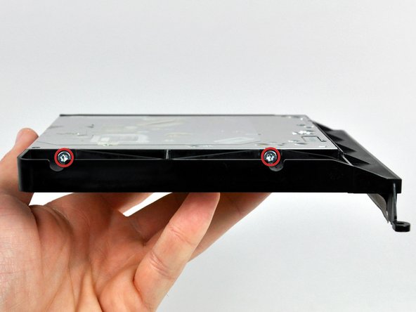

    • Remove the two 6.5 mm T10 Torx screws from both sides of the optical drive (four screws total).
  22. Installing iMac Intel 20" EMC 2133 and 2210 Dual Hard Drive: crwdns2935265:022crwdnd2935265:01crwdnd2935265:01crwdne2935265:0
    • Peel the strip of EMI tape off the optical drive.
    • Don't forget to transfer this to your new optical drive.
