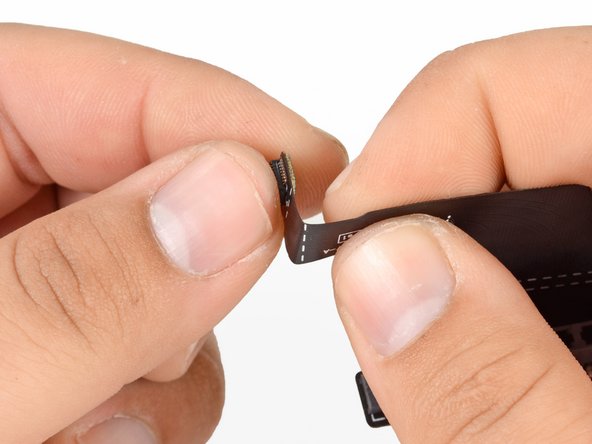

  28. Installing Mac mini Mid 2011 Dual Hard Drive Kit: crwdns2935265:028crwdnd2935265:01crwdnd2935265:02crwdne2935265:0 Installing Mac mini Mid 2011 Dual Hard Drive Kit: crwdns2935265:028crwdnd2935265:02crwdnd2935265:02crwdne2935265:0
    • Bend the ribbon cable along the dotted lines to help the connectors remain seated in their sockets.
    • Bend the ribbon cable 90 degrees at the SSD connector so that it is parallel to the connector.
  29. Installing Mac mini Mid 2011 Dual Hard Drive Kit: crwdns2935265:029crwdnd2935265:01crwdnd2935265:02crwdne2935265:0 Installing Mac mini Mid 2011 Dual Hard Drive Kit: crwdns2935265:029crwdnd2935265:02crwdnd2935265:02crwdne2935265:0
    • Use the edge of the SSD connector to put a 90 degree downward bend in the cable along the first large dotted line.
    • Bend the ribbon cable back up 90 degrees along the second large dotted line.

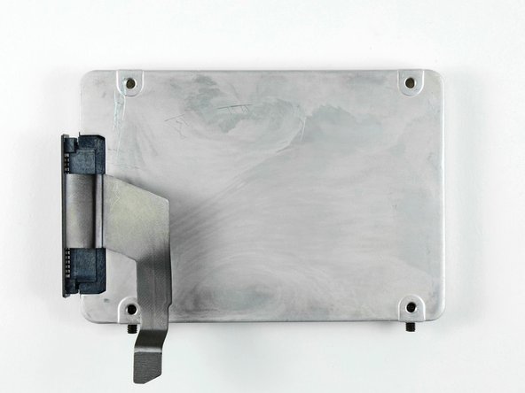

  30. Installing Mac mini Mid 2011 Dual Hard Drive Kit: crwdns2935265:030crwdnd2935265:01crwdnd2935265:02crwdne2935265:0 Installing Mac mini Mid 2011 Dual Hard Drive Kit: crwdns2935265:030crwdnd2935265:02crwdnd2935265:02crwdne2935265:0
    • Hold the ribbon cable on either side of the first small dotted line and bend it up 90 degrees.
  31. Installing Mac mini Mid 2011 Dual Hard Drive Kit: crwdns2935265:031crwdnd2935265:01crwdnd2935265:02crwdne2935265:0 Installing Mac mini Mid 2011 Dual Hard Drive Kit: crwdns2935265:031crwdnd2935265:02crwdnd2935265:02crwdne2935265:0
    • Bend the ribbon cable down 90 degrees along the second small dotted line.
  32. Installing Mac mini Mid 2011 Dual Hard Drive Kit: crwdns2935265:032crwdnd2935265:01crwdnd2935265:01crwdne2935265:0
    • Attach the cable included in the kit to your second hard drive. In our case, we are using an SSD.
    • If your cable came with a small piece of black tape with rounded corners, you can install it over the hard drive cable connector to secure the connector to its socket on the hard drive. The piece of tape is not required and not installing it will have no adverse effects on your machine's performance.
    • Before attaching the cable to your hard drive make sure it has been properly folded along the dotted white lines. This will help the cable attach and stay in-place.

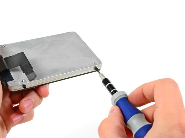

  33. Installing Mac mini Mid 2011 Dual Hard Drive Kit: crwdns2935265:033crwdnd2935265:01crwdnd2935265:03crwdne2935265:0 Installing Mac mini Mid 2011 Dual Hard Drive Kit: crwdns2935265:033crwdnd2935265:02crwdnd2935265:03crwdne2935265:0 Installing Mac mini Mid 2011 Dual Hard Drive Kit: crwdns2935265:033crwdnd2935265:03crwdnd2935265:03crwdne2935265:0
    • Use a T6 Torx screwdriver to install two of the set screws on the side of the hard drive closest to the end of the hard drive cable that attaches to the logic board.
    • Tighten the screws until they contact the end of the threaded holes in the side of the hard drive. They are shown correctly installed in the third picture.

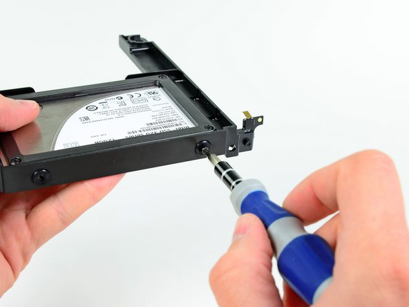

  34. Installing Mac mini Mid 2011 Dual Hard Drive Kit: crwdns2935265:034crwdnd2935265:01crwdnd2935265:03crwdne2935265:0 Installing Mac mini Mid 2011 Dual Hard Drive Kit: crwdns2935265:034crwdnd2935265:02crwdnd2935265:03crwdne2935265:0 Installing Mac mini Mid 2011 Dual Hard Drive Kit: crwdns2935265:034crwdnd2935265:03crwdnd2935265:03crwdne2935265:0
    • In the next two steps, you will install the hard drive into its bracket.
    • When inserting the hard drive, be sure to place it in its bracket cable side up with the SATA connector closest to the bulge in the bracket seen in the third picture.
    • Push the set screws into the grommets in the bracket and install the hard drive up into its bracket as seen in the second picture.
  35. Installing Mac mini Mid 2011 Dual Hard Drive Kit: crwdns2935265:035crwdnd2935265:01crwdnd2935265:02crwdne2935265:0 Installing Mac mini Mid 2011 Dual Hard Drive Kit: crwdns2935265:035crwdnd2935265:02crwdnd2935265:02crwdne2935265:0
    • Use a T6 Torx screwdriver to install the remaining two set screws through the grommets and into the side of the hard drive.
