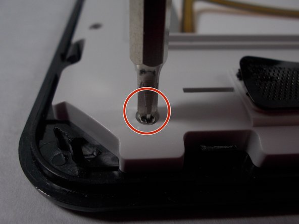

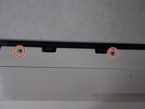

    • Use a Phillips #0 screwdriver to remove the 17 screws marked in red.
  8. Insignia Flex 10.1 Speaker Replacement: crwdns2935265:08crwdnd2935265:01crwdnd2935265:01crwdne2935265:0
    • Once the screws are removed, peel off the final screen covering the speaker like shown.
