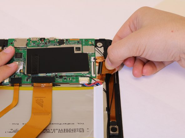

  4. Insignia Flex 10.1 NS-P10W8100 Camera Replacement: crwdns2935265:04crwdnd2935265:01crwdnd2935265:02crwdne2935265:0 Insignia Flex 10.1 NS-P10W8100 Camera Replacement: crwdns2935265:04crwdnd2935265:02crwdnd2935265:02crwdne2935265:0
    • Carefully remove the yellow tape holding down the camera ribbon connector by pulling it upwards.
    • Remove the black tape holding down the camera ribbon connector which is attached to the motherboard.

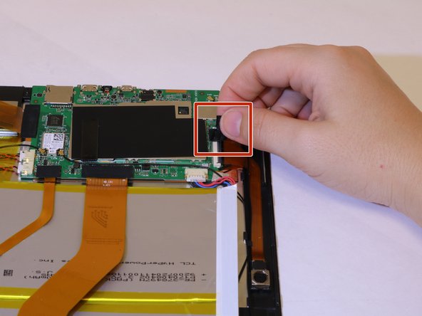

  5. Insignia Flex 10.1 NS-P10W8100 Camera Replacement: crwdns2935265:05crwdnd2935265:01crwdnd2935265:02crwdne2935265:0 Insignia Flex 10.1 NS-P10W8100 Camera Replacement: crwdns2935265:05crwdnd2935265:02crwdnd2935265:02crwdne2935265:0
    • Disconnect the zero insertion force (ZIF) connector by using your fingernail to flip the small locking flap.
    • Disconnect the cable by gently pulling it outward.
