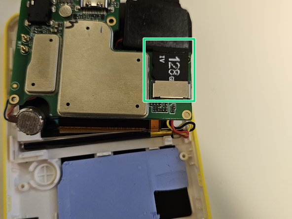

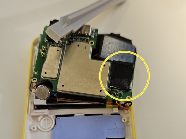

  3. Innioasis Y1 SD Card Replacement, Flip the Board: crwdns2935265:03crwdnd2935265:01crwdnd2935265:03crwdne2935265:0 Innioasis Y1 SD Card Replacement, Flip the Board: crwdns2935265:03crwdnd2935265:02crwdnd2935265:03crwdne2935265:0 Innioasis Y1 SD Card Replacement, Flip the Board: crwdns2935265:03crwdnd2935265:03crwdnd2935265:03crwdne2935265:0
    • Carefully Lift the board up and towards the screen. You may need to lightly pry the battery out of its socket
    • Remove the tape
    • Slide the Micro SD card out of the socket

Tired of waiting for a reaction to my questions above I bought a Samsung 512GB Micro SD Evo Plus UHS-I U3 SDcard. Maybe overkill, but very fast. the replacement of the card was a 5 minutes job. Now I am copying the contents of the old 128GB card to the Innioasis Y3 which will take hours I guess. I let everyone know if it all works fine.
P. Reuvers - crwdns2934203:0crwdne2934203:0
It works great. Only one small issue. The Innioasis Y1 shows that it contain 128GB, But he shows the correct used and available space, at this moment I used 143GB of the 512GB, more then the original Innioasis Y1.
P. Reuvers -
Any suggestion on how to format the SD Card? thanks
Paninaro -
Will this work with an ExFAT format card or just FAT32? Thanks
jjedwards894 - crwdns2934203:0crwdne2934203:0
ExFAT worked fine for me.
