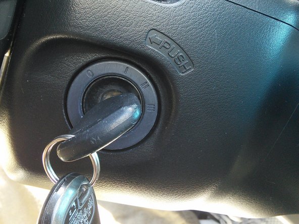

    • Insert the ignition key into the ignition lock. Leave it in the 0 or I position.

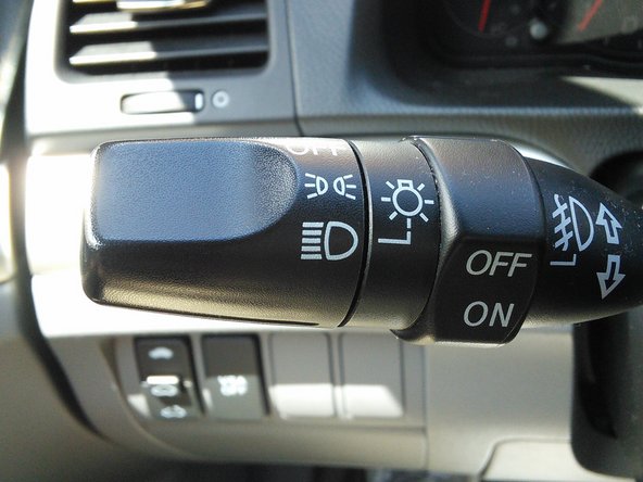

    • Turn the headlights ON.

    • Turn the ignition switch to ON (position II).
    • Some of the instrument lights will come on. If you aren't wearing your seatbelt, the seatbelt warning chime will sound.

    • Within five seconds, and still holding in the Sel/Reset button, turn the headlights OFF, then ON, then OFF again.
