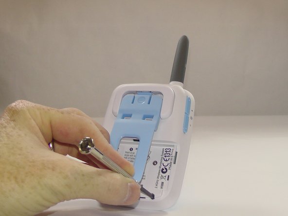

    • Press on the blue clip on the back and slide it down.
    • In the second picture there is a slight gap at the top of the blue clip.
  2. Infant Optics DXR-5 Mother Board Replacement: crwdns2935265:02crwdnd2935265:01crwdnd2935265:01crwdne2935265:0
    • Pull the blue clip away from the body of the hand held monitor.

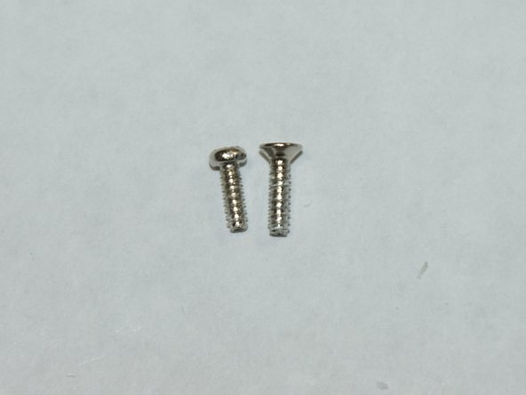

    • Remove the four 6.0 mm Phillips screws located on the back of the hand held monitor using a Phillips #2 screwdriver.
    • There are two types of screws. Be sure to return the screws to their respective holes upon reassembly.

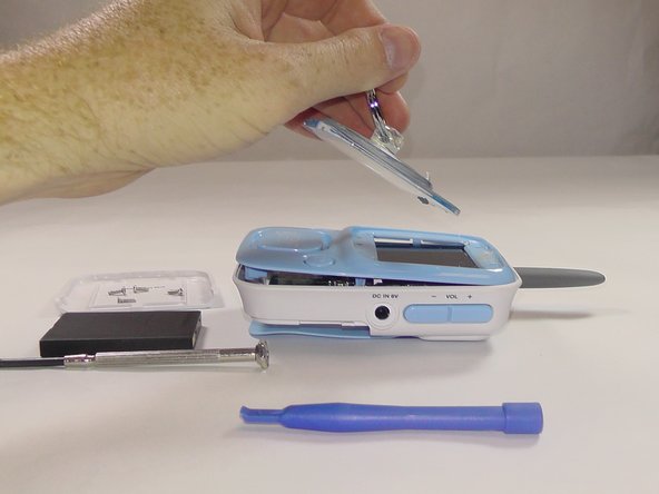

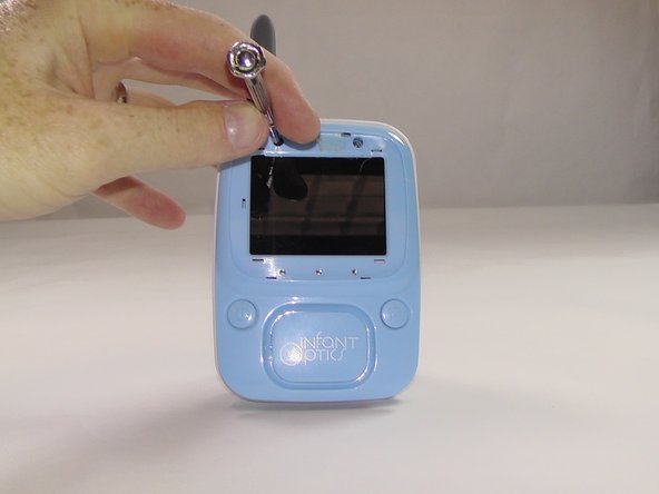

    • Carefully remove the clear face plate on the front of the hand held monitor using a plastic spudger and a suction cup.
    • Use a heat source to loosen the adhesive around the edge of the face plate before applying any pressure to the face plate.
  7. Infant Optics DXR-5 Mother Board Replacement: crwdns2935265:07crwdnd2935265:01crwdnd2935265:02crwdne2935265:0 Infant Optics DXR-5 Mother Board Replacement: crwdns2935265:07crwdnd2935265:02crwdnd2935265:02crwdne2935265:0
    • Using a Phillips #2 screwdriver, remove the two 6.0 mm Phillips screws that are exposed after removing the face plate.

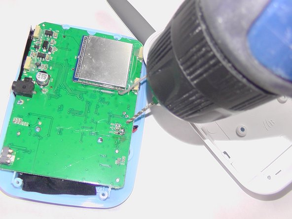

  8. Infant Optics DXR-5 Mother Board Replacement: crwdns2935265:08crwdnd2935265:01crwdnd2935265:02crwdne2935265:0 Infant Optics DXR-5 Mother Board Replacement: crwdns2935265:08crwdnd2935265:02crwdnd2935265:02crwdne2935265:0
    • Using a drill carefully drill out the plastic posts that connect the mother board to the face plate.

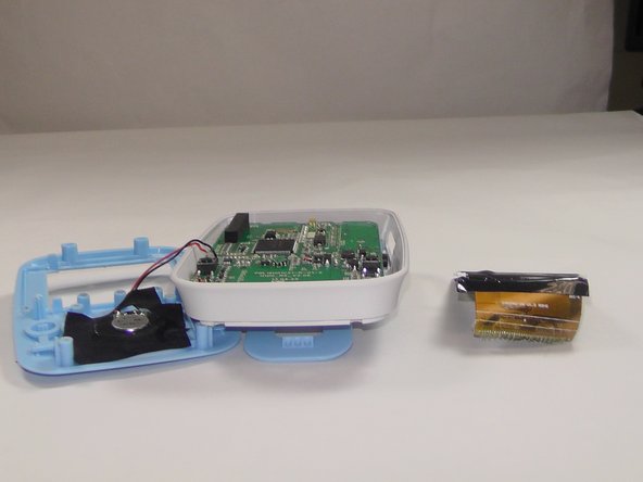

  9. Infant Optics DXR-5 Mother Board Replacement: crwdns2935265:09crwdnd2935265:01crwdnd2935265:02crwdne2935265:0 Infant Optics DXR-5 Mother Board Replacement: crwdns2935265:09crwdnd2935265:02crwdnd2935265:02crwdne2935265:0

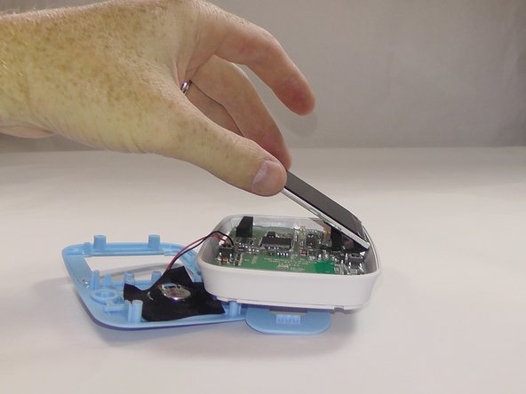

    • Carefully open the hand held monitor and flip the screen (highlighted in red) out of the way.
  10. Infant Optics DXR-5 Mother Board Replacement: crwdns2935265:010crwdnd2935265:01crwdnd2935265:02crwdne2935265:0 Infant Optics DXR-5 Mother Board Replacement: crwdns2935265:010crwdnd2935265:02crwdnd2935265:02crwdne2935265:0
    • Remove the hand held monitor screen from the mother board by carefully pulling from the point where it is attached with an adhesive to the mother board.
  11. Infant Optics DXR-5 Mother Board Replacement, Mother Board: crwdns2935265:011crwdnd2935265:01crwdnd2935265:01crwdne2935265:0
    • Using a soldering iron remove the leads from the speaker on the front plate of the hand held monitor.
    • The leads must be put back in the correct order.

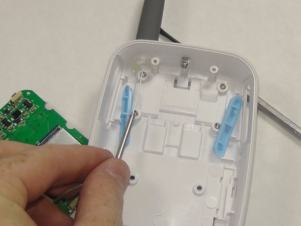

    • Remove the adhesive around the antenna wire.
    • Remove the antenna wire from the back plate of the hand held monitor.
