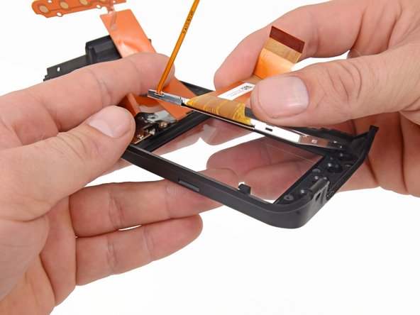

    2. Identifying Major Electronic Components, Digitizer: crwdns2935265:02crwdnd2935265:01crwdnd2935265:03crwdne2935265:0 Identifying Major Electronic Components, Digitizer: crwdns2935265:02crwdnd2935265:02crwdnd2935265:03crwdne2935265:0 Identifying Major Electronic Components, Digitizer: crwdns2935265:02crwdnd2935265:03crwdnd2935265:03crwdne2935265:0
      • Digitizers allow your device to recognize when and where you touch the screen. Digitizers themselves do not produce your device's visuals—that's the job of the display panel.
      • They can usually be identified by a large glass panel, and a digitizer ribbon cable that connects it to the rest of the device.
      • A growing number of modern devices, such as the iPhone, are combining the digitizer and the display panel into a single display assembly. This means that if either component fails, you need to replace the entire assembly.

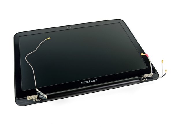

    3. Identifying Major Electronic Components, Display Panel: crwdns2935265:03crwdnd2935265:01crwdnd2935265:03crwdne2935265:0 Identifying Major Electronic Components, Display Panel: crwdns2935265:03crwdnd2935265:02crwdnd2935265:03crwdne2935265:0 Identifying Major Electronic Components, Display Panel: crwdns2935265:03crwdnd2935265:03crwdnd2935265:03crwdne2935265:0
      • The display panel is what shows all of your device's visuals.
      • Although there are a wide variety of display panel types and sizes (LCD, LED, OLED, AMOLED), they're typically the most prominent feature of the device, which makes them very easy to identify. Look for a ribbon cable that connects the panel to the rest of the device.

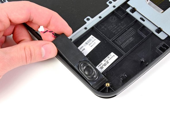

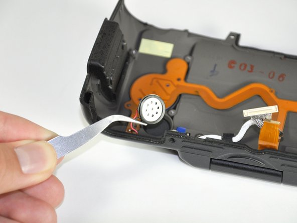

    4. Identifying Major Electronic Components, Speakers: crwdns2935265:04crwdnd2935265:01crwdnd2935265:03crwdne2935265:0 Identifying Major Electronic Components, Speakers: crwdns2935265:04crwdnd2935265:02crwdnd2935265:03crwdne2935265:0 Identifying Major Electronic Components, Speakers: crwdns2935265:04crwdnd2935265:03crwdnd2935265:03crwdne2935265:0
      • Speakers provide sound for a wide variety of devices. They convert an electrical signal to sound by using magnets to vibrate a flexible cone inside of an acoustic chamber. This vibration creates the sound waves that your ears hear.
      • Speakers come in many shapes and sizes, but are generally easily identified. To locate the speakers on a device, look for some sort of speaker grille coupled with a hollow acoustic chamber.

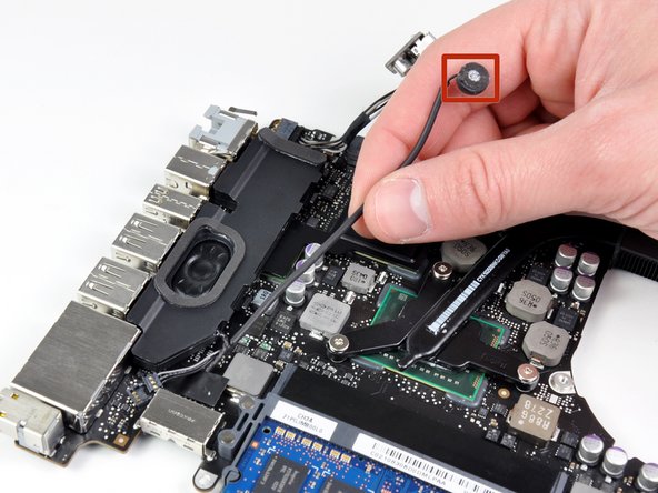

    5. Identifying Major Electronic Components, Microphone: crwdns2935265:05crwdnd2935265:01crwdnd2935265:03crwdne2935265:0 Identifying Major Electronic Components, Microphone: crwdns2935265:05crwdnd2935265:02crwdnd2935265:03crwdne2935265:0 Identifying Major Electronic Components, Microphone: crwdns2935265:05crwdnd2935265:03crwdnd2935265:03crwdne2935265:0
      • Microphones are an integral component of many modern devices. They take sound waves and convert it to electrical signals that can then be recorded and transferred.
      • To identify where the microphone is on your device, look for a small grille on the casing. Generally, the word "Mic" is written next to it, or there is a small picture of a microphone.

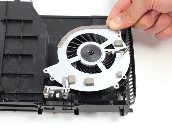

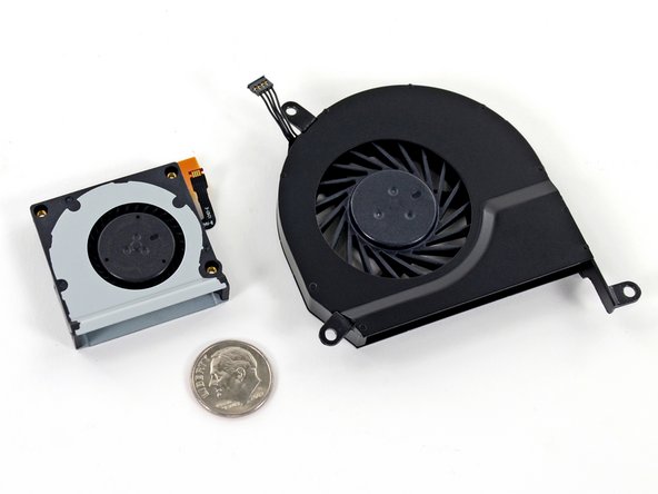

    7. Identifying Major Electronic Components, Cooling Fan: crwdns2935265:07crwdnd2935265:01crwdnd2935265:03crwdne2935265:0 Identifying Major Electronic Components, Cooling Fan: crwdns2935265:07crwdnd2935265:02crwdnd2935265:03crwdne2935265:0 Identifying Major Electronic Components, Cooling Fan: crwdns2935265:07crwdnd2935265:03crwdnd2935265:03crwdne2935265:0
      • Fans are commonly found in larger devices such as laptops, which need dedicated cooling.
      • Fans can vary greatly in size and shape, so look for a component with a circular hole that has fan blades inside of it.

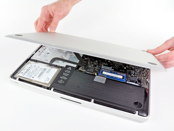

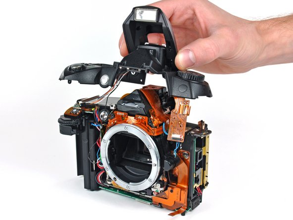

    8. Identifying Major Electronic Components, Casing: crwdns2935265:08crwdnd2935265:01crwdnd2935265:03crwdne2935265:0 Identifying Major Electronic Components, Casing: crwdns2935265:08crwdnd2935265:02crwdnd2935265:03crwdne2935265:0 Identifying Major Electronic Components, Casing: crwdns2935265:08crwdnd2935265:03crwdnd2935265:03crwdne2935265:0
      • Most devices have some sort of casing around them which protects their internal components. Casings are made from a variety of materials, including plastic, aluminum, and glass.
      • Laptops often have a top and bottom case that needs to be taken apart to access the internals.
      • Phones/cameras on the other hand often have front and rear cases that separate to reveal the internals.

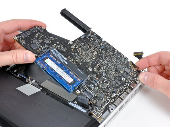

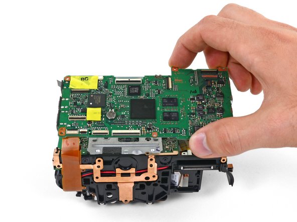

    9. Identifying Major Electronic Components, Motherboard: crwdns2935265:09crwdnd2935265:01crwdnd2935265:03crwdne2935265:0 Identifying Major Electronic Components, Motherboard: crwdns2935265:09crwdnd2935265:02crwdnd2935265:03crwdne2935265:0 Identifying Major Electronic Components, Motherboard: crwdns2935265:09crwdnd2935265:03crwdnd2935265:03crwdne2935265:0
      • The motherboard is like the nervous system of your device. Without a motherboard, your device is just a useless hunk of electronics!
      • Motherboards are generally very easy to identify, because they're one of the largest components in your device. Many of the other components inside your device connect to the motherboard.
      • "Motherboard" is a generic name for the largest circuit board in a device. Apple calls their motherboards "Logic boards." This is brand-specific nomenclature. So unless you have an Apple device, you are working with a "motherboard."

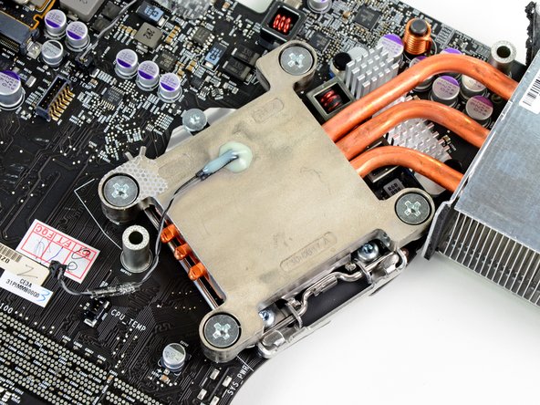

    10. Identifying Major Electronic Components, Heatsink: crwdns2935265:010crwdnd2935265:01crwdnd2935265:03crwdne2935265:0 Identifying Major Electronic Components, Heatsink: crwdns2935265:010crwdnd2935265:02crwdnd2935265:03crwdne2935265:0 Identifying Major Electronic Components, Heatsink: crwdns2935265:010crwdnd2935265:03crwdnd2935265:03crwdne2935265:0
      • Heatsinks keep CPUs cool by dissipating the heat into the surrounding environment.
      • To identify the heatsink, look for metal fins and copper piping that help pull heat away from the CPU.
      • When removing the heatsink, it's always good to apply a new layer of thermal paste, as it helps the heatsink pull heat away from the CPU.

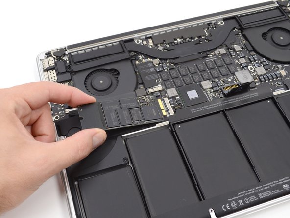

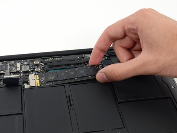

    13. Identifying Major Electronic Components, Hard Drive/Solid-State Drive: crwdns2935265:013crwdnd2935265:01crwdnd2935265:03crwdne2935265:0 Identifying Major Electronic Components, Hard Drive/Solid-State Drive: crwdns2935265:013crwdnd2935265:02crwdnd2935265:03crwdne2935265:0 Identifying Major Electronic Components, Hard Drive/Solid-State Drive: crwdns2935265:013crwdnd2935265:03crwdnd2935265:03crwdne2935265:0
      • Hard drives and solid-state drives allow for the storage of documents/pictures/etc. on a device, and are commonly found in laptops and desktop computers.
      • They are generally rectangular and covered in markings that denote how big they are (500 GB, etc).
      • Additionally, both types can vary greatly in size and shape. For example, some solid-state drives have no casing, leaving the memory chips exposed.

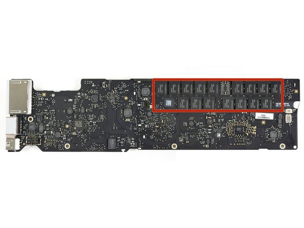

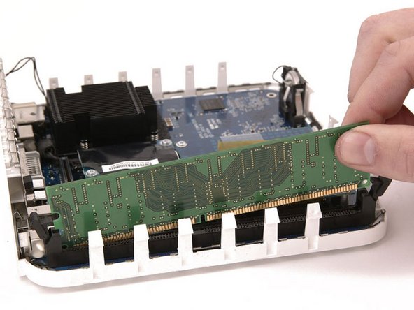

    14. Identifying Major Electronic Components, RAM: crwdns2935265:014crwdnd2935265:01crwdnd2935265:03crwdne2935265:0 Identifying Major Electronic Components, RAM: crwdns2935265:014crwdnd2935265:02crwdnd2935265:03crwdne2935265:0 Identifying Major Electronic Components, RAM: crwdns2935265:014crwdnd2935265:03crwdnd2935265:03crwdne2935265:0
      • RAM (Random access memory) can be found in almost all modern devices and generally looks like a stick with a large amount of memory chips covering it. RAM is like a sort of "temporary" memory for your device, where commonly accessed data is stored for quicker retrieval.
      • Some devices, such as phones and ultra-thin laptops have non-removable RAM. Don't try to remove this RAM from the device, as it is soldered into the motherboard.

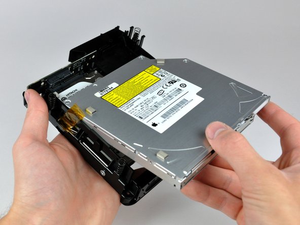

    15. Identifying Major Electronic Components, Optical Drive: crwdns2935265:015crwdnd2935265:01crwdnd2935265:03crwdne2935265:0 Identifying Major Electronic Components, Optical Drive: crwdns2935265:015crwdnd2935265:02crwdnd2935265:03crwdne2935265:0 Identifying Major Electronic Components, Optical Drive: crwdns2935265:015crwdnd2935265:03crwdnd2935265:03crwdne2935265:0
      • Many laptops feature optical drives, which allow the device to read CDs and DVDs.
      • To identify the optical drive, look for a large square component that has a slot or bay for a disc to be inserted into.

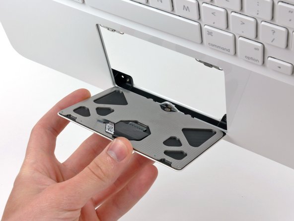

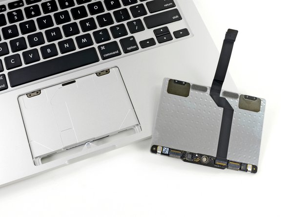

    16. Identifying Major Electronic Components, Touchpad: crwdns2935265:016crwdnd2935265:01crwdnd2935265:03crwdne2935265:0 Identifying Major Electronic Components, Touchpad: crwdns2935265:016crwdnd2935265:02crwdnd2935265:03crwdne2935265:0 Identifying Major Electronic Components, Touchpad: crwdns2935265:016crwdnd2935265:03crwdnd2935265:03crwdne2935265:0
      • Touchpads (or trackpads) are found on all laptops, and allow the user to interact with their device using only their fingers.
      • To identify the touchpad on your device, look for the large square surface that you use to move the cursor around the screen.

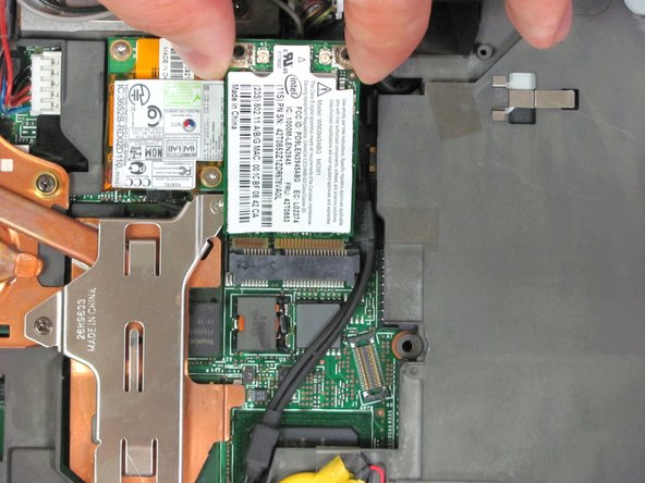

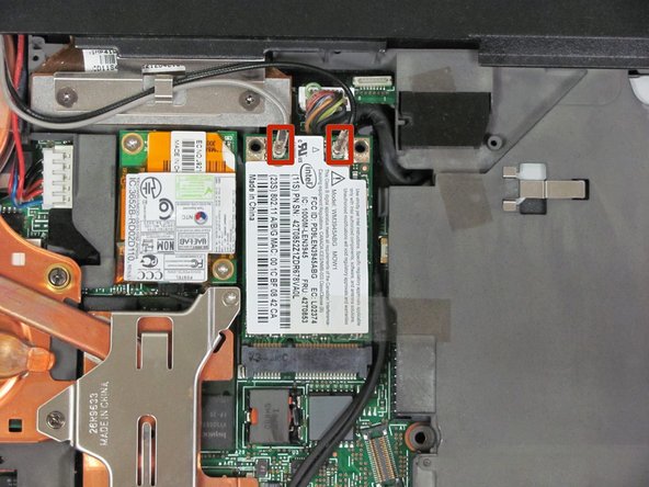

    17. Identifying Major Electronic Components, Wireless Card: crwdns2935265:017crwdnd2935265:01crwdnd2935265:03crwdne2935265:0 Identifying Major Electronic Components, Wireless Card: crwdns2935265:017crwdnd2935265:02crwdnd2935265:03crwdne2935265:0 Identifying Major Electronic Components, Wireless Card: crwdns2935265:017crwdnd2935265:03crwdnd2935265:03crwdne2935265:0
      • The wireless card is a small circuit board which provides wireless connectivity to your laptop.
      • It can generally be identified by two white and black antenna wires that connect to it.

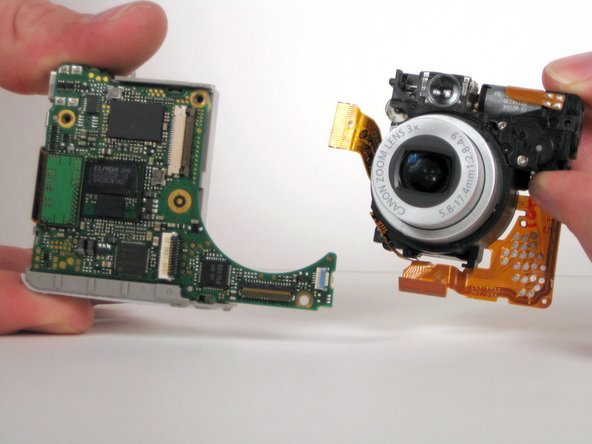

    18. Identifying Major Electronic Components, Lens Assembly: crwdns2935265:018crwdnd2935265:01crwdnd2935265:03crwdne2935265:0 Identifying Major Electronic Components, Lens Assembly: crwdns2935265:018crwdnd2935265:02crwdnd2935265:03crwdne2935265:0 Identifying Major Electronic Components, Lens Assembly: crwdns2935265:018crwdnd2935265:03crwdnd2935265:03crwdne2935265:0
      • The lens assembly of a camera houses the shutter and lens which allows your camera to take photos.
      • The lens assembly is generally one of the largest components of a camera, and can be identified by a large ring that surrounds the shutter.
      • On most cameras, the lens assembly is one of the last components that can be removed. Be patient when removing it, because it is fragile.

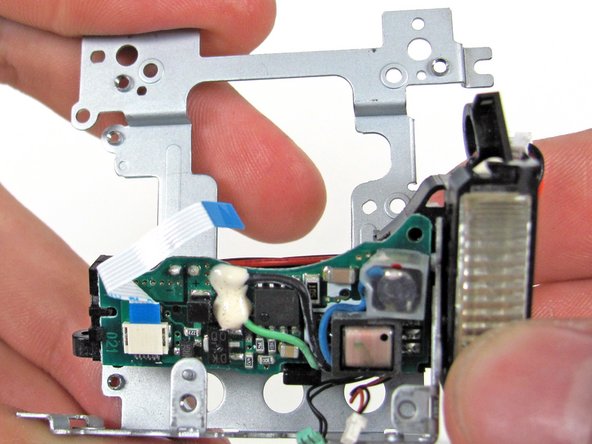

    19. Identifying Major Electronic Components, Flash Assembly: crwdns2935265:019crwdnd2935265:01crwdnd2935265:03crwdne2935265:0 Identifying Major Electronic Components, Flash Assembly: crwdns2935265:019crwdnd2935265:02crwdnd2935265:03crwdne2935265:0 Identifying Major Electronic Components, Flash Assembly: crwdns2935265:019crwdnd2935265:03crwdnd2935265:03crwdne2935265:0
      • The flash assembly of a camera provides a quick burst of light when taking a photo that can brighten up otherwise dark environments.
      • To identify the flash assembly, look for a small board that attaches to the rectangular light on the front of the device.
      • When handling the flash assembly, make sure you have removed the battery from the camera. Most flash assemblies have capacitors, which can shock you if you touch the leads. It's also a good idea to make sure the capacitor has been discharged before handling it.

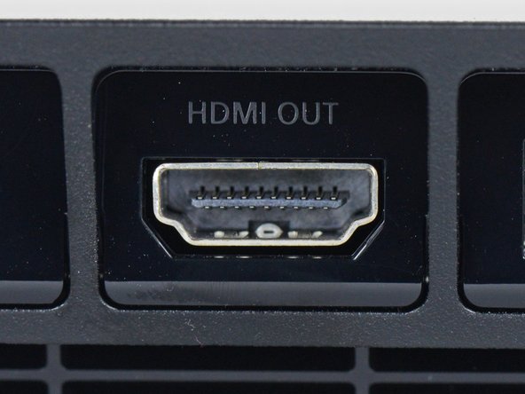

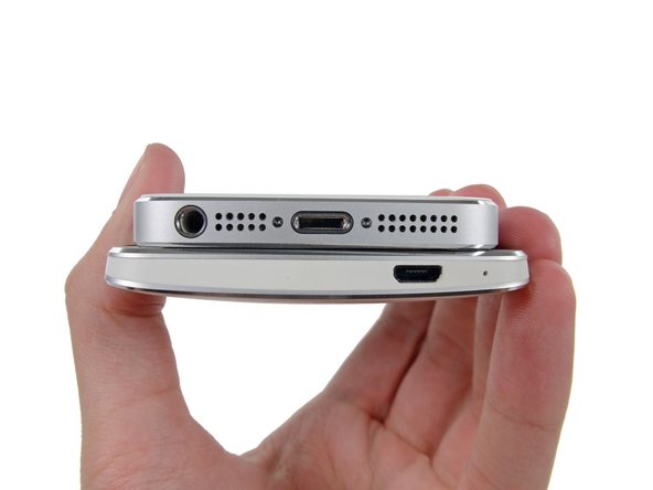

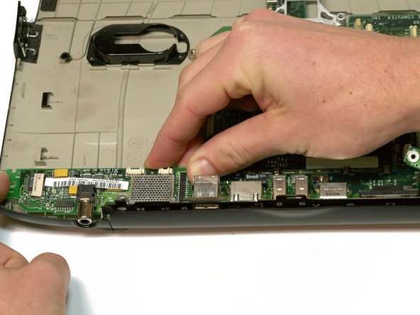

    20. Identifying Major Electronic Components, Ports: crwdns2935265:020crwdnd2935265:01crwdnd2935265:03crwdne2935265:0 Identifying Major Electronic Components, Ports: crwdns2935265:020crwdnd2935265:02crwdnd2935265:03crwdne2935265:0 Identifying Major Electronic Components, Ports: crwdns2935265:020crwdnd2935265:03crwdnd2935265:03crwdne2935265:0
      • Audio/Video(A/V) ports are commonly found on most cameras, and allow for content on your camera to be displayed on a television or monitor. They can be identified by their circular shape, and are often found near the power and memory card ports.
      • Charging ports are found on almost all portable devices, and come in a variety of shapes and sizes. The two most common types are USB type C and Apple's Lightning connector.
      • Video ports, like A/V ports, are found on many devices and allow for content on your device to be displayed on a television or monitor. The most common types are HDMI, VGA, and Apple's Thunderbolt.
      • Data ports are mainly used for transferring data between devices or networks. Common types include Ethernet ports and USB (universal serial bus) ports.

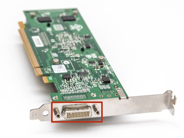

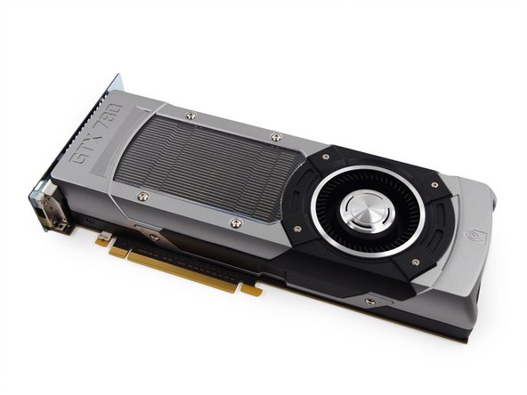

    21. Identifying Major Electronic Components, Graphics Card: crwdns2935265:021crwdnd2935265:01crwdnd2935265:03crwdne2935265:0 Identifying Major Electronic Components, Graphics Card: crwdns2935265:021crwdnd2935265:02crwdnd2935265:03crwdne2935265:0 Identifying Major Electronic Components, Graphics Card: crwdns2935265:021crwdnd2935265:03crwdnd2935265:03crwdne2935265:0
      • Many higher-end desktop computers feature a dedicated graphics card which displays the visuals on the monitor.
      • Graphics cards can generally be identified by their long rectangular shape, and are usually plugged into a PCI (Peripheral Component Interconnect) slot on the motherboard.
      • To distinguish a graphics card from other PCI slot components (Such as TV tuner cards), look for some sort of video connector at the rear of it.

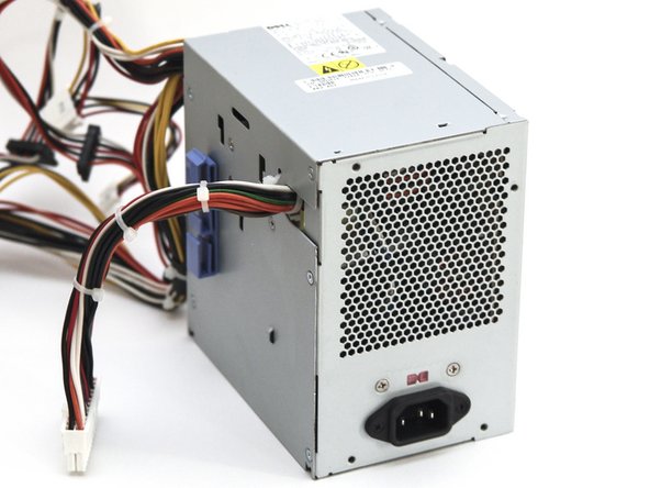

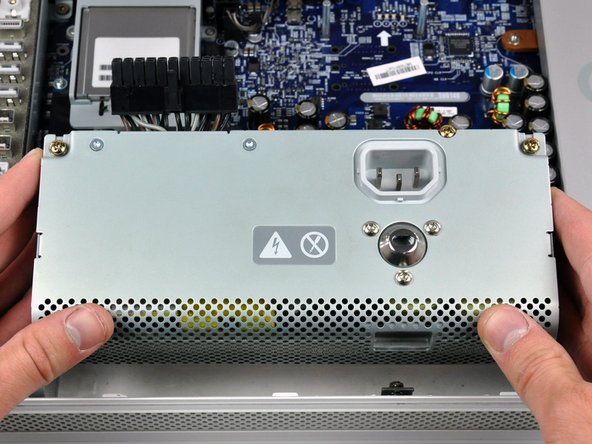

    23. Identifying Major Electronic Components, Power Supply: crwdns2935265:023crwdnd2935265:01crwdnd2935265:03crwdne2935265:0 Identifying Major Electronic Components, Power Supply: crwdns2935265:023crwdnd2935265:02crwdnd2935265:03crwdne2935265:0 Identifying Major Electronic Components, Power Supply: crwdns2935265:023crwdnd2935265:03crwdnd2935265:03crwdne2935265:0
      • Power supplies convert AC power from a wall socket, to DC power that your PC can use.
      • To identify a power supply, look for a large rectangular component that connects your PC to a wall socket.
      • Be careful when handling power supplies. Many contain large capacitors that can shock you if handled incorrectly.
