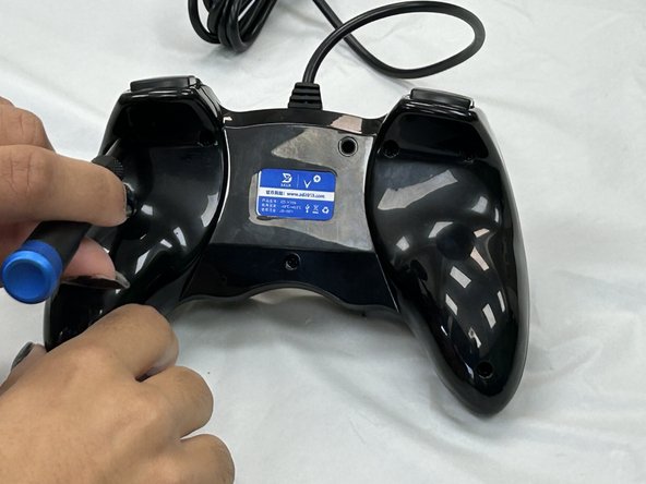

    • Remove the seven 9.2 mm screws from the back of the controller using a Phillips #00 screwdriver.
    • Remove the back cover.

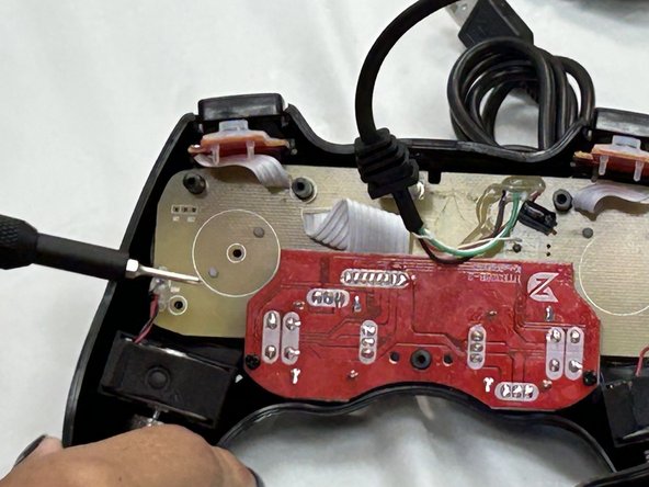

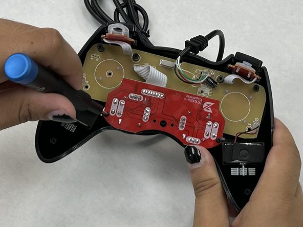

    • Remove the two 7.2 mm screws that connect the red daughterboard to the tan motherboard using a Phillips #00 screwdriver.

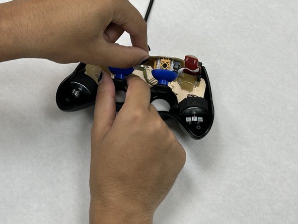

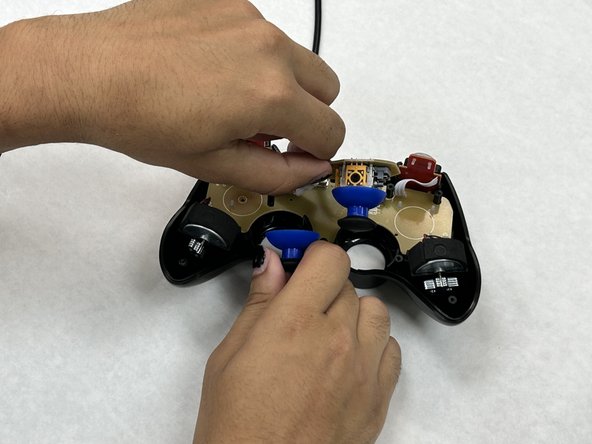

    • Gently flip up the daughterboard until the blue analog stick covers become visible.
    • Be cautious when flipping up the daughterboard as it is very fragile.
    • Gently pull on the analog stick covers until they pop off.
