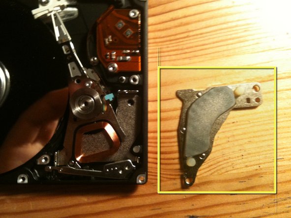

  5. IBM Travelstar DJSA-220 2.5'' Hard Drive Teardown, Let's attack the inside!: crwdns2935265:05crwdnd2935265:01crwdnd2935265:02crwdne2935265:0 IBM Travelstar DJSA-220 2.5'' Hard Drive Teardown, Let's attack the inside!: crwdns2935265:05crwdnd2935265:02crwdnd2935265:02crwdne2935265:0
    • Let's attack the inside!
    • remove the two T6 screws.
    • This piece is a powerful magnet!
    • This is a PCB with a ribbon cable sticked on it
    • Remove the two T6 screws.
    • The screw is on the back, T6 too.
    • I was unable to remove that T8 screw that holds the platters. They keep turning with my screwdriver and i couldn't block it strong enough.

is there anything reusable from the parts aside from the magnets? can you help me figure it out where I could probably use them?
Sheena - crwdns2934203:0crwdne2934203:0
To be honest, not much. If the logic board is fine, you could keep it just in case a same model drive went bad on this side. The screws may be useful if you are dealing with small electronic devices. But for sure, the most interesting part is that strong magnet.
