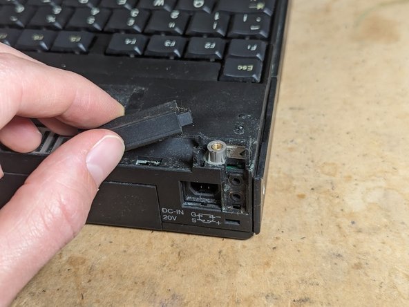

  2. IBM Thinkpad 700C Disassembly, LED Indicator Cover: crwdns2935265:02crwdnd2935265:01crwdnd2935265:03crwdne2935265:0 IBM Thinkpad 700C Disassembly, LED Indicator Cover: crwdns2935265:02crwdnd2935265:02crwdnd2935265:03crwdne2935265:0 IBM Thinkpad 700C Disassembly, LED Indicator Cover: crwdns2935265:02crwdnd2935265:03crwdnd2935265:03crwdne2935265:0
    • Open the laptop screen almost all the way.
    • Set the laptop on its side.
    • Using a spudger, unhook the LED cover's plastic tabs on the back of the laptop base.
    • The plastic is quite brittle and fragile. Be careful not to crack the tabs.
    • From the front of the laptop, pivot the LED indicator cover towards the keyboard and unhook the tabs on this side.

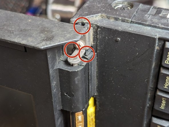

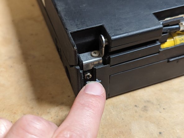

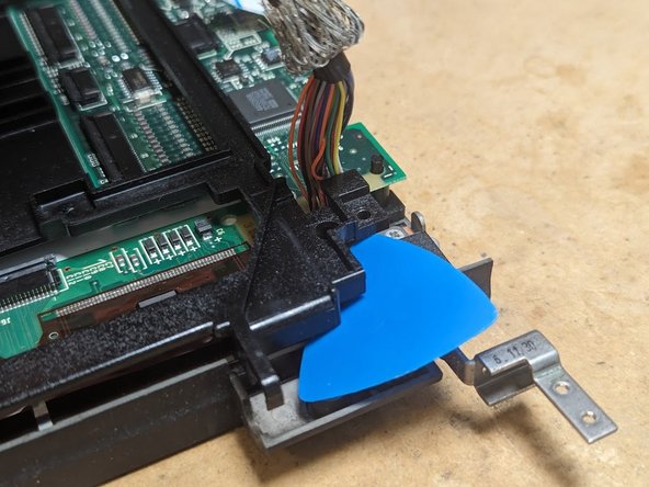

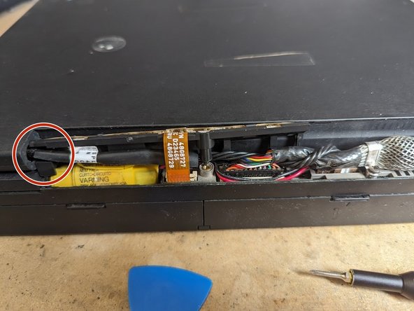

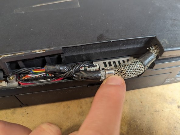

  3. IBM Thinkpad 700C Disassembly, Hinge Covers: crwdns2935265:03crwdnd2935265:01crwdnd2935265:02crwdne2935265:0 IBM Thinkpad 700C Disassembly, Hinge Covers: crwdns2935265:03crwdnd2935265:02crwdnd2935265:02crwdne2935265:0
    • Remove the hinge covers on each end of the laptop using a guitar pick and a spudger tool.
    • There are three plastic latches you are trying to release. They are circled in red.
    • You may need to adjust the spudger and guitar pick position to release all the latches.
    • Repeat for the hinge cover on the opposite side.
    • The hinge covers are not interchangeable. The bevel on the front faces the keyboard.

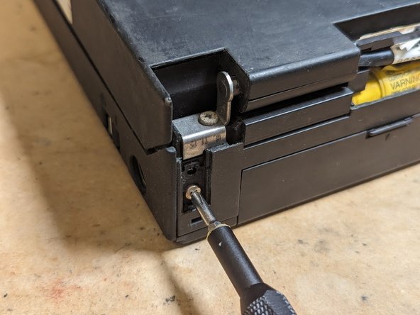

  4. IBM Thinkpad 700C Disassembly, Hinge Screws: crwdns2935265:04crwdnd2935265:01crwdnd2935265:03crwdne2935265:0 IBM Thinkpad 700C Disassembly, Hinge Screws: crwdns2935265:04crwdnd2935265:02crwdnd2935265:03crwdne2935265:0 IBM Thinkpad 700C Disassembly, Hinge Screws: crwdns2935265:04crwdnd2935265:03crwdnd2935265:03crwdne2935265:0
    • Gently close the laptop. Use guitar picks or something to prop the front of the screen so the two latches don't engage.
    • The hinges are stiff enough to crack the plastic! You may need to push on and support the rear of the laptop while closing it to prevent the hinges from cracking the rear plastics.
    • Using your fingernail or a spudger, remove the two screw covers from the top.
    • Remove the four 3mm screws on the rear surface of the laptop securing the LCD hinge.
    • Remove the two 5mm silver-colored screws holding the top of the hinge to the base of the laptop.
    • When reassembling the laptop, put the longer screws in before the shorter screws.

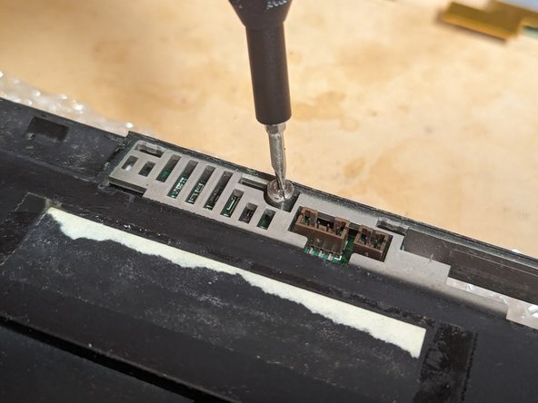

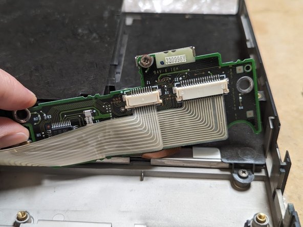

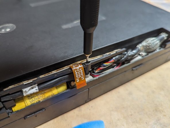

  5. IBM Thinkpad 700C Disassembly, LED Indicator Board: crwdns2935265:05crwdnd2935265:01crwdnd2935265:03crwdne2935265:0 IBM Thinkpad 700C Disassembly, LED Indicator Board: crwdns2935265:05crwdnd2935265:02crwdnd2935265:03crwdne2935265:0 IBM Thinkpad 700C Disassembly, LED Indicator Board: crwdns2935265:05crwdnd2935265:03crwdnd2935265:03crwdne2935265:0
    • Unlatch the flex connector with a guitar pick or your fingernail, then gently pull the flex cable free.
    • Using a small PH00 Phillips bit from your screwdriver kit, loosen the screw holding the LED assembly in place.
    • The screw can stay in the assembly. The thin PH00 bit can sneak past the LED circuit board so you don't need to remove it.
    • Pull the LED indicator board free, unhooking it from the 4-wire cable (LCD backlight power)

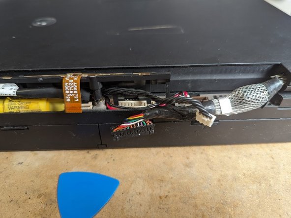

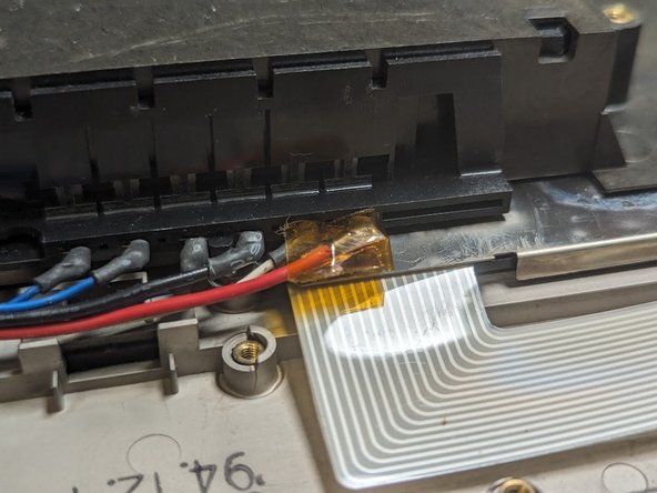

  6. IBM Thinkpad 700C Disassembly, Unplug the LCD Cables: crwdns2935265:06crwdnd2935265:01crwdnd2935265:03crwdne2935265:0 IBM Thinkpad 700C Disassembly, Unplug the LCD Cables: crwdns2935265:06crwdnd2935265:02crwdnd2935265:03crwdne2935265:0 IBM Thinkpad 700C Disassembly, Unplug the LCD Cables: crwdns2935265:06crwdnd2935265:03crwdnd2935265:03crwdne2935265:0
    • Remove the 3mm screw holding the LCD data cable bracket in place.
    • Note the cable routing carefully. During reassembly, the cables must follow the exact same paths in order to get everything to fit.
    • Unplug the 4-pin LCD backlight power cable and the multicolor LCD data cable using a spudger.

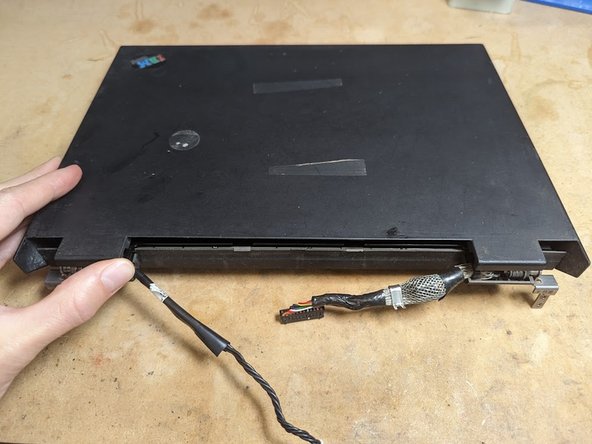

  7. IBM Thinkpad 700C Disassembly, LCD Panel Separation: crwdns2935265:07crwdnd2935265:01crwdnd2935265:02crwdne2935265:0 IBM Thinkpad 700C Disassembly, LCD Panel Separation: crwdns2935265:07crwdnd2935265:02crwdnd2935265:02crwdne2935265:0
    • Gently lift the laptop screen up, allowing the hinges to slide clear from the base, and set it aside.
    • Remove the two plastic hinge spacers resting on the laptop base.
    • The two hinge spacers are not interchangeable--be sure to note which one goes where.

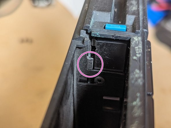

  8. IBM Thinkpad 700C Disassembly, LCD Panel Back Cover Removal: crwdns2935265:08crwdnd2935265:01crwdnd2935265:02crwdne2935265:0 IBM Thinkpad 700C Disassembly, LCD Panel Back Cover Removal: crwdns2935265:08crwdnd2935265:02crwdnd2935265:02crwdne2935265:0
    • Using a dental pick or small screwdriver, remove the two rubber plugs (blue circles)
    • With the dental pick or screwdriver, remove the two rubber disks (red circles) that cover up the screws.
    • Using a T6 Torx driver, remove the four 5mm screws formerly covered by the plugs and disks.
    • Flip the panel over face down, then lift up the back cover on the hinge side.
    • Slide the back cover forward to clear the lid latch hooks in the two front corners.
    • The cover should lift right off.

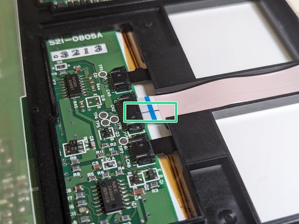

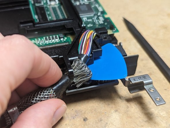

  9. IBM Thinkpad 700C Disassembly, Flex Cables: crwdns2935265:09crwdnd2935265:01crwdnd2935265:02crwdne2935265:0 IBM Thinkpad 700C Disassembly, Flex Cables: crwdns2935265:09crwdnd2935265:02crwdnd2935265:02crwdne2935265:0
    • Remove the long flex cable (red box)
    • Note the exact orientation--the horizontal metal stripe (see the green box) is offset and must be reinstalled exactly the same way
    • Be careful with the flex connector latches which are quite fragile. Slide them parallel to the cable using a fingernail or a guitar pick.
    • Remove the two 90 degree flex cables (orange boxes), again being sure to record their exact orientation and location.
    • During reinstallation of the 90 degree cables, it is easier to install them in the top and bottom circuit boards first.
    • Disconnect the flex cable on the far right (blue box).

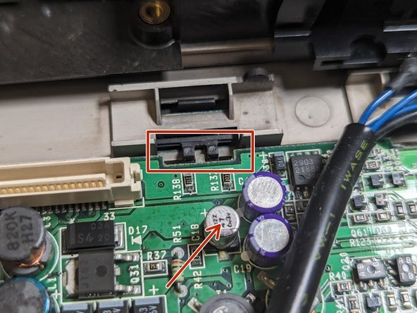

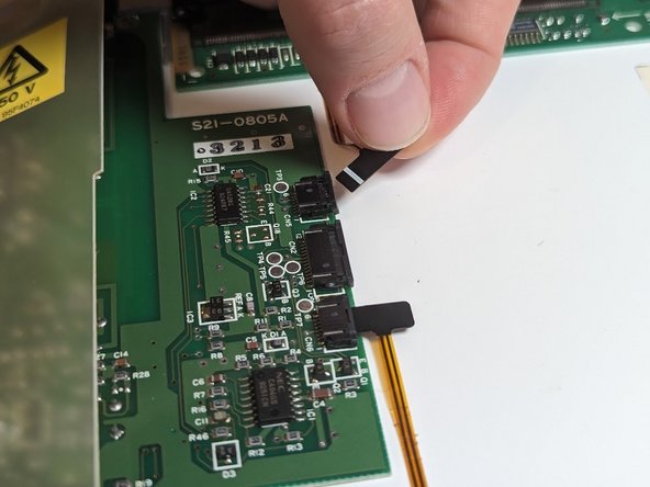

  11. IBM Thinkpad 700C Disassembly, LCD Backlight and LCD Driver Boards: crwdns2935265:011crwdnd2935265:01crwdnd2935265:03crwdne2935265:0 IBM Thinkpad 700C Disassembly, LCD Backlight and LCD Driver Boards: crwdns2935265:011crwdnd2935265:02crwdnd2935265:03crwdne2935265:0 IBM Thinkpad 700C Disassembly, LCD Backlight and LCD Driver Boards: crwdns2935265:011crwdnd2935265:03crwdnd2935265:03crwdne2935265:0
    • Remove the four 6mm self-tapping screws securing both circuit boards.
    • Lift up and remove the LCD driver board (right).
    • Unplug the two small flex cables from the backlight board, being sure to properly unlatch the connectors first.
    • Flip the backlight power board over to the left, exposing the CCFL high voltage wires.
    • Disconnect the two CCFL high voltage wires.
    • The CCFL connectors can be challenging to remove. Try using a spudger to pry the connector+tiny board upwards while using your finger to pull sideways on the connector to disengage the latching tabs.
    • When replacing the backlight power board, be sure the two slider potentiometers engage with the plastic sliders on the front of the case.

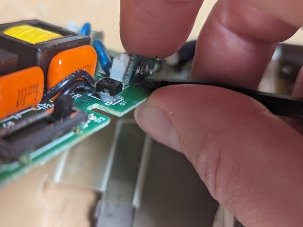

  12. IBM Thinkpad 700C Disassembly, CCFL Board Capacitors: crwdns2935265:012crwdnd2935265:01crwdnd2935265:01crwdne2935265:0
    • While you have the CCFL board out, you will likely want to replace the leaky electrolytic capacitors.
    • C1: 220uF 35V radial leaded electrolytic, 10mm tall, 10.1mm dia. lead spacing 5mm. Mouser p/n: 581-REF1009221M035K
    • C2: 4.7uF 25V radial leaded electrolytic, 5.7mm tall, 4.1mm dia lead spacing 2mm. Mouser p/n: 667-ECE-A1EKS4R7I
    • C3: 33uF 6.3V radial leaded electrolytic, 5.7mm tall, 5.1mm dia lead spacing 2.5mm. Mouser p/n: 667-ECE-A1CKS330

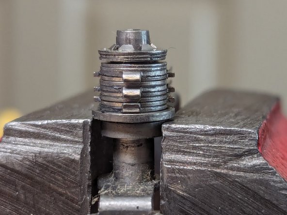

  14. IBM Thinkpad 700C Disassembly, Hinges: crwdns2935265:014crwdnd2935265:01crwdnd2935265:02crwdne2935265:0 IBM Thinkpad 700C Disassembly, Hinges: crwdns2935265:014crwdnd2935265:02crwdnd2935265:02crwdne2935265:0
    • Take out the two 8mm screws fastening the hinges in place.
    • Remove the hinges. They are not identical so keep track of which is which.
    • Quick hinge stiffness fix:
    • Place the hinge in a vise but do not tighten it down.
    • Rest the hinge on the bottom sheet metal without gripping the metal pin. The locking washer should be facing upwards.
    • Tap the top of the metal pin with a hammer to loosen up the hinge action.
    • If you loosen the hinge too much, take it out of the vise and place it on top of the vise. put a small hex driver over the top and tap it with a hammer to drive the locking washer back down.

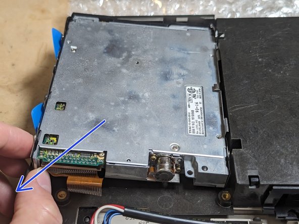

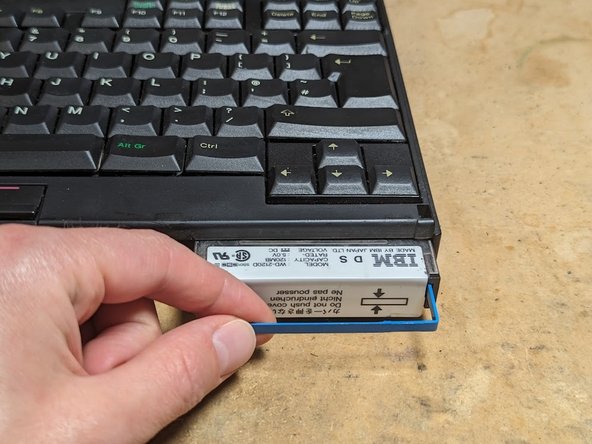

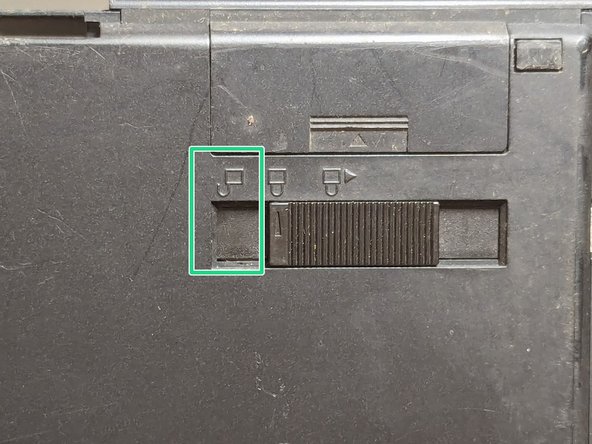

  16. IBM Thinkpad 700C Disassembly, Battery and Hard Drive: crwdns2935265:016crwdnd2935265:01crwdnd2935265:03crwdne2935265:0 IBM Thinkpad 700C Disassembly, Battery and Hard Drive: crwdns2935265:016crwdnd2935265:02crwdnd2935265:03crwdne2935265:0 IBM Thinkpad 700C Disassembly, Battery and Hard Drive: crwdns2935265:016crwdnd2935265:03crwdnd2935265:03crwdne2935265:0
    • Remove the battery by sliding the battery faceplate down then pulling the battery forward, out of the unit.
    • Set the hard drive cover switch to the unlocked position
    • Slide the hard drive cover forward, away from the unit.
    • With a fingernail, snag the blue bar on the front of the hard drive. Pull on it and the hard drive should disconnect and slide free.

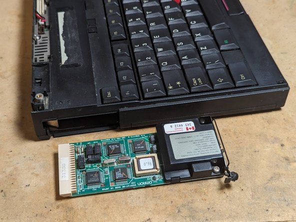

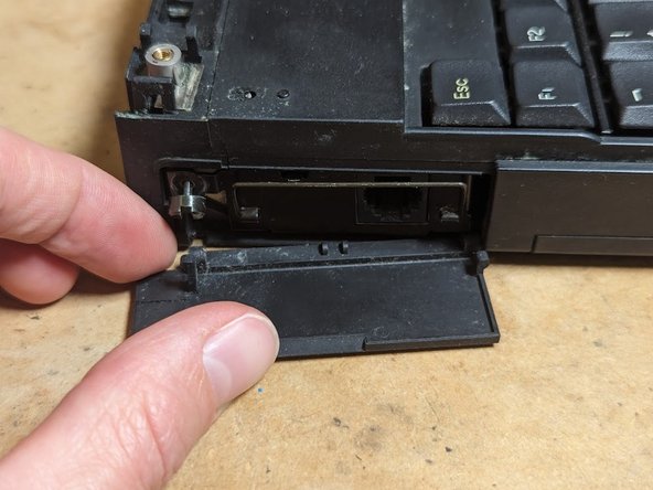

  17. IBM Thinkpad 700C Disassembly, Modem: crwdns2935265:017crwdnd2935265:01crwdnd2935265:03crwdne2935265:0 IBM Thinkpad 700C Disassembly, Modem: crwdns2935265:017crwdnd2935265:02crwdnd2935265:03crwdne2935265:0 IBM Thinkpad 700C Disassembly, Modem: crwdns2935265:017crwdnd2935265:03crwdnd2935265:03crwdne2935265:0
    • Tilt the modem cover down.
    • Loosen the screw holding the modem in place with a flat screwdriver. It is a captive screw so it will not come out all the way.
    • Remove the modem cover by pulling forward from the left edge, and then pull it to the left to disengage it from the right hinge pin.
    • Snag the pull handle (wire) with a fingernail and pull the modem free of the unit.

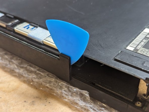

  19. IBM Thinkpad 700C Disassembly, Memory Cover: crwdns2935265:019crwdnd2935265:01crwdnd2935265:01crwdne2935265:0
    • Flip the laptop over and place it on several layers of bubble wrap to protect the fragile plastic hooks that retain the LED indicator cover and hinge covers.
    • The LED indicator cover and hinge cover plastic hooks are incredibly fragile.
    • Remove the memory cover by pushing it down and to the left.
    • You may need to use a guitar pick to give it a little encouragement.

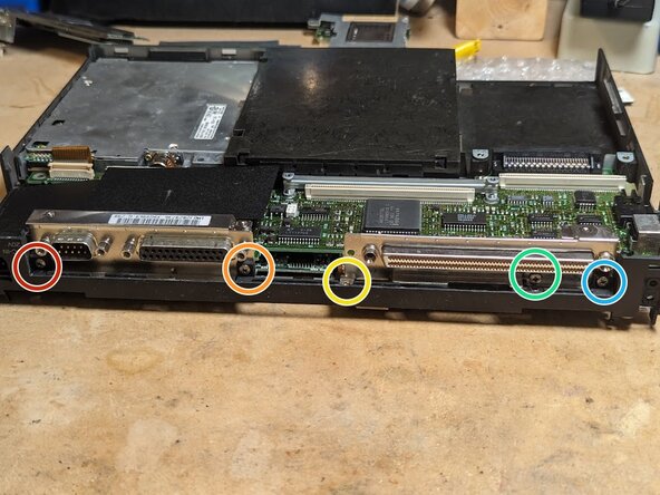

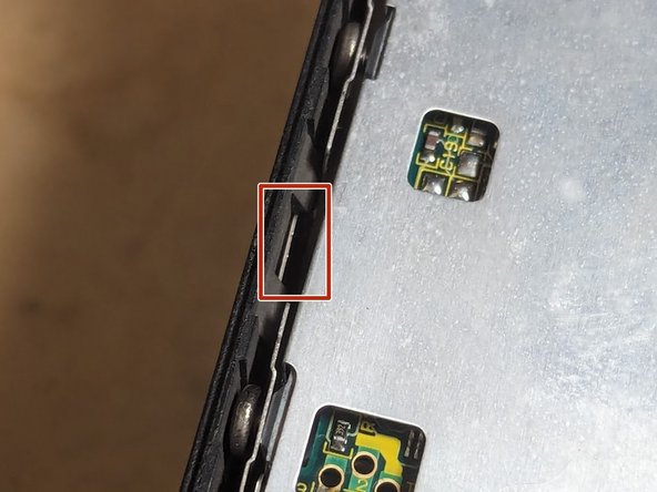

  20. IBM Thinkpad 700C Disassembly, Rear Cover: crwdns2935265:020crwdnd2935265:01crwdnd2935265:03crwdne2935265:0 IBM Thinkpad 700C Disassembly, Rear Cover: crwdns2935265:020crwdnd2935265:02crwdnd2935265:03crwdne2935265:0 IBM Thinkpad 700C Disassembly, Rear Cover: crwdns2935265:020crwdnd2935265:03crwdnd2935265:03crwdne2935265:0
    • Remove three black 4mm screws.
    • Use guitar picks to dislodge 5 plastic latches around the perimeter (arrows)
    • There are two hidden plastic latches (arrows), one inside the hard drive slot, and the other between the floppy drive and the battery slot.
    • You may need to use a combination of a guitar pick and a spudger to dislodge the latch in the battery slot.
    • This step requires patience, sometimes latches can reconnect themselves, so you may want to leave the guitar picks in place until the cover is completely free.
    • Remove the cover and set it aside.

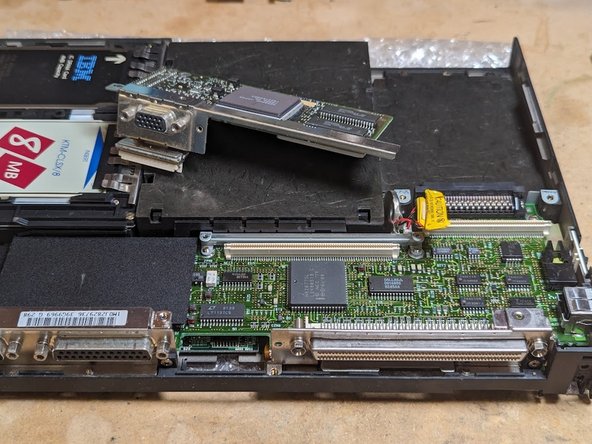

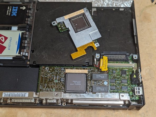

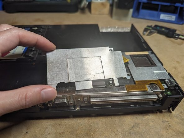

  21. IBM Thinkpad 700C Disassembly, Video Card Shield: crwdns2935265:021crwdnd2935265:01crwdnd2935265:02crwdne2935265:0 IBM Thinkpad 700C Disassembly, Video Card Shield: crwdns2935265:021crwdnd2935265:02crwdnd2935265:02crwdne2935265:0
    • Remove two silver 5mm screws from the upper part of the video card shield.
    • Tilt the shield forward and slide it backwards to remove it.

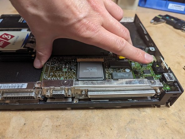

  22. IBM Thinkpad 700C Disassembly, CPU Card Assembly: crwdns2935265:022crwdnd2935265:01crwdnd2935265:03crwdne2935265:0 IBM Thinkpad 700C Disassembly, CPU Card Assembly: crwdns2935265:022crwdnd2935265:02crwdnd2935265:03crwdne2935265:0 IBM Thinkpad 700C Disassembly, CPU Card Assembly: crwdns2935265:022crwdnd2935265:03crwdnd2935265:03crwdne2935265:0
    • Remove two silver 5mm screws from the CPU card.
    • Use a guitar pick to help pry the CPU card up and out of its connector, which is directly beneath the area with the screws.

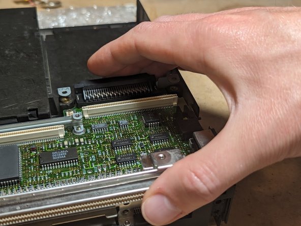

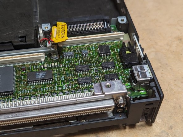

  23. IBM Thinkpad 700C Disassembly, Video Board: crwdns2935265:023crwdnd2935265:01crwdnd2935265:03crwdne2935265:0 IBM Thinkpad 700C Disassembly, Video Board: crwdns2935265:023crwdnd2935265:02crwdnd2935265:03crwdne2935265:0 IBM Thinkpad 700C Disassembly, Video Board: crwdns2935265:023crwdnd2935265:03crwdnd2935265:03crwdne2935265:0
    • Remove the black 4mm screw above the parallel port.
    • Remove the silver 4mm screw from between the docking port and the VGA connector.
    • Pull straight up from the top left and right of the video card to unplug it from the planar (motherboard).

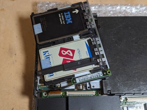

  24. IBM Thinkpad 700C Disassembly, Memory Board: crwdns2935265:024crwdnd2935265:01crwdnd2935265:02crwdne2935265:0 IBM Thinkpad 700C Disassembly, Memory Board: crwdns2935265:024crwdnd2935265:02crwdnd2935265:02crwdne2935265:0
    • Remove the two 16mm screws from the memory card.
    • The plastic modem guide rail comes off with the two screws as well
    • Unplug the memory board from the planar and lift it away.

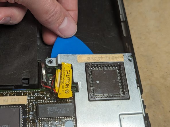

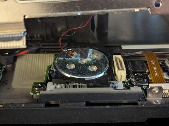

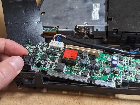

  25. IBM Thinkpad 700C Disassembly, PS/2 Mouse Shield, Power Button, Coin Cell: crwdns2935265:025crwdnd2935265:01crwdnd2935265:02crwdne2935265:0 IBM Thinkpad 700C Disassembly, PS/2 Mouse Shield, Power Button, Coin Cell: crwdns2935265:025crwdnd2935265:02crwdnd2935265:02crwdne2935265:0
    • Push in on the plastic piece on the outside of the case next to the PS/2 mouse connector.
    • While maintaining pressure, slide the plastic part up to release the plastic latches. The part should come away.
    • Gently pull off the metal connector shield.
    • Lift the power switch slider up and away from the case.
    • Remove the coin cell using a spudger on its connector.
  26. IBM Thinkpad 700C Disassembly, Planar Fasteners: crwdns2935265:026crwdnd2935265:01crwdnd2935265:03crwdne2935265:0 IBM Thinkpad 700C Disassembly, Planar Fasteners: crwdns2935265:026crwdnd2935265:02crwdnd2935265:03crwdne2935265:0 IBM Thinkpad 700C Disassembly, Planar Fasteners: crwdns2935265:026crwdnd2935265:03crwdnd2935265:03crwdne2935265:0
    • Unlatch the floppy drive flex cable using a spudger.
    • Flip the laptop over and remove the slotted standoff next to the 4-pin LCD backlight power connector
    • Flip the laptop back over and remove the five screws holding the planar to the case. They are not all the same!
    • Nearest the power jack: 4mm black screw
    • Next to the parallel port: 3mm black screw
    • Right side of docking connector: 5mm silver screw
    • Above docking connector: 4mm black screw
    • Left of docking connector: 3mm black screw
  27. IBM Thinkpad 700C Disassembly, Planar: crwdns2935265:027crwdnd2935265:01crwdnd2935265:03crwdne2935265:0 IBM Thinkpad 700C Disassembly, Planar: crwdns2935265:027crwdnd2935265:02crwdnd2935265:03crwdne2935265:0 IBM Thinkpad 700C Disassembly, Planar: crwdns2935265:027crwdnd2935265:03crwdnd2935265:03crwdne2935265:0
    • Hold the thin plastic modem cover out of the way and, with your fingers, gently pry up the left edge of the planar.
    • Gently pull up on the right side of the planar.
    • Remove the planar slowly so you can see how the PC speaker is sitting underneath. Only the planar holds it in place against the keyboard driver board. See the reference image for the orientation of the cable and position of the rubber speaker bracket.
  28. IBM Thinkpad 700C Disassembly, Power Board: crwdns2935265:028crwdnd2935265:01crwdnd2935265:03crwdne2935265:0 IBM Thinkpad 700C Disassembly, Power Board: crwdns2935265:028crwdnd2935265:02crwdnd2935265:03crwdne2935265:0 IBM Thinkpad 700C Disassembly, Power Board: crwdns2935265:028crwdnd2935265:03crwdnd2935265:03crwdne2935265:0
    • Unscrew the black 8mm screw holding the battery holder clip in place. Remove both the screw and the clip
    • Remove the two silver 5mm screws on either side of the AC adapter power jack cover.
    • Remove the AC adapter power jack cover itself.
    • Lift out the power board and unplug it from the battery connector.
    • When reinstalling the power board, ensure the volume slide switch engages with the prongs on the front panel switch actuator. (red box)
    • Capacitor C18 (47uF 6.3V, 5mm dia, 6mm height) nearly always leaks on the power board and must be replaced. It can also cause extensive damage, etching out vias and traces. See my reverse engineered power board if you want to attempt a repair.
  29. IBM Thinkpad 700C Disassembly, Keyboard and Trackpoint Controller: crwdns2935265:029crwdnd2935265:01crwdnd2935265:02crwdne2935265:0 IBM Thinkpad 700C Disassembly, Keyboard and Trackpoint Controller: crwdns2935265:029crwdnd2935265:02crwdnd2935265:02crwdne2935265:0
    • Remove the two black 3mm screws on the left and right sides of the board
    • Unplug the amber flex cable going to the trackpoint using a spudger.
    • Flip the board up and disconnect the two keyboard flex cables.

    • Insert two guitar picks into the metal latches on the left side of the floppy drive. They should go between the metal tab (red box) and the plastic case.
    • You may be able to use a spudger to help get the guitar picks in place.
    • Tilt up the left side of the floppy drive.
    • Pull the floppy drive diagonally to disengage the right side from the frame stiffener.
    • To reinstall the floppy drive, you may need to put a spudger halfway between the two guitar picks to get the sheet metal floppy bracket to clear a tab in the side of the plastic case.

    • Ensure the small piece of amber kapton tape remains attached to the battery wires.
