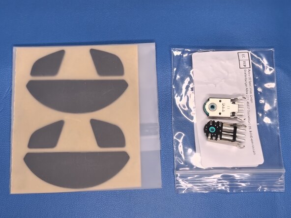

    • Soldering iron and soldering skills will be required.
    • Before starting with the repair, please note that you will require a rotary encoder for scroll wheel size 13mm.
    • Recommend purchasing a new set of mouse feet/skates.

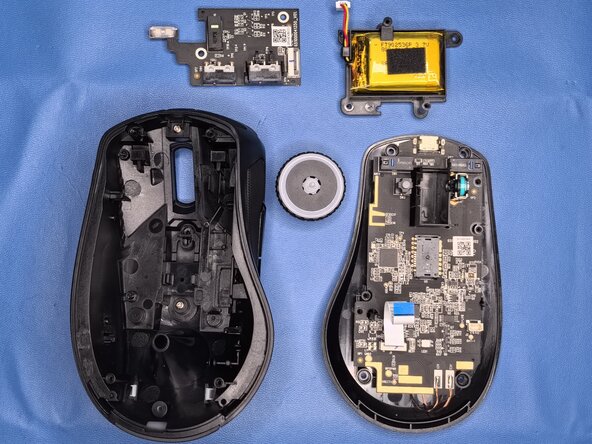

    • Since almost all components inside the mouse are screwed down to the bottom of the mouse, we will need to remove the top part.

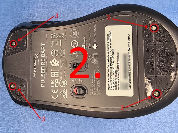

    • 1st. Let's put the mouse into an OFF position. [IMAGE 1]
    • 2nd. Let's remove mouse feet. There are three of them on the bottom part of the mouse as seen in the picture. If you haven't purchased replacement feet, I recommend that you peel the mouse feet to the side only where the screws are located so you don't lose adhesion so they don't fall off during use or use glue to reapply mouse feet. [IMAGE 1]
    • 3rd. We have to remove 4 screws as can be seen in the picture. Three screws are Philips 3 and one screw is Torx 6. [IMAGE 2]
    • After that, the top part of the mouse should pop right off with a little bit of force.

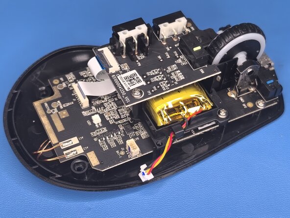

  3. Hyperx Pulsfire Dart - Wireless Gaming Mouse Rotary encoder/scroll wheel Replacement, Disconnecting battery: crwdns2935265:03crwdnd2935265:01crwdnd2935265:02crwdne2935265:0 Hyperx Pulsfire Dart - Wireless Gaming Mouse Rotary encoder/scroll wheel Replacement, Disconnecting battery: crwdns2935265:03crwdnd2935265:02crwdnd2935265:02crwdne2935265:0
    • Let's disconnect the battery by pulling on the connector as can be seen in the picture (the connector that we need to disconnect is more white then the part that's soldered to the PCB).
    • If the connector is not sliding out easily, move it from left to right and pull at the same time and it should pop right out.

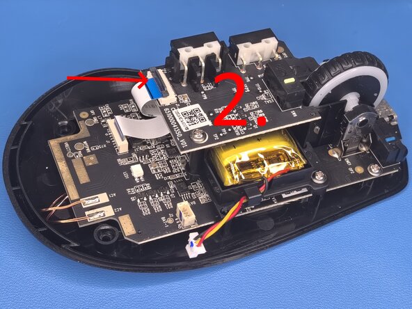

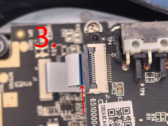

  4. Hyperx Pulsfire Dart - Wireless Gaming Mouse Rotary encoder/scroll wheel Replacement, Removing 1.st PCB - Part 1: crwdns2935265:04crwdnd2935265:01crwdnd2935265:03crwdne2935265:0 Hyperx Pulsfire Dart - Wireless Gaming Mouse Rotary encoder/scroll wheel Replacement, Removing 1.st PCB - Part 1: crwdns2935265:04crwdnd2935265:02crwdnd2935265:03crwdne2935265:0 Hyperx Pulsfire Dart - Wireless Gaming Mouse Rotary encoder/scroll wheel Replacement, Removing 1.st PCB - Part 1: crwdns2935265:04crwdnd2935265:03crwdnd2935265:03crwdne2935265:0
    • 1st. We have to lift the black lever. You can use a pry tool as can be seen in IMAGE 1
    • 2nd. Once the lever is lifted you can pull the cable out of the connector. [IMAGE 2]
    • When reassembling the device make sure you insert the cable all the way. [IMAGE 3]

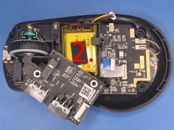

  5. Hyperx Pulsfire Dart - Wireless Gaming Mouse Rotary encoder/scroll wheel Replacement, Removing 1.st PCB - Part 2: crwdns2935265:05crwdnd2935265:01crwdnd2935265:02crwdne2935265:0 Hyperx Pulsfire Dart - Wireless Gaming Mouse Rotary encoder/scroll wheel Replacement, Removing 1.st PCB - Part 2: crwdns2935265:05crwdnd2935265:02crwdnd2935265:02crwdne2935265:0
    • First, let's remove two Philips 1 screws as can be seen in the IMAGE 1.
    • Then you will have to lift the PCB for a few milimiters, and then you have to rotate the PCB for approximately 45° to slide the board out of the scroll wheel as shown in IMAGE 2.

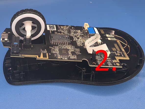

    • To remove the scroll wheel, we have to first unscrew the main PCB.
    • The main PCB is held down by two Philips 1 screws. [IMAGE 1]
    • Once you have removed the two screws, lift the pcb in the front part where the charging port is located. [IMAGE 1]
    • Lift the pcb for at leats 3cm then pull the scroll wheel to the left and then straight up. [IMAGE 2]
    • Try not to damage the two wires that are at the back of the PCB connected to the wireless charging pad. For the repair that we are doing, removal of it is not required.

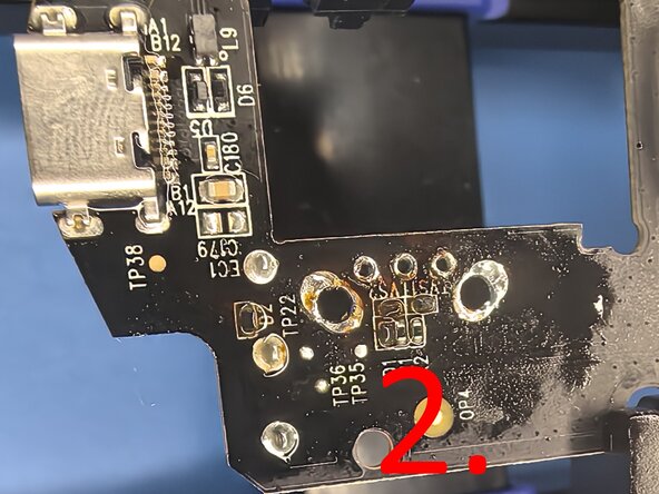

  8. Hyperx Pulsfire Dart - Wireless Gaming Mouse Rotary encoder/scroll wheel Replacement, Desoldering rotary encoder: crwdns2935265:08crwdnd2935265:01crwdnd2935265:02crwdne2935265:0 Hyperx Pulsfire Dart - Wireless Gaming Mouse Rotary encoder/scroll wheel Replacement, Desoldering rotary encoder: crwdns2935265:08crwdnd2935265:02crwdnd2935265:02crwdne2935265:0
    • Now we have to desolder the scroll wheel rotary encoder (Mouse roller wheel Encoder).
    • Put your pcb into pcb holder or use helping hands. If you don't have any of these, use something to lift it away from plastic or any material that can be melted or ignited.
    • You can use a soldering iron or heat gun to desolder the rotary encoder. My preferred method is using soldering iron, so that's what i did.
    • The rotary encoder is held in with 5 pins. You have to desolder all 5 pins, apply flux around all 5 pins and use desoldering braid with soldering iron to remove solder from pins. [IMAGE 1]
    • If you have problem with melting solder, add new fresh solder to make it easier to melt. If your soldering skills are not great, you can use pliers to cut off pins of the rotary encoder and remove each pin by itself. Make sure that you have removed solder from all holes otherwise the new rotary encoder will not fit in. [IMAGE 2]
    • My preferred soldering iron temperature is 360°C, but you can use whatever temperature works for you. If you are using a flux that has to be cleaned off, I recommend that you use isopropanol. Since I'm using no clean flux, I don't have to do that.
  9. Hyperx Pulsfire Dart - Wireless Gaming Mouse Rotary encoder/scroll wheel Replacement, Soldering in new rotary encoder: crwdns2935265:09crwdnd2935265:01crwdnd2935265:01crwdne2935265:0
    • Rotary encoders side pins are bent, so you will have to apply some pressure for them to snap into place. Please do not try to straighten the pins, they are bent for a reason!
    • Make sure that you position your new rotary encoder straight so you don't run into any problems later.
    • ​When adding solder to the pins, please apply enough solder to cover the whole hole. Add flux for solder to stick only to designated spots.
