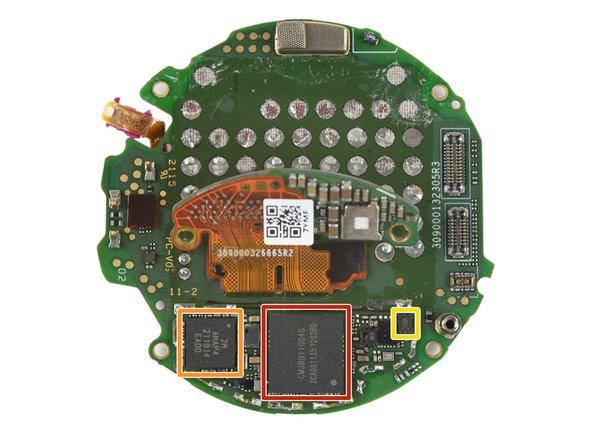

    • The motherboard finally grants us a break from prying—a Phillips driver is all we need to free this board.
    • Motherboard out of the way, we turn to the 1.43-inch AMOLED screen and it's back to adhesive. That display is firmly adhered.
    • And is it just us, or is that ambient light sensor waving at us... mockingly?
    • Since this watch is already in its third generation with a variety of offshoots, we'd hope for a more repair-friendly solution by now. Maybe Huawei could take a page from Samsung's Galaxy Watch book?
  8. Huawei Watch 3 Teardown: crwdns2935265:08crwdnd2935265:01crwdnd2935265:03crwdne2935265:0 Huawei Watch 3 Teardown: crwdns2935265:08crwdnd2935265:02crwdnd2935265:03crwdne2935265:0 Huawei Watch 3 Teardown: crwdns2935265:08crwdnd2935265:03crwdnd2935265:03crwdne2935265:0
    • With the motherboard out, we find the bottom of it rather… unspectacular at first sight. A big battery recess and all of the cable connectors set up camp here, but deeper down we spot some hidden chips:
    • CMJRD11G04G 16 GB NAND flash storage (likely) layered above maybe a WiFi processor
    • Ambiq Micro AMAP42 Apollo4 SoC
    • Runic RS7222 USB 2.0 DPDT analog switch (likely)
    • We're not in the mood to camp here with them for long, so we hurry over to more important sightseeing. Onward!
