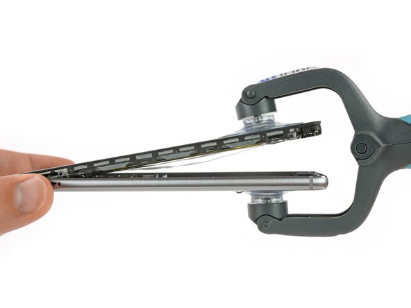

    3. Huawei P9 Plus Battery Replacement: crwdns2935265:03crwdnd2935265:01crwdnd2935265:02crwdne2935265:0 Huawei P9 Plus Battery Replacement: crwdns2935265:03crwdnd2935265:02crwdnd2935265:02crwdne2935265:0
      • Use an iSclack or a suction handle to separate the display unit from the rear case.
      • Do not fully separate the pieces as they are still connected by the fingerprint sensor cable.
