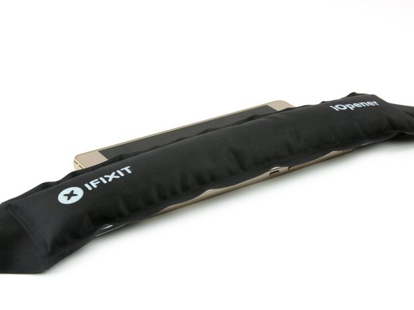

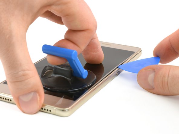

    • Flip the phone over and use an iOpener to soften the adhesive at the edge of the display.
  11. Huawei P9 Lite Display Replacement: crwdns2935265:011crwdnd2935265:01crwdnd2935265:03crwdne2935265:0 Huawei P9 Lite Display Replacement: crwdns2935265:011crwdnd2935265:02crwdnd2935265:03crwdne2935265:0 Huawei P9 Lite Display Replacement: crwdns2935265:011crwdnd2935265:03crwdnd2935265:03crwdne2935265:0
    • With a suction handle you can lift the display a little bit to create a gap.
    • Insert just the tip of an opening pick in the gap and steadily slide it along the edge towards the top. You may need to go back and forth a few times.
    • Try to get around the corner and behind the top part of the display. Re-position the suction handle if needed.
    • Leave the opening pick behind the display to avoid the re-sealing of the adhesive.

    • Heat up the iOpener once again and place it on the display to soften the adhesive at the top.

    • As long as the adhesive is warm try to continue to separate the display along the side towards the bottom. Re-heat the iOpener if necessary.
    • Don't overheat the iOpener. Stick to the iOpener instructions.
    • Also heat up the bottom part of the display for the next few steps.
