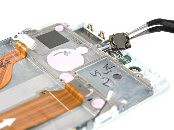

  11. Huawei P9 Display Assembly with Frame Replacement: crwdns2935265:011crwdnd2935265:01crwdnd2935265:02crwdne2935265:0 Huawei P9 Display Assembly with Frame Replacement: crwdns2935265:011crwdnd2935265:02crwdnd2935265:02crwdne2935265:0
    • Remove the motherboard assembly.
    • Remove the earpiece speaker (mind adhesive underneath).

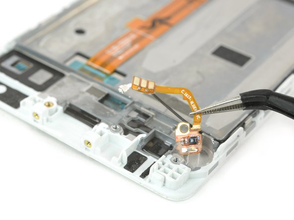

  12. Huawei P9 Display Assembly with Frame Replacement: crwdns2935265:012crwdnd2935265:01crwdnd2935265:02crwdne2935265:0 Huawei P9 Display Assembly with Frame Replacement: crwdns2935265:012crwdnd2935265:02crwdnd2935265:02crwdne2935265:0
    • Remove the proximity sensor module from its bracket.
    • If the new display unit does not have the rubber gasket of the proximity sensor already installed you have to transfer it from the old one.
    • Carefully peel off the motherboard flex cable.

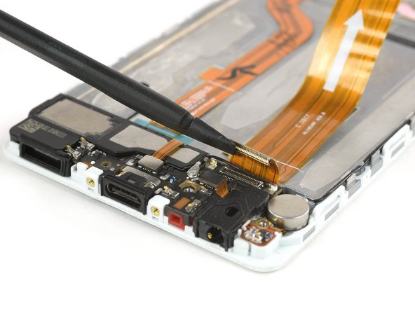

  13. Huawei P9 Display Assembly with Frame Replacement: crwdns2935265:013crwdnd2935265:01crwdnd2935265:03crwdne2935265:0 Huawei P9 Display Assembly with Frame Replacement: crwdns2935265:013crwdnd2935265:02crwdnd2935265:03crwdne2935265:0 Huawei P9 Display Assembly with Frame Replacement: crwdns2935265:013crwdnd2935265:03crwdnd2935265:03crwdne2935265:0

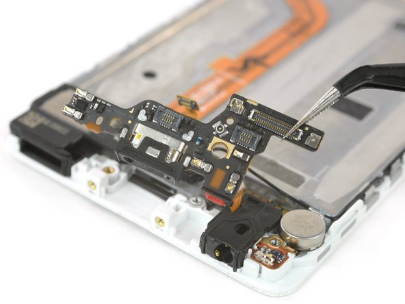

    • Remove the three Phillips #00 screws from the daughterboard.
    • Carefully remove the metal bracket. The headphone jack connector might stick to it.
    • Unplug the motherboard flex connector and put the cable aside.

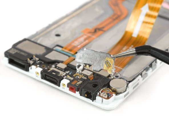

  14. Huawei P9 Display Assembly with Frame Replacement: crwdns2935265:014crwdnd2935265:01crwdnd2935265:02crwdne2935265:0 Huawei P9 Display Assembly with Frame Replacement: crwdns2935265:014crwdnd2935265:02crwdnd2935265:02crwdne2935265:0
    • Disconnect the headphone jack flex connector.
    • Unplug the antenna cable.

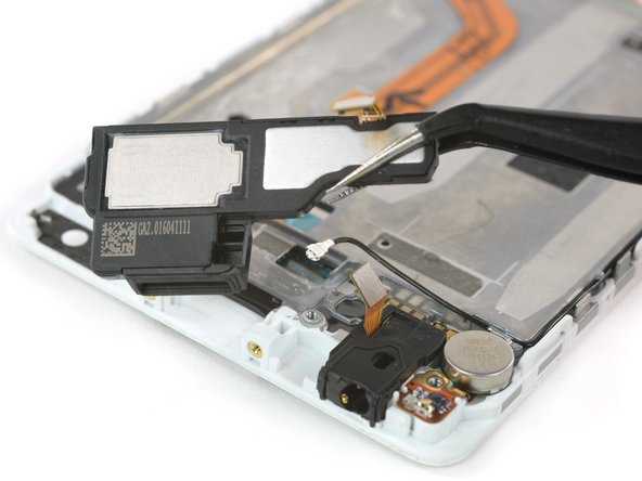

  15. Huawei P9 Display Assembly with Frame Replacement: crwdns2935265:015crwdnd2935265:01crwdnd2935265:03crwdne2935265:0 Huawei P9 Display Assembly with Frame Replacement: crwdns2935265:015crwdnd2935265:02crwdnd2935265:03crwdne2935265:0 Huawei P9 Display Assembly with Frame Replacement: crwdns2935265:015crwdnd2935265:03crwdnd2935265:03crwdne2935265:0
    • Unplug the connector of the loudspeaker.
    • Remove the daughterboard.
    • Pry the speaker off of the adhesive holding it to the display assembly.

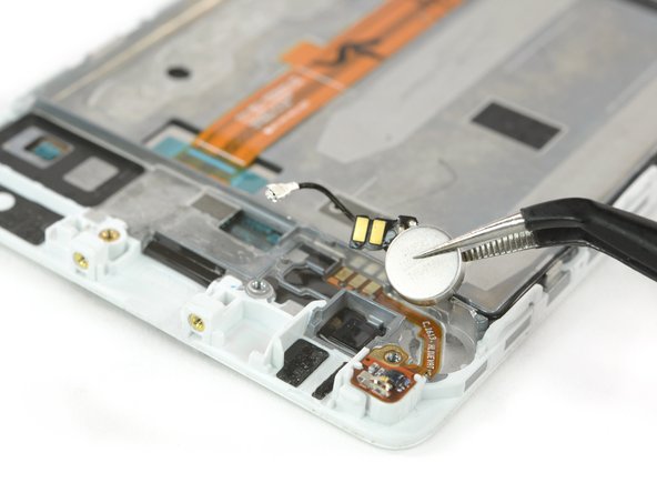

  16. Huawei P9 Display Assembly with Frame Replacement: crwdns2935265:016crwdnd2935265:01crwdnd2935265:03crwdne2935265:0 Huawei P9 Display Assembly with Frame Replacement: crwdns2935265:016crwdnd2935265:02crwdnd2935265:03crwdne2935265:0 Huawei P9 Display Assembly with Frame Replacement: crwdns2935265:016crwdnd2935265:03crwdnd2935265:03crwdne2935265:0
    • Remove the headphone jack out of its recess.
    • Pry the vibration motor out of its adhered recess in the display assembly.
    • Carefully remove the fragile contact cable from the adhesive holding it to the frame.

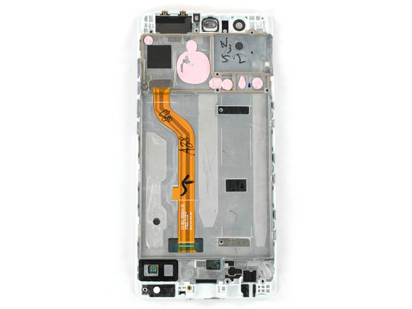

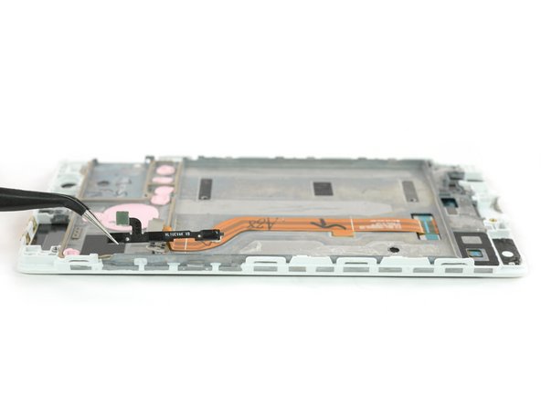

  17. Huawei P9 Display Assembly with Frame Replacement: crwdns2935265:017crwdnd2935265:01crwdnd2935265:03crwdne2935265:0 Huawei P9 Display Assembly with Frame Replacement: crwdns2935265:017crwdnd2935265:02crwdnd2935265:03crwdne2935265:0 Huawei P9 Display Assembly with Frame Replacement: crwdns2935265:017crwdnd2935265:03crwdnd2935265:03crwdne2935265:0
    • Remove the antenna cable and the power and volume bottom cable on either side.
    • Inspect the new part carefully and compare it to the old one. There might be some small parts that have to be transferred.
    • On the back of the motherboard there are thermal pads (pink rubber-like gobs) for heat dissipation. If these thermal pads broke, are too dried out or stick to the old display assembly you might need to apply new thermal pads to the new display assembly or the motherboard.
