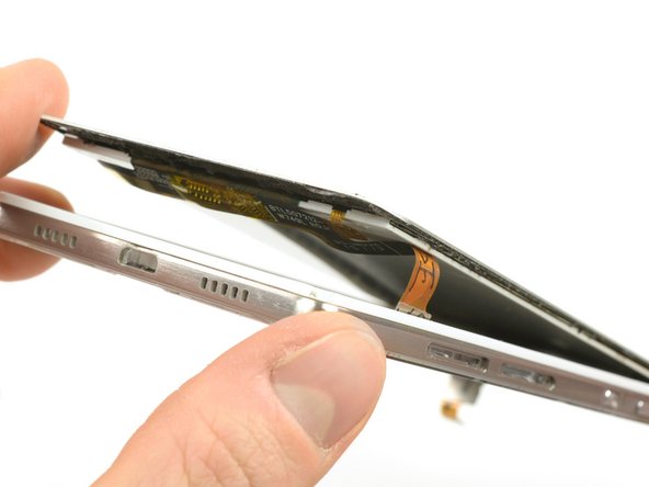

  13. Huawei P8 Lite Display Replacement: crwdns2935265:013crwdnd2935265:01crwdnd2935265:03crwdne2935265:0 Huawei P8 Lite Display Replacement: crwdns2935265:013crwdnd2935265:02crwdnd2935265:03crwdne2935265:0 Huawei P8 Lite Display Replacement: crwdns2935265:013crwdnd2935265:03crwdnd2935265:03crwdne2935265:0
    • Slowly but constantly lift the bottom part of the display to get underneath the screen and further loosen the adhesive.
    • Thread the cable through the midframe.
    • Open the display all the way and remove it from the midframe.
    • Make sure to test the new display and remove any old residue from the adhesive before reassembly.
