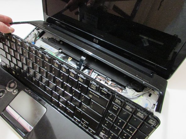

  7. Hp Pavilion dv6-2155dx USB Port Replacement: crwdns2935265:07crwdnd2935265:01crwdnd2935265:02crwdne2935265:0 Hp Pavilion dv6-2155dx USB Port Replacement: crwdns2935265:07crwdnd2935265:02crwdnd2935265:02crwdne2935265:0
    • Use a plastic spudger to gently un-clip the top panel above keyboard.
    • Tab openings are located by the F1 key, F5 key, and page up key
    • Once loose, do not try and remove it completely
  8. Hp Pavilion dv6-2155dx USB Port Replacement: crwdns2935265:08crwdnd2935265:01crwdnd2935265:02crwdne2935265:0 Hp Pavilion dv6-2155dx USB Port Replacement: crwdns2935265:08crwdnd2935265:02crwdnd2935265:02crwdne2935265:0
    • Once the top panel is propped open, remove the three 4mm silver screws located at the top of the keyboard with a Philips head screw driver, size #1.
    • Flip keyboard forward and raise the keyboard off the frame.
    • Be careful not to prop the top panel up too high as to disconnect the two ribbons connecting it to the inside of the laptop.
  9. Hp Pavilion dv6-2155dx USB Port Replacement: crwdns2935265:09crwdnd2935265:01crwdnd2935265:01crwdne2935265:0
    • Once you have removed the three screws, gently lift the keyboard away from the laptop.
    • Be careful when lifting the keyboard as to not break or damage the ribbon cable that connects the keyboard to the laptop.

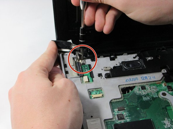

  21. Hp Pavilion dv6-2155dx USB Port Replacement: crwdns2935265:021crwdnd2935265:01crwdnd2935265:03crwdne2935265:0 Hp Pavilion dv6-2155dx USB Port Replacement: crwdns2935265:021crwdnd2935265:02crwdnd2935265:03crwdne2935265:0 Hp Pavilion dv6-2155dx USB Port Replacement: crwdns2935265:021crwdnd2935265:03crwdnd2935265:03crwdne2935265:0
    • support the display while removing the screws for this step to avoid damaging the display.
    • Remove the 4, 4 mm long screws that connect the display to the laptop, 2 screws per side.
    • Now you can safely remove the screen from the body of the laptop.

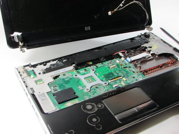

    • Starting in the front of the laptop, use a flat plastic spudger to gently pry the silver/chrome plastic bar off of the front of the laptop.
    • Once the silver/chrome bar is removed, the laptop cover should be loosened enough to remove.
    • You may need to pry along the sides of the laptop with the spudger if the laptop cover isn't loosened completely.
  25. Hp Pavilion dv6-2155dx USB Port Replacement: crwdns2935265:025crwdnd2935265:01crwdnd2935265:02crwdne2935265:0 Hp Pavilion dv6-2155dx USB Port Replacement: crwdns2935265:025crwdnd2935265:02crwdnd2935265:02crwdne2935265:0
    • Locate and disconnect the white and blue USB ribbon cable by grasping the ribbon with index finger and thumb to gently pull away from the USB ports.
  26. Hp Pavilion dv6-2155dx USB Port Replacement: crwdns2935265:026crwdnd2935265:01crwdnd2935265:03crwdne2935265:0 Hp Pavilion dv6-2155dx USB Port Replacement: crwdns2935265:026crwdnd2935265:02crwdnd2935265:03crwdne2935265:0 Hp Pavilion dv6-2155dx USB Port Replacement: crwdns2935265:026crwdnd2935265:03crwdnd2935265:03crwdne2935265:0
    • Remove the 2 black screws holding the 2 USB ports to the system board.
    • The 2 USB ports can now be removed and replaced.
