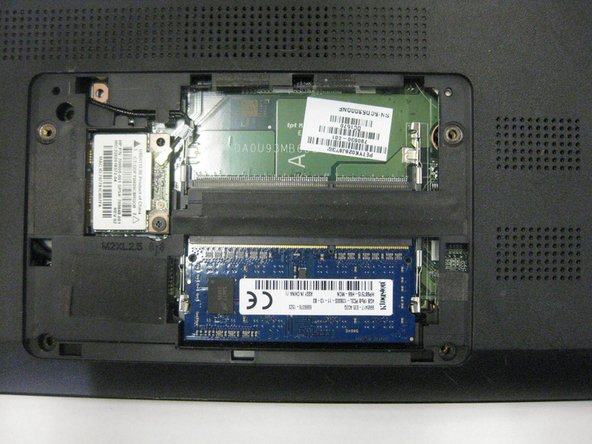

  5. Hp 15-f305dx RAM Replacement, RAM: crwdns2935265:05crwdnd2935265:01crwdnd2935265:01crwdne2935265:0
    • Remove the two 5mm Phillips #00 screws on the back service cover.
  6. Hp 15-f305dx RAM Replacement: crwdns2935265:06crwdnd2935265:01crwdnd2935265:02crwdne2935265:0 Hp 15-f305dx RAM Replacement: crwdns2935265:06crwdnd2935265:02crwdnd2935265:02crwdne2935265:0
    • With the hinge of the laptop screen facing away, remove the panel from the laptop on the near side of you.
  7. Hp 15-f305dx RAM Replacement: crwdns2935265:07crwdnd2935265:01crwdnd2935265:03crwdne2935265:0 Hp 15-f305dx RAM Replacement: crwdns2935265:07crwdnd2935265:02crwdnd2935265:03crwdne2935265:0 Hp 15-f305dx RAM Replacement: crwdns2935265:07crwdnd2935265:03crwdnd2935265:03crwdne2935265:0
    • Press the two locking arms on either side of the RAM card away from each other.
    • When the RAM is free from the locking arms, it should pop up to rest at an angle to the laptop.
    • Remove the RAM card by sliding it out from its port at the same angle at which it rests.
    • During reinstallation, insert the RAM card into the slot at the same angle which it rested earlier, then press it down until the locking arms clasp around it.
