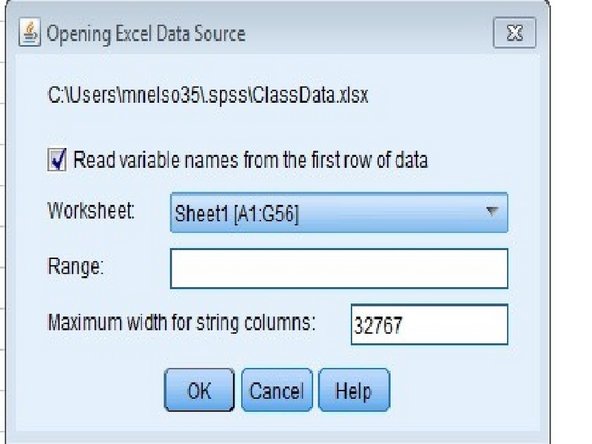

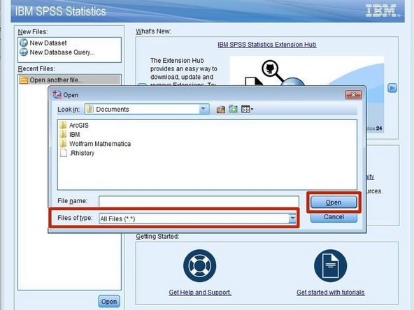

  3. How to use SPSS for Marketing Statistical Analysis: T-testing, Using existing data: crwdns2935265:04crwdnd2935265:01crwdnd2935265:03crwdne2935265:0 How to use SPSS for Marketing Statistical Analysis: T-testing, Using existing data: crwdns2935265:04crwdnd2935265:02crwdnd2935265:03crwdne2935265:0 How to use SPSS for Marketing Statistical Analysis: T-testing, Using existing data: crwdns2935265:04crwdnd2935265:03crwdnd2935265:03crwdne2935265:0
    • Click on "Open another file" as seen in Figure 1.
    • Make sure "Files of Type" is set to "All Files."
    • Click "Open" at the bottom of the window.
    • Click on the file you want to upload.
    • Click "Open" as shown in Figure 2.
    • Click "OK" as seen in Figure 3.
    • If the data is not in numerical form it will need to be labeled. Go to step 6 to learn for how to do this.

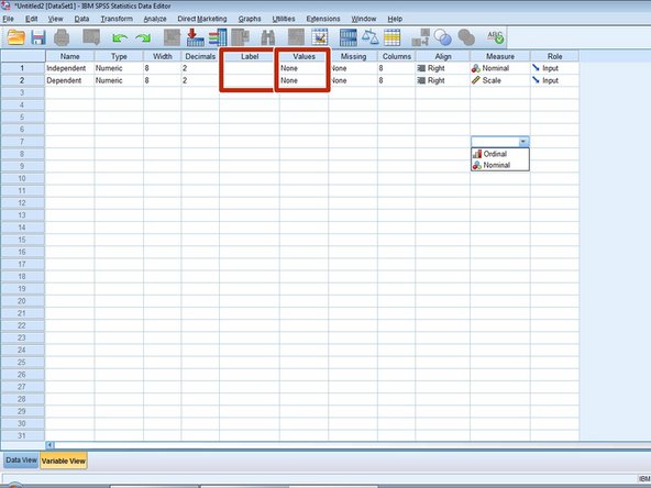

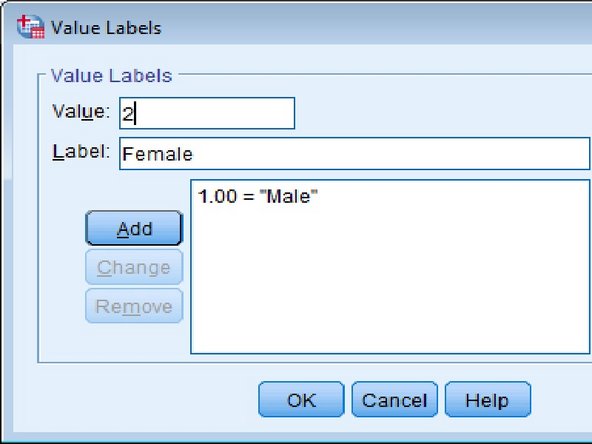

  5. How to use SPSS for Marketing Statistical Analysis: T-testing, Labeling Nominal Data: crwdns2935265:06crwdnd2935265:01crwdnd2935265:03crwdne2935265:0 How to use SPSS for Marketing Statistical Analysis: T-testing, Labeling Nominal Data: crwdns2935265:06crwdnd2935265:02crwdnd2935265:03crwdne2935265:0 How to use SPSS for Marketing Statistical Analysis: T-testing, Labeling Nominal Data: crwdns2935265:06crwdnd2935265:03crwdnd2935265:03crwdne2935265:0
    • Switch to "Variable View" as shown in Figure 1.
    • Type the label of your variable into the "Label" column as shown in Figure 2.
    • Click on the "Value" column shown in Figure 2.
    • The following steps are shown in Figure 3.
    • Insert the numerical value you would like to use in the "Value" spot.
    • Enter the name that the number represents in the "Label" spot.
    • Click "Add."
    • When complete, click "OK."

    • Click on “Variable View” at the bottom left of the page shown in Figure 1.
  7. How to use SPSS for Marketing Statistical Analysis: T-testing, Understanding Variable View: crwdns2935265:08crwdnd2935265:01crwdnd2935265:01crwdne2935265:0
    • In "Variable View":
    • The first column, “Name,” states the name of the variable.
    • The second column, “Type,” indicates the data type of the variable.
    • The third column, “Width,” indicates the number of characters available for the variable values.
    • The fourth column, “Decimals,” controls the number of digits after the decimal place.
    • The fifth column, “Label,” is used to make any necessary notes.
    • The sixth column, “Values,” provides a key for what the numbers of a numeric variable represent.
  8. How to use SPSS for Marketing Statistical Analysis: T-testing, Understanding Variable View Continued: crwdns2935265:09crwdnd2935265:01crwdnd2935265:01crwdne2935265:0
    • The seventh column, “Missing,” allows a choice of including or excluding values from analysis.
    • The eighth column, “Columns,” indicates the number of columns a variable has.
    • The ninth column, “Align,” indicates the alignment of the variables.
    • The tenth column, “Measure,” indicates the level of measurement of the variable.
    • The last column, “Role,” defines the role the variable will play in the analysis.

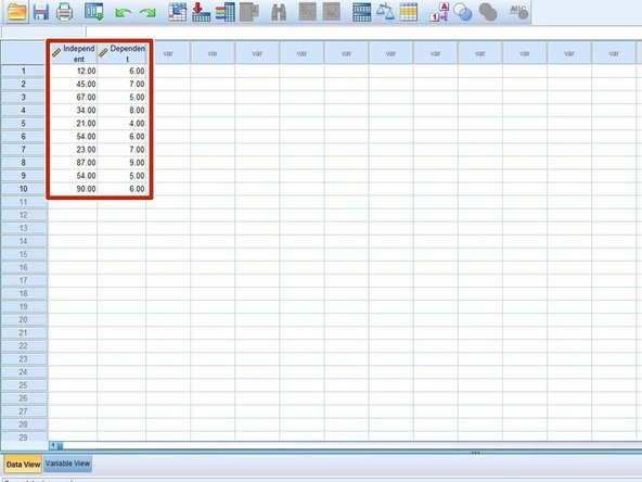

  9. How to use SPSS for Marketing Statistical Analysis: T-testing, Entering Data and Variable: crwdns2935265:010crwdnd2935265:01crwdnd2935265:03crwdne2935265:0 How to use SPSS for Marketing Statistical Analysis: T-testing, Entering Data and Variable: crwdns2935265:010crwdnd2935265:02crwdnd2935265:03crwdne2935265:0 How to use SPSS for Marketing Statistical Analysis: T-testing, Entering Data and Variable: crwdns2935265:010crwdnd2935265:03crwdnd2935265:03crwdne2935265:0
    • If you loaded existing data, ignore this step and skip to step 11.

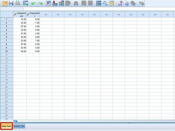

    • Make sure you are in “Variable View” by checking the bottom left corner of your screen.
    • Put your variable name in the upper left hand cell (no spaces) and make sure the measure is set to “Scale” as seen in Figure 1.
    • Switch to “Data View” as seen in Figure 2.
    • While in "Data View," plug in the data points under the column you just labeled as seen in Figure 3.

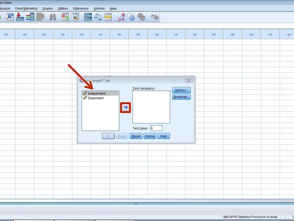

    • Click the “Analyze” tab in the upper left hand corner as seen in Figure 1.
    • Click on “Compare Means.”
    • Click “One Sample t-test.”
    • Move the dependent variable over using the arrow in the middle of the screen as seen in Figure 2.
    • Fill in the test value spot with the average of the population.
    • Click “OK.”
