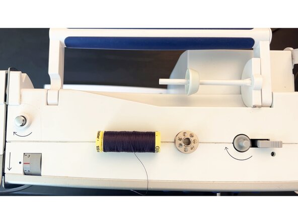

    • You'll need:
    • A sewing machine or bobbin winder
    • An empty bobbin (compatible with your machine or tool)
    • A spool of thread
    • Your sewing machine or bobbin winder manual (optional, but helpful, especially for first-timers!)
    • Place the bobbin onto the bobbin winder pin.
    • Place the spool of thread onto the spool pin.
    • Secure the spool with a cap if your machine uses one.
    • Guide the thread through the thread path and tension discs, following your machine's manual.
    • This step is essential for maintaining proper tension during winding.
    • Attach the thread to the bobbin:
    • If the bobbin has a hole, thread the end through it from the inside out.
    • If the bobbin doesn't have a hole, wrap the thread around the bobbin manually a few times in the direction it will spin.
    • Turn on the machine if it's not already on.
    • Engage the bobbin winder by pushing the bobbin pin to the right or pressing a knob, depending on your machine.
    • Some bobbin winders will start automatically. Others will require you to engage the foot pedal.
    • Hold the thread tail for the first few seconds, then let go once it’s secure.
    • The bobbin will spin and fill with thread.
    • Most machines stop automatically when the bobbin is full. If you want to stop the winder or if you run out of thread, disengage the bobbin pin.
    • Cut the thread and remove the bobbin.
    • The ideal bobbin has:
    • Uniform distribution: The thread should be wound in smooth, uniform layers across the entire bobbin. There are no peaks, dips, or bunching in the middle or at the edges.
    • Firm tension: The thread should be tight and compact. Each layer lies flat and smooth without loops or tangles.
    • Proper fill level: When full, the thread shouldn't extend past the rim of the bobbin.
