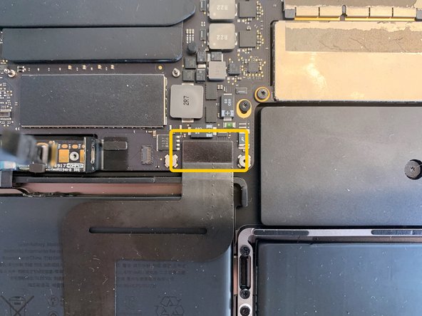

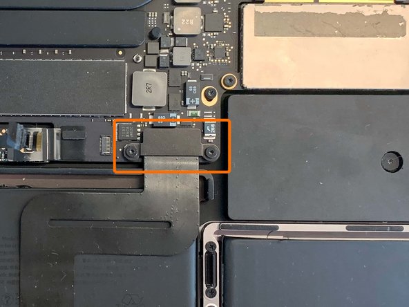

  3. How to Replace the CPU Thermal Compound, Disconnecting battery: crwdns2935265:03crwdnd2935265:01crwdnd2935265:02crwdne2935265:0 How to Replace the CPU Thermal Compound, Disconnecting battery: crwdns2935265:03crwdnd2935265:02crwdnd2935265:02crwdne2935265:0
    • Before you proceed to disconnect the battery to reduce the risk of harm to the computer. Or yourself via electric shock.
    • Gently lift up the black cover. Then use your fingernail to flip up the small ZIF connector (Zero insertion force). then detach the cable from the port. The next photo shows what the connector looks like.
    • Remove the single T5 screw holding the battery connector to the laptop.
    • Fold up the connector. Then its disconnected.
    • Place this screw in a parts tray.
    • Replacing Battery. Continue with this guide. This also has a more detailed method of disassembly. An apple service provider repaired this laptop in the past so its missing some parts incase your laptop looks different. Battery replacement Guide

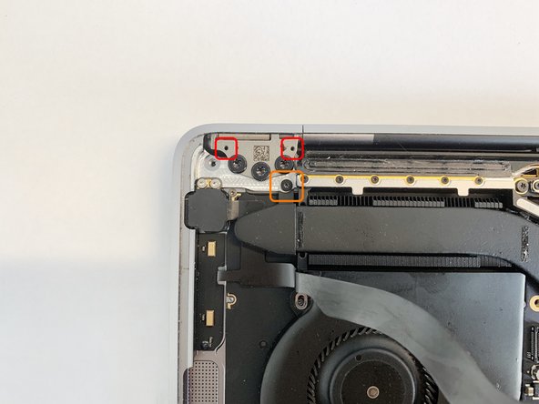

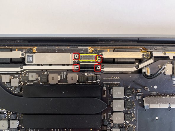

  10. How to Replace the CPU Thermal Compound: crwdns2935265:010crwdnd2935265:01crwdnd2935265:02crwdne2935265:0 How to Replace the CPU Thermal Compound: crwdns2935265:010crwdnd2935265:02crwdnd2935265:02crwdne2935265:0
    • Use T5 Torx screwdriver/Bit to remove the 4 screws.
    • Using an ESD safe pair of tweezers remove the 2 metal brackets.
    • Using a plastic spudger gently pry up on the display connector.
    • Be careful with removing the connector because it is a fragile connector and is prone to damage.
    • Remember to place the screws and brackets in a separate grid on the magnetic mat.

There is a mistake in Step 10.
It's not T5 Torx screwdriver, it's T3 Torx.
I have the same A1708, but it's MacBook Pro 13" Function Keys 2017.
