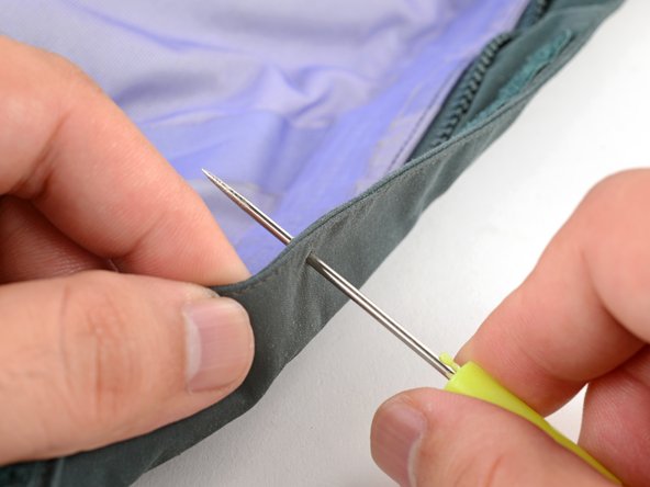

  3. How to Replace a Plastic Snap With a Handheld Tool, Clear the fabric hole: crwdns2935265:03crwdnd2935265:01crwdnd2935265:02crwdne2935265:0 How to Replace a Plastic Snap With a Handheld Tool, Clear the fabric hole: crwdns2935265:03crwdnd2935265:02crwdnd2935265:02crwdne2935265:0
    • Push the point of an awl through the fabric hole to clear it for the cap.
