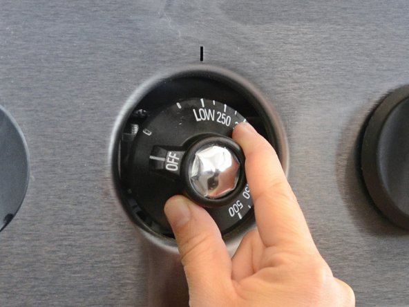

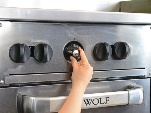

    • Preheat the oven to warm, or 175 degrees Fahrenheit (or 80 Celsius).

    • Slide your record, sandwiched between the two panels of glass, into the oven.
    • Stay with your record and watch it. If you smell anything funny or hear any strange noises, remove your record from the oven.
    • Warm your record in the oven for 2 or 3 minutes.
