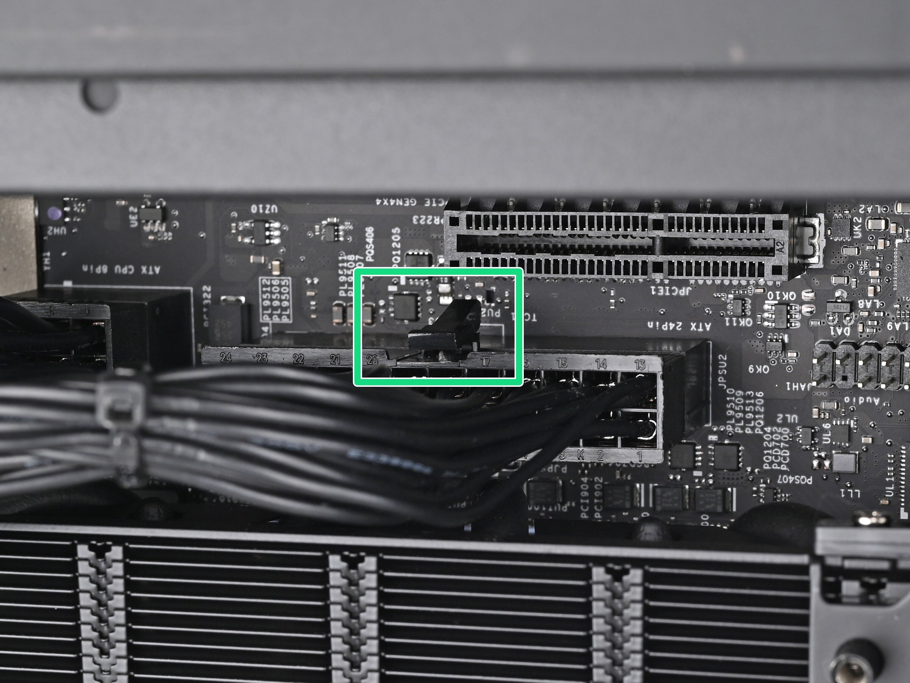

  14. Framework Desktop Power Supply Replacement, Disconnect the top Expansion Card cable: crwdns2935265:014crwdnd2935265:01crwdnd2935265:02crwdne2935265:0 Framework Desktop Power Supply Replacement, Disconnect the top Expansion Card cable: crwdns2935265:014crwdnd2935265:02crwdnd2935265:02crwdne2935265:0
    • Pull the top Expansion Card connector straight out of its socket in the Mainboard to disconnect it.

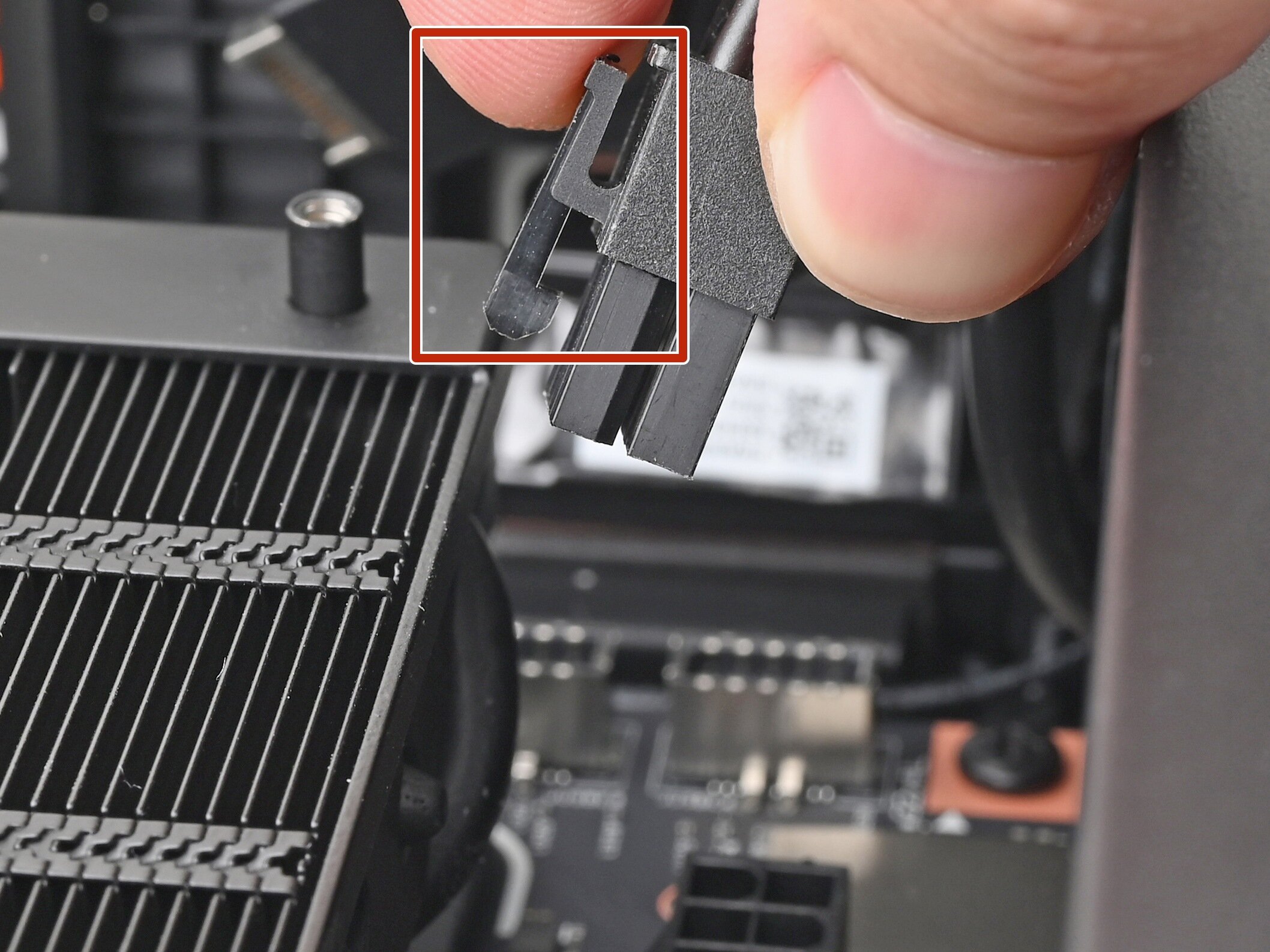

  15. Framework Desktop Power Supply Replacement, Disconnect the main power cable: crwdns2935265:015crwdnd2935265:01crwdnd2935265:02crwdne2935265:0 Framework Desktop Power Supply Replacement, Disconnect the main power cable: crwdns2935265:015crwdnd2935265:02crwdnd2935265:02crwdne2935265:0
    • While squeezing the clip on the main power cable, pull it straight up and out of its socket to disconnect it.
  16. Framework Desktop Power Supply Replacement, Disconnect the CPU power cable: crwdns2935265:016crwdnd2935265:01crwdnd2935265:02crwdne2935265:0 Framework Desktop Power Supply Replacement, Disconnect the CPU power cable: crwdns2935265:016crwdnd2935265:02crwdnd2935265:02crwdne2935265:0
    • While squeezing the clip on the CPU power cable, pull it straight up and out of its socket to disconnect it.
  17. Framework Desktop Power Supply Replacement, Disconnect the bottom Expansion Card cable: crwdns2935265:017crwdnd2935265:01crwdnd2935265:02crwdne2935265:0 Framework Desktop Power Supply Replacement, Disconnect the bottom Expansion Card cable: crwdns2935265:017crwdnd2935265:02crwdnd2935265:02crwdne2935265:0
    • Pull the bottom Expansion Card connector straight out of its socket in the Mainboard to disconnect it.

  58. Framework Desktop Power Supply Replacement, Connect the bottom Expansion Card cable: crwdns2935265:058crwdnd2935265:01crwdnd2935265:02crwdne2935265:0 Framework Desktop Power Supply Replacement, Connect the bottom Expansion Card cable: crwdns2935265:058crwdnd2935265:02crwdnd2935265:02crwdne2935265:0
    • Slide the bottom Expansion Card cable into its socket on the Mainboard.
  59. Framework Desktop Power Supply Replacement, Connect the CPU power cable: crwdns2935265:059crwdnd2935265:01crwdnd2935265:02crwdne2935265:0 Framework Desktop Power Supply Replacement, Connect the CPU power cable: crwdns2935265:059crwdnd2935265:02crwdnd2935265:02crwdne2935265:0
    • Orient the CPU power supply cable so its clip is facing the heatsink.
    • Slide the cable into its socket on the Mainboard until you feel it click into place.
