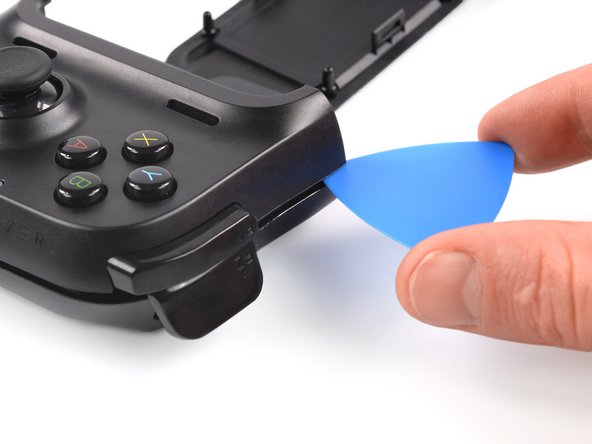

  2. How to Open the Razer Kishi, Release the bottom edge clips: crwdns2935265:02crwdnd2935265:01crwdnd2935265:03crwdne2935265:0 How to Open the Razer Kishi, Release the bottom edge clips: crwdns2935265:02crwdnd2935265:02crwdnd2935265:03crwdne2935265:0 How to Open the Razer Kishi, Release the bottom edge clips: crwdns2935265:02crwdnd2935265:03crwdnd2935265:03crwdne2935265:0
    • Both cases are held together by plastic clips.
    • Insert an opening pick in the seam between the top and bottom case, at the bottom left corner of the controller.
    • With the pick still in the seam, slide it along the bottom edge to the bottom right corner to loosen the plastic clips.
  3. How to Open the Razer Kishi, Release the side edge clips: crwdns2935265:03crwdnd2935265:01crwdnd2935265:02crwdne2935265:0 How to Open the Razer Kishi, Release the side edge clips: crwdns2935265:03crwdnd2935265:02crwdnd2935265:02crwdne2935265:0
    • Slide the opening pick along the right edge to loosen the plastic clips.
  4. How to Open the Razer Kishi, Release the top edge clips: crwdns2935265:04crwdnd2935265:01crwdnd2935265:02crwdne2935265:0 How to Open the Razer Kishi, Release the top edge clips: crwdns2935265:04crwdnd2935265:02crwdnd2935265:02crwdne2935265:0
    • Slide the opening pick along the top edge to loosen the remaining plastic clips.

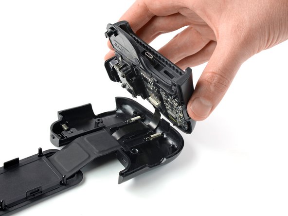

  5. How to Open the Razer Kishi: crwdns2935265:05crwdnd2935265:01crwdnd2935265:03crwdne2935265:0 How to Open the Razer Kishi: crwdns2935265:05crwdnd2935265:02crwdnd2935265:03crwdne2935265:0 How to Open the Razer Kishi: crwdns2935265:05crwdnd2935265:03crwdnd2935265:03crwdne2935265:0
    • Carefully lift the top side and unfold it to the right, like a book.

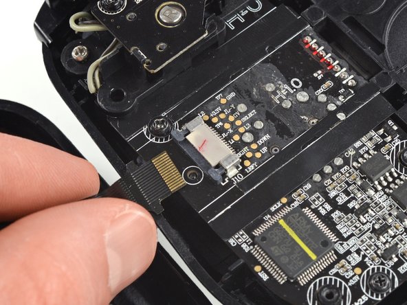

  6. How to Open the Razer Kishi, Disconnect the interconnect cable: crwdns2935265:06crwdnd2935265:01crwdnd2935265:03crwdne2935265:0 How to Open the Razer Kishi, Disconnect the interconnect cable: crwdns2935265:06crwdnd2935265:02crwdnd2935265:03crwdne2935265:0 How to Open the Razer Kishi, Disconnect the interconnect cable: crwdns2935265:06crwdnd2935265:03crwdnd2935265:03crwdne2935265:0
    • Using the pointed end of a spudger, push the grey tabs on the interconnect socket away from the socket, parallel to the interconnect cable, to release the cable.
    • Pull the cable out of the socket.
