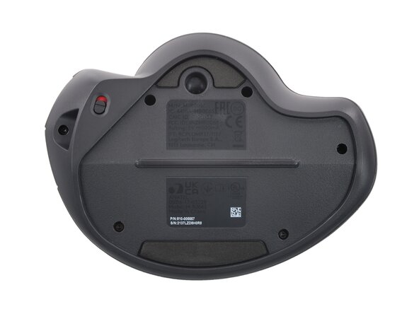

    • Before you begin, flip the mouse's power switch into the OFF position.
    • A red indicator should be visible beneath the switch.
    • Unplug all cables from your mouse.
    • Throughout your repair, it may be helpful to lay your mouse on a soft cloth to stabilize it and prevent damage while you work.
  2. How to Open the Logitech MX Ergo, Remove the cover: crwdns2935265:02crwdnd2935265:01crwdnd2935265:02crwdne2935265:0 How to Open the Logitech MX Ergo, Remove the cover: crwdns2935265:02crwdnd2935265:02crwdnd2935265:02crwdne2935265:0
    • Remove the magnetic cover by pulling it away from the bottom of your mouse.
  3. How to Open the Logitech MX Ergo, Remove the case screws: crwdns2935265:03crwdnd2935265:01crwdnd2935265:02crwdne2935265:0 How to Open the Logitech MX Ergo, Remove the case screws: crwdns2935265:03crwdnd2935265:02crwdnd2935265:02crwdne2935265:0
    • Use a Torx T6 screwdriver to remove the six 5.7 mm-long screws securing the two halves of the mouse together.

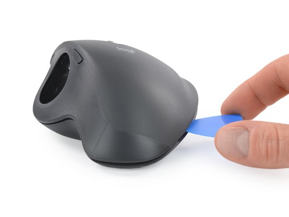

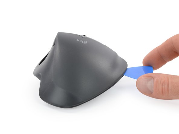

  5. How to Open the Logitech MX Ergo, Release the plastic clips: crwdns2935265:05crwdnd2935265:01crwdnd2935265:03crwdne2935265:0 How to Open the Logitech MX Ergo, Release the plastic clips: crwdns2935265:05crwdnd2935265:02crwdnd2935265:03crwdne2935265:0 How to Open the Logitech MX Ergo, Release the plastic clips: crwdns2935265:05crwdnd2935265:03crwdnd2935265:03crwdne2935265:0
    • Clips around the perimeter of the mouse case hold the two halves together.
    • Insert the tip of an opening pick into the seam between the two halves, near the middle of the right edge.
    • Twist the opening pick to release the plastic clip.

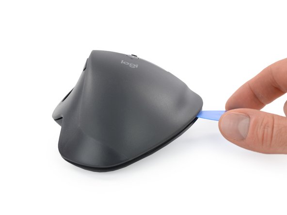

  6. How to Open the Logitech MX Ergo: crwdns2935265:06crwdnd2935265:01crwdnd2935265:02crwdne2935265:0 How to Open the Logitech MX Ergo: crwdns2935265:06crwdnd2935265:02crwdnd2935265:02crwdne2935265:0
    • Slide the opening pick along the seam until it's about half way to the rear of the mouse.
    • Twist the pick to release the plastic clip.
  7. How to Open the Logitech MX Ergo: crwdns2935265:07crwdnd2935265:01crwdnd2935265:02crwdne2935265:0 How to Open the Logitech MX Ergo: crwdns2935265:07crwdnd2935265:02crwdnd2935265:02crwdne2935265:0
    • Slide the opening pick all the way to the rear the mouse.
  8. How to Open the Logitech MX Ergo: crwdns2935265:08crwdnd2935265:01crwdnd2935265:02crwdne2935265:0 How to Open the Logitech MX Ergo: crwdns2935265:08crwdnd2935265:02crwdnd2935265:02crwdne2935265:0
    • Slide the opening pick to the middle of the left edge, next to the trackball recess.

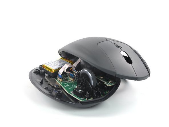

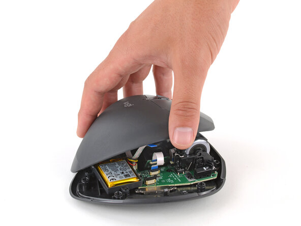

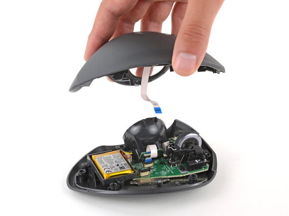

  9. How to Open the Logitech MX Ergo, Reposition the top half: crwdns2935265:09crwdnd2935265:01crwdnd2935265:03crwdne2935265:0 How to Open the Logitech MX Ergo, Reposition the top half: crwdns2935265:09crwdnd2935265:02crwdnd2935265:03crwdne2935265:0 How to Open the Logitech MX Ergo, Reposition the top half: crwdns2935265:09crwdnd2935265:03crwdnd2935265:03crwdne2935265:0
    • Don't completely separate the two halves yet—they're still connected by a delicate cable.
    • Gently lift the top half and place it to the left of the mouse so you can access the internals.
    • Be careful not to strain any of the cables inside the mouse.

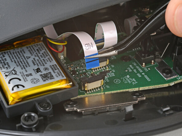

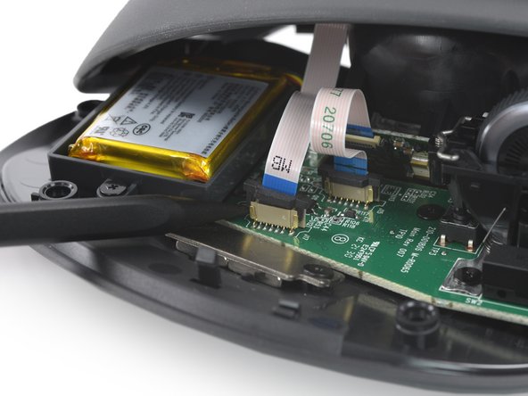

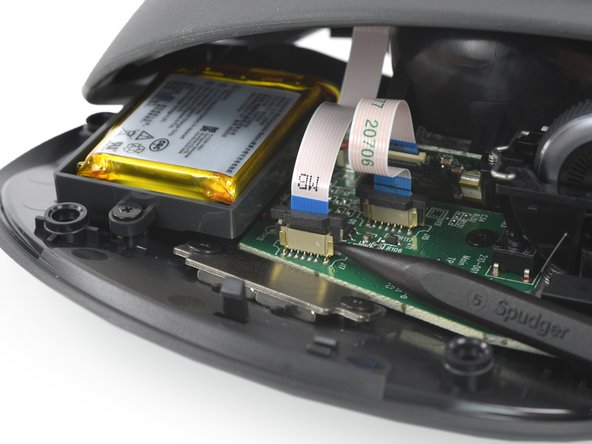

  10. How to Open the Logitech MX Ergo, Disconnect the interconnect cable: crwdns2935265:010crwdnd2935265:01crwdnd2935265:03crwdne2935265:0 How to Open the Logitech MX Ergo, Disconnect the interconnect cable: crwdns2935265:010crwdnd2935265:02crwdnd2935265:03crwdne2935265:0 How to Open the Logitech MX Ergo, Disconnect the interconnect cable: crwdns2935265:010crwdnd2935265:03crwdnd2935265:03crwdne2935265:0
    • Use the point of a spudger to gently lift alternating sides of the black sliding latch on the interconnect cable socket.
    • You should feel the latch pop into the unlocked position. Don't push too far, or the latch may come completely off the connector.

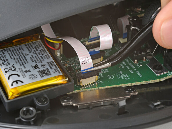

  11. How to Open the Logitech MX Ergo: crwdns2935265:011crwdnd2935265:01crwdnd2935265:02crwdne2935265:0 How to Open the Logitech MX Ergo: crwdns2935265:011crwdnd2935265:02crwdnd2935265:02crwdne2935265:0
    • Use tweezers or your fingers to pull the interconnect cable straight up and out of its socket.
  12. How to Open the Logitech MX Ergo, Remove the top half of the mouse: crwdns2935265:012crwdnd2935265:01crwdnd2935265:02crwdne2935265:0 How to Open the Logitech MX Ergo, Remove the top half of the mouse: crwdns2935265:012crwdnd2935265:02crwdnd2935265:02crwdne2935265:0
    • Lift the top half of the mouse straight up and remove it.
