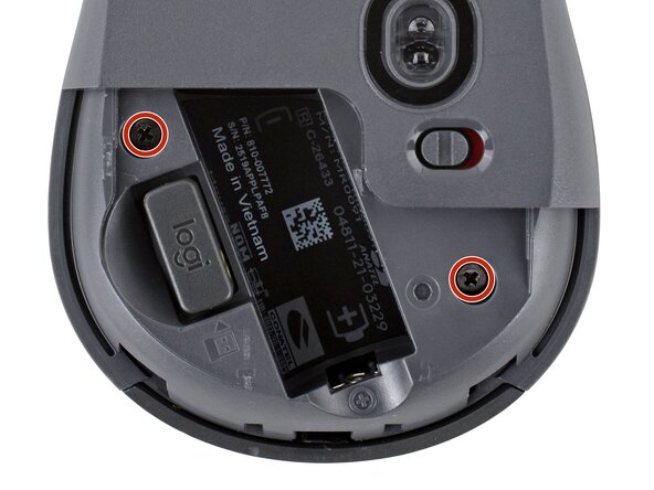

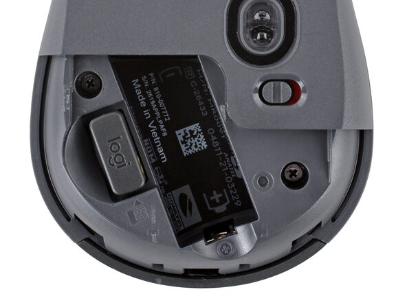

  4. How to Open Your Logitech Signature M650 Wireless Mouse, Remove the case screws: crwdns2935265:04crwdnd2935265:01crwdnd2935265:02crwdne2935265:0 How to Open Your Logitech Signature M650 Wireless Mouse, Remove the case screws: crwdns2935265:04crwdnd2935265:02crwdnd2935265:02crwdne2935265:0
    • Use a Phillips screwdriver to remove the two 5.5 mm‑long screws securing the two halves of the mouse together.

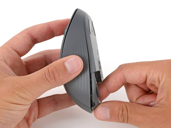

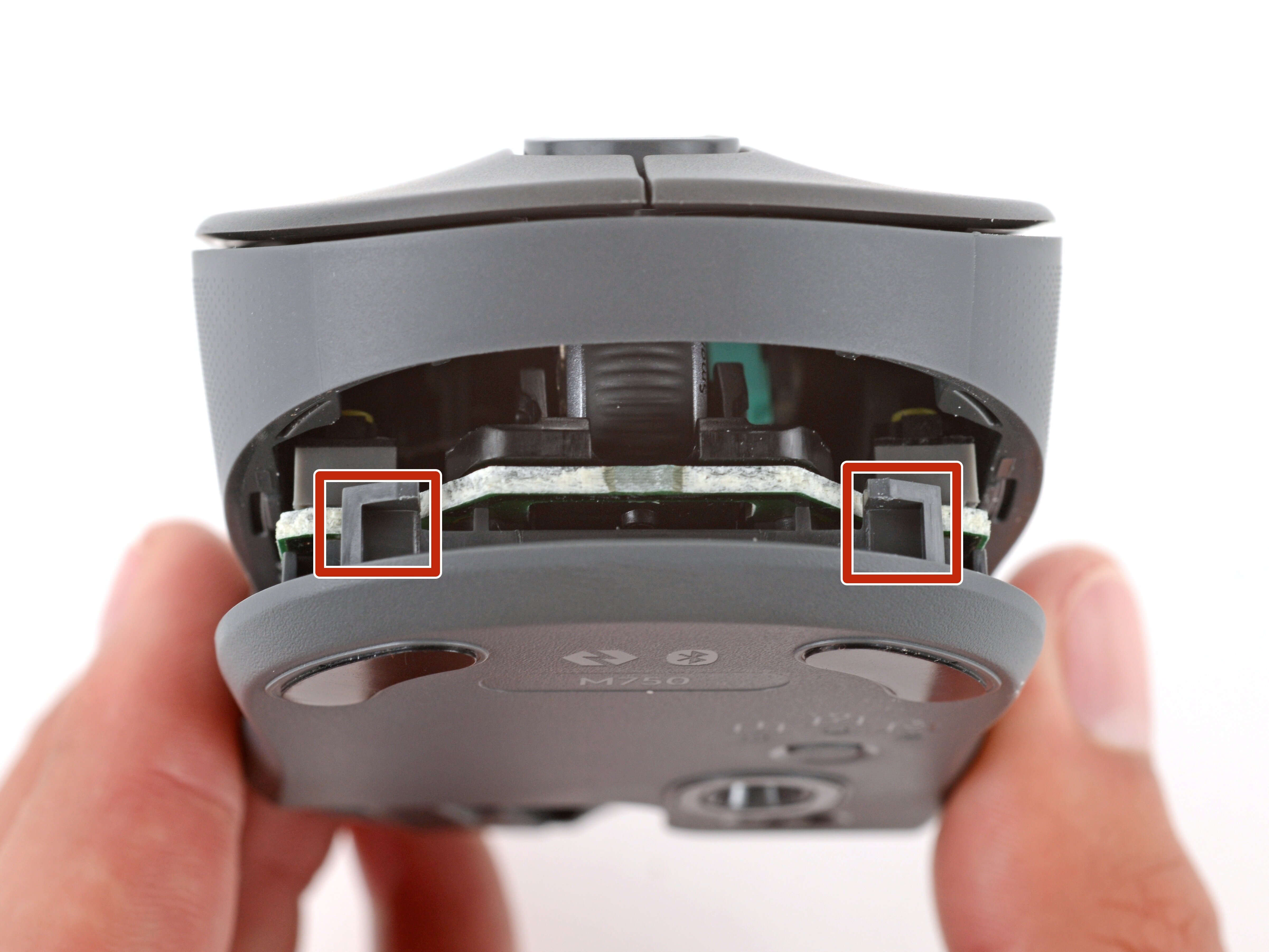

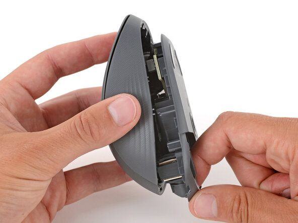

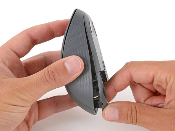

  5. How to Open Your Logitech Signature M650 Wireless Mouse, Separate the two halves: crwdns2935265:05crwdnd2935265:01crwdnd2935265:03crwdne2935265:0 How to Open Your Logitech Signature M650 Wireless Mouse, Separate the two halves: crwdns2935265:05crwdnd2935265:02crwdnd2935265:03crwdne2935265:0 How to Open Your Logitech Signature M650 Wireless Mouse, Separate the two halves: crwdns2935265:05crwdnd2935265:03crwdnd2935265:03crwdne2935265:0
    • The two halves of the mouse are secured by two clips near the front.
    • Hold the top half of the mouse and pull the bottom half away and down to separate it.
    • Don't try to fully separate the two halves yet—a cable still connects them.

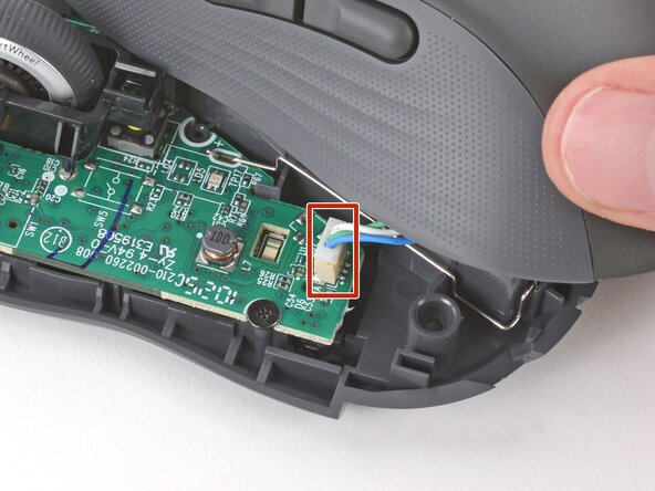

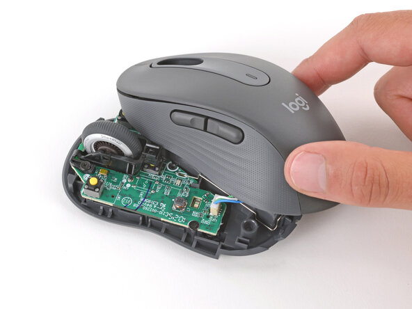

  6. How to Open Your Logitech Signature M650 Wireless Mouse, Reposition the top half: crwdns2935265:06crwdnd2935265:01crwdnd2935265:02crwdne2935265:0 How to Open Your Logitech Signature M650 Wireless Mouse, Reposition the top half: crwdns2935265:06crwdnd2935265:02crwdnd2935265:02crwdne2935265:0
    • Reposition the top half of the mouse so you can access its connector near the back.

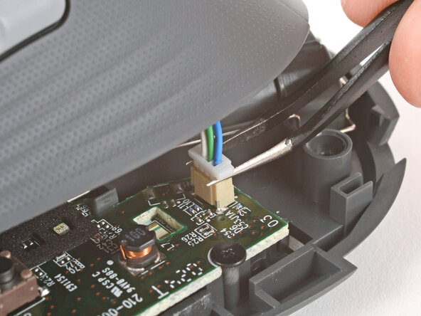

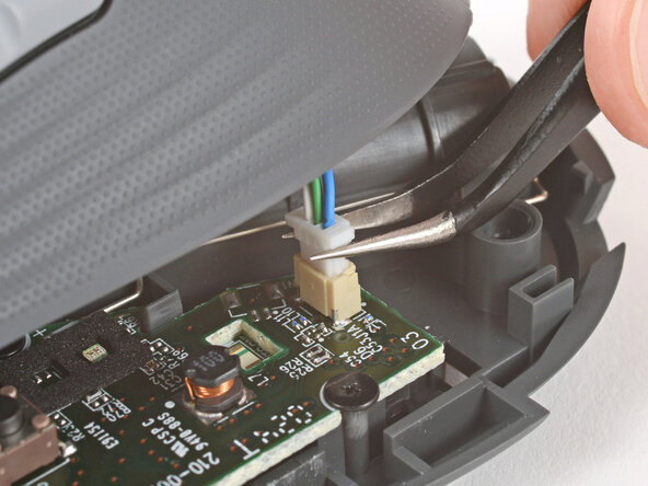

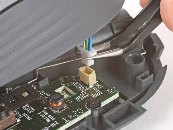

  7. How to Open Your Logitech Signature M650 Wireless Mouse, Disconnect the top half: crwdns2935265:07crwdnd2935265:01crwdnd2935265:03crwdne2935265:0 How to Open Your Logitech Signature M650 Wireless Mouse, Disconnect the top half: crwdns2935265:07crwdnd2935265:02crwdnd2935265:03crwdne2935265:0 How to Open Your Logitech Signature M650 Wireless Mouse, Disconnect the top half: crwdns2935265:07crwdnd2935265:03crwdnd2935265:03crwdne2935265:0
    • Use a pair of angled tweezers to firmly grip the base of the connector, just below its notches.
    • Hold your tweezers closer to the tips to get a better grip.
    • Gently rock the connector side‑to‑side and pull straight up to disconnect it.

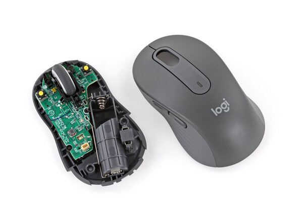

  8. How to Open Your Logitech Signature M650 Wireless Mouse, Remove the top half: crwdns2935265:08crwdnd2935265:01crwdnd2935265:01crwdne2935265:0
    • Remove the top half of the mouse from the bottom half.
