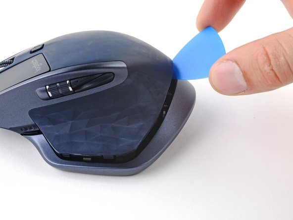

  7. How to Open Your Logitech MX Master, Release the gesture button clip: crwdns2935265:07crwdnd2935265:01crwdnd2935265:03crwdne2935265:0 How to Open Your Logitech MX Master, Release the gesture button clip: crwdns2935265:07crwdnd2935265:02crwdnd2935265:03crwdne2935265:0 How to Open Your Logitech MX Master, Release the gesture button clip: crwdns2935265:07crwdnd2935265:03crwdnd2935265:03crwdne2935265:0
    • Insert your opening pick into the seam between the thumb rest and the lower case.
    • Pry your pick upwards and pull the upper shell away from the lower case with your free hand until you see the gesture button clip release.
  8. How to Open Your Logitech MX Master, Release the rear clips: crwdns2935265:08crwdnd2935265:01crwdnd2935265:03crwdne2935265:0 How to Open Your Logitech MX Master, Release the rear clips: crwdns2935265:08crwdnd2935265:02crwdnd2935265:03crwdne2935265:0 How to Open Your Logitech MX Master, Release the rear clips: crwdns2935265:08crwdnd2935265:03crwdnd2935265:03crwdne2935265:0
    • Insert your opening pick between the rear of the upper shell and the lower case.
    • Slide your pick right, away from the thumb rest and pry upwards to release the two clips securing the rear of the upper shell.
    • Don't try to fully remove the top shell just yet—a cable connects the upper shell to the lower case.
