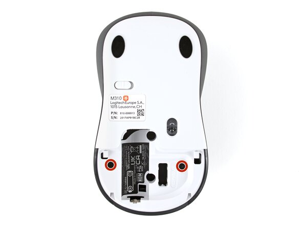

    • Before starting, flip the power switch on the bottom of your mouse to the left, so it's in the OFF position.
  2. How to Open Your Logitech M310 Wireless Mouse, Remove the battery cover: crwdns2935265:02crwdnd2935265:01crwdnd2935265:03crwdne2935265:0 How to Open Your Logitech M310 Wireless Mouse, Remove the battery cover: crwdns2935265:02crwdnd2935265:02crwdnd2935265:03crwdne2935265:0 How to Open Your Logitech M310 Wireless Mouse, Remove the battery cover: crwdns2935265:02crwdnd2935265:03crwdnd2935265:03crwdne2935265:0
    • Press down on the battery cover with your thumb and slide it away from the mouse to unclip it.
    • Remove the battery cover.

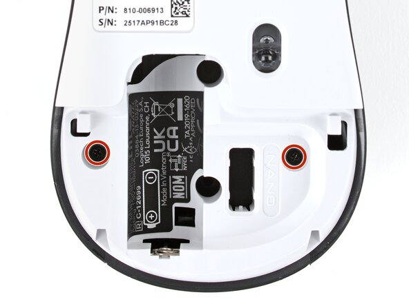

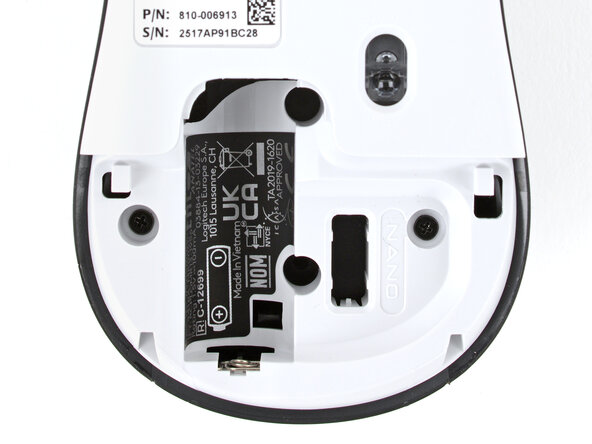

  4. How to Open Your Logitech M310 Wireless Mouse, Remove the case screws: crwdns2935265:04crwdnd2935265:01crwdnd2935265:03crwdne2935265:0 How to Open Your Logitech M310 Wireless Mouse, Remove the case screws: crwdns2935265:04crwdnd2935265:02crwdnd2935265:03crwdne2935265:0 How to Open Your Logitech M310 Wireless Mouse, Remove the case screws: crwdns2935265:04crwdnd2935265:03crwdnd2935265:03crwdne2935265:0
    • Use a Phillips screwdriver to remove the two 5.5 mm‑long screws securing the two halves of the mouse together.

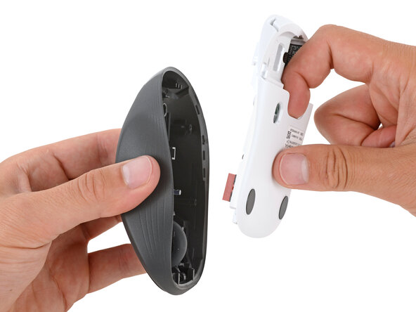

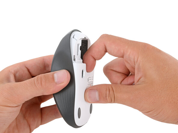

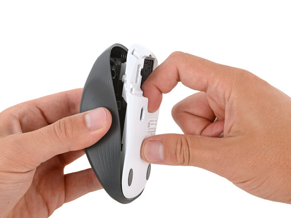

  5. How to Open Your Logitech M310 Wireless Mouse, Separate the mouse halves: crwdns2935265:05crwdnd2935265:01crwdnd2935265:03crwdne2935265:0 How to Open Your Logitech M310 Wireless Mouse, Separate the mouse halves: crwdns2935265:05crwdnd2935265:02crwdnd2935265:03crwdne2935265:0 How to Open Your Logitech M310 Wireless Mouse, Separate the mouse halves: crwdns2935265:05crwdnd2935265:03crwdnd2935265:03crwdne2935265:0
    • With one hand, hold the top half of the mouse.
    • With your free hand, insert a finger into the battery recess on the bottom half.
    • Pull the bottom half of the mouse away from the top half to unclip and remove it.
    • During reassembly, slide the bottom edge of the mouse into place first, and then squeeze the two shells together to engage all the clips.
