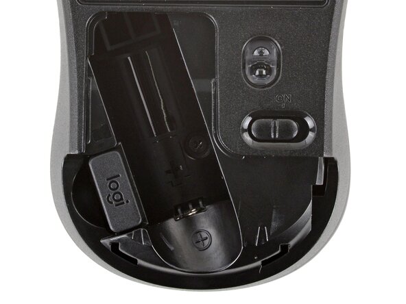

  3. How to Open Your Logitech M185 Wireless Mouse, Remove the battery: crwdns2935265:03crwdnd2935265:01crwdnd2935265:03crwdne2935265:0 How to Open Your Logitech M185 Wireless Mouse, Remove the battery: crwdns2935265:03crwdnd2935265:02crwdnd2935265:03crwdne2935265:0 How to Open Your Logitech M185 Wireless Mouse, Remove the battery: crwdns2935265:03crwdnd2935265:03crwdnd2935265:03crwdne2935265:0
    • Use your fingers to lift the end of the battery and slide it out of its recess.
    • During reassembly, slide the battery in negative (-) end first, as shown in the recess.

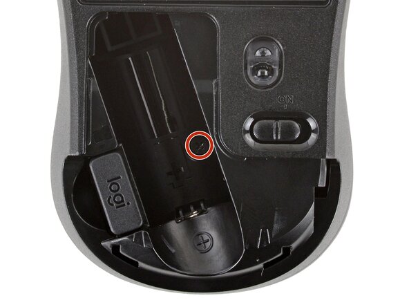

  4. How to Open Your Logitech M185 Wireless Mouse, Remove the case screw: crwdns2935265:04crwdnd2935265:01crwdnd2935265:02crwdne2935265:0 How to Open Your Logitech M185 Wireless Mouse, Remove the case screw: crwdns2935265:04crwdnd2935265:02crwdnd2935265:02crwdne2935265:0
    • Use a Phillips screwdriver to remove the 5.5 mm‑long screw from the battery recess.

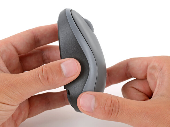

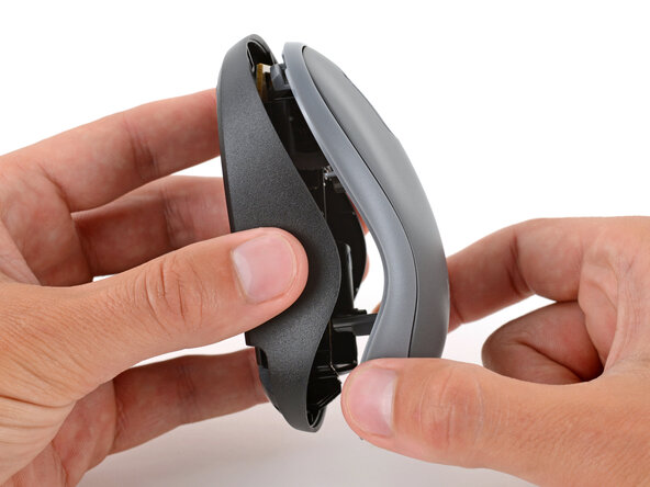

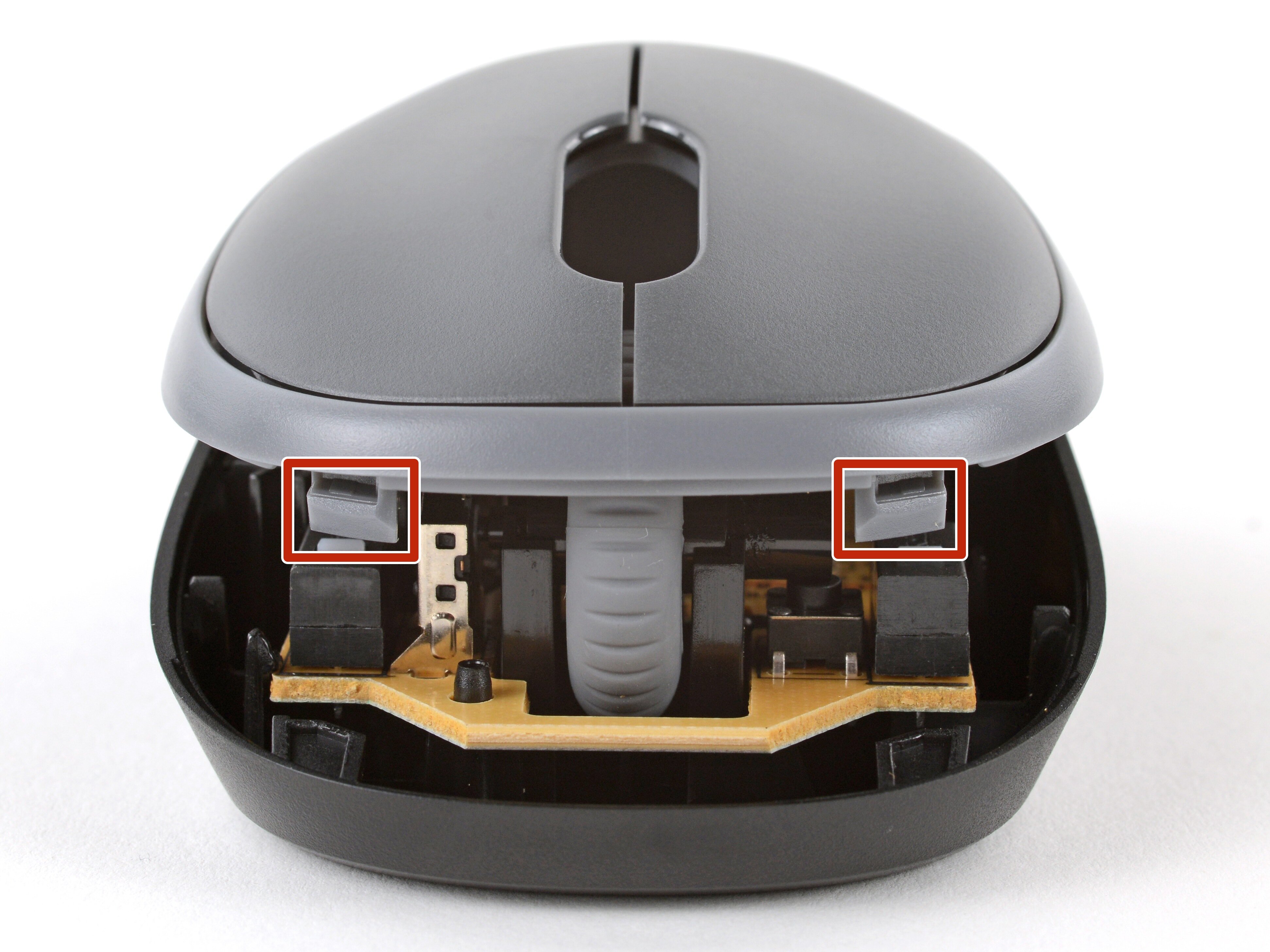

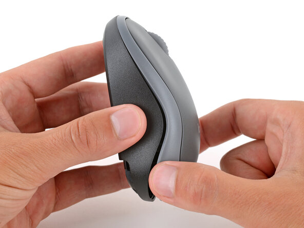

    • The two halves of the mouse are secured by two clips near the front.
    • Hold the top half of the mouse and pull the bottom half away and down to separate it.

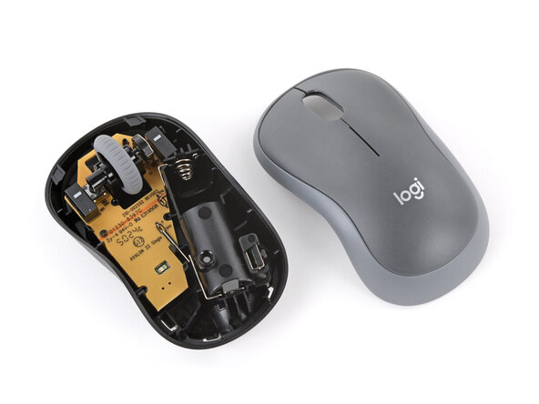

  6. How to Open Your Logitech M185 Wireless Mouse: crwdns2935265:06crwdnd2935265:01crwdnd2935265:01crwdne2935265:0
    • Your mouse is now open.
