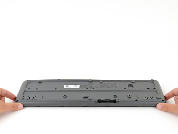

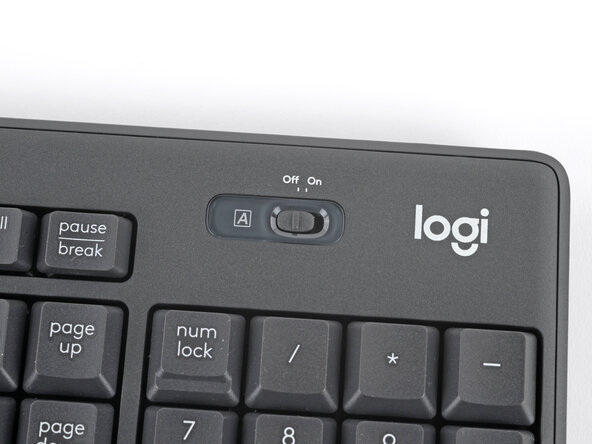

    • Slide the power switch to the OFF position.

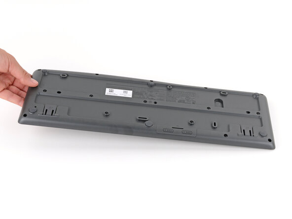

    • Flip your keyboard over and lay it down so the edge with the two tilt legs is closest to you.
    • If your work surface might scratch the keyboard, place a soft towel under it.

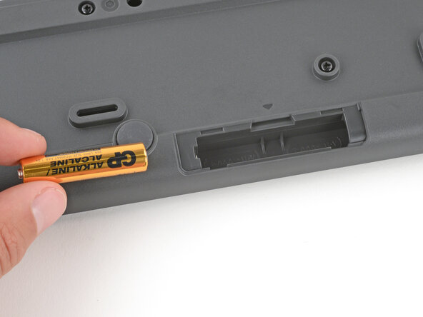

  2. How to Open Your Logitech K295 Keyboard, Remove the battery cover: crwdns2935265:02crwdnd2935265:01crwdnd2935265:03crwdne2935265:0 How to Open Your Logitech K295 Keyboard, Remove the battery cover: crwdns2935265:02crwdnd2935265:02crwdnd2935265:03crwdne2935265:0 How to Open Your Logitech K295 Keyboard, Remove the battery cover: crwdns2935265:02crwdnd2935265:03crwdnd2935265:03crwdne2935265:0
    • Pull the battery cover's center tab in and up to remove the cover.
  3. How to Open Your Logitech K295 Keyboard, Remove the batteries: crwdns2935265:03crwdnd2935265:01crwdnd2935265:03crwdne2935265:0 How to Open Your Logitech K295 Keyboard, Remove the batteries: crwdns2935265:03crwdnd2935265:02crwdnd2935265:03crwdne2935265:0 How to Open Your Logitech K295 Keyboard, Remove the batteries: crwdns2935265:03crwdnd2935265:03crwdnd2935265:03crwdne2935265:0

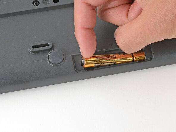

    • Use your finger to lift the edge of the first battery and remove it.
    • Slide the second battery out of its recess and remove it.
    • During reassembly, slide the AAA batteries in negative (-) end first, as shown in the recess.

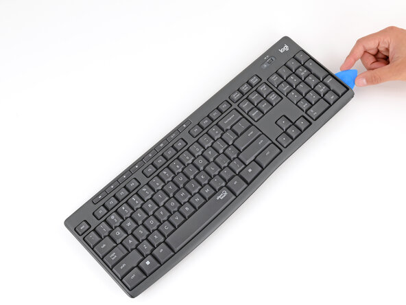

  6. How to Open Your Logitech K295 Keyboard, Insert an opening pick: crwdns2935265:06crwdnd2935265:01crwdnd2935265:03crwdne2935265:0 How to Open Your Logitech K295 Keyboard, Insert an opening pick: crwdns2935265:06crwdnd2935265:02crwdnd2935265:03crwdne2935265:0 How to Open Your Logitech K295 Keyboard, Insert an opening pick: crwdns2935265:06crwdnd2935265:03crwdnd2935265:03crwdne2935265:0

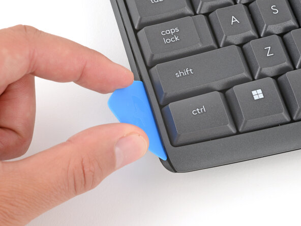

    • Insert the long edge of an opening pick in the seam between the two halves of the keyboard, by the bottom of the left edge.
    • Pry up the top half of the keyboard to release the clip.
    • You should feel and hear a "click" as the clip releases.
    • Leave the pick inserted for the next step.

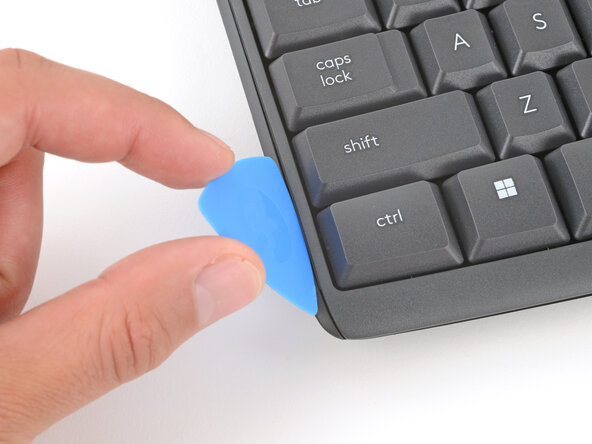

  7. How to Open Your Logitech K295 Keyboard, Release the clips: crwdns2935265:07crwdnd2935265:01crwdnd2935265:03crwdne2935265:0 How to Open Your Logitech K295 Keyboard, Release the clips: crwdns2935265:07crwdnd2935265:02crwdnd2935265:03crwdne2935265:0 How to Open Your Logitech K295 Keyboard, Release the clips: crwdns2935265:07crwdnd2935265:03crwdnd2935265:03crwdne2935265:0
    • With the pick angled flat to the keyboard, slide it along the left edge to release the clips securing the two halves.
    • You should feel and hear "clicks" as the pick slides along each section. If you don't, the clips didn't release—slide the pick along the section again and pry gently.

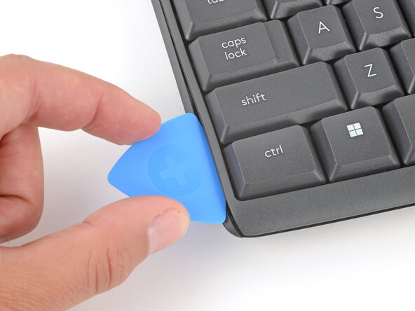

  8. How to Open Your Logitech K295 Keyboard: crwdns2935265:08crwdnd2935265:01crwdnd2935265:03crwdne2935265:0 How to Open Your Logitech K295 Keyboard: crwdns2935265:08crwdnd2935265:02crwdnd2935265:03crwdne2935265:0 How to Open Your Logitech K295 Keyboard: crwdns2935265:08crwdnd2935265:03crwdnd2935265:03crwdne2935265:0
    • Continue sliding the pick along the top and right edges until all the clips are released.
    • Don't try to fully separate the two halves yet—you risk damaging the plastic membrane connected to the top half.

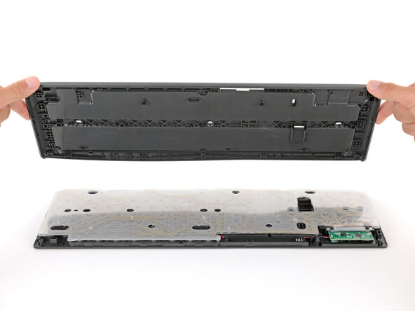

  9. How to Open Your Logitech K295 Keyboard, Flip your keyboard over: crwdns2935265:09crwdnd2935265:01crwdnd2935265:01crwdne2935265:0
    • Gently hold the two halves of the keyboard together and flip it over so the bottom is facing up.
  10. How to Open Your Logitech K295 Keyboard, Remove the bottom half: crwdns2935265:010crwdnd2935265:01crwdnd2935265:02crwdne2935265:0 How to Open Your Logitech K295 Keyboard, Remove the bottom half: crwdns2935265:010crwdnd2935265:02crwdnd2935265:02crwdne2935265:0
    • Remove the bottom half of the keyboard.
