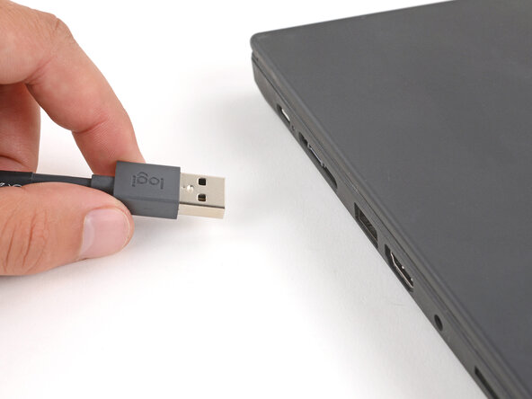

  1. How to Open Your Logitech Brio 100 Webcam, Unplug your webcam: crwdns2935265:01crwdnd2935265:01crwdnd2935265:01crwdne2935265:0
    • Before you begin, unplug your webcam.

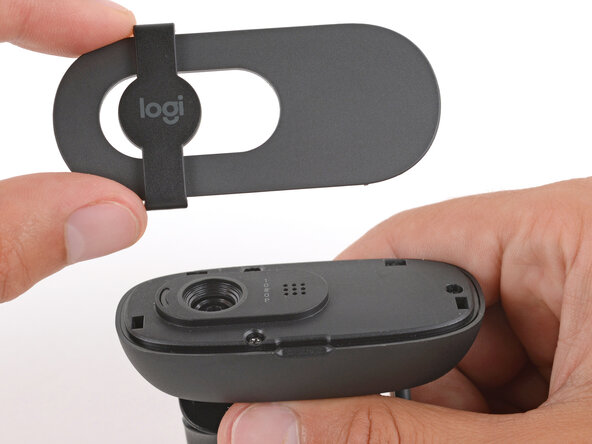

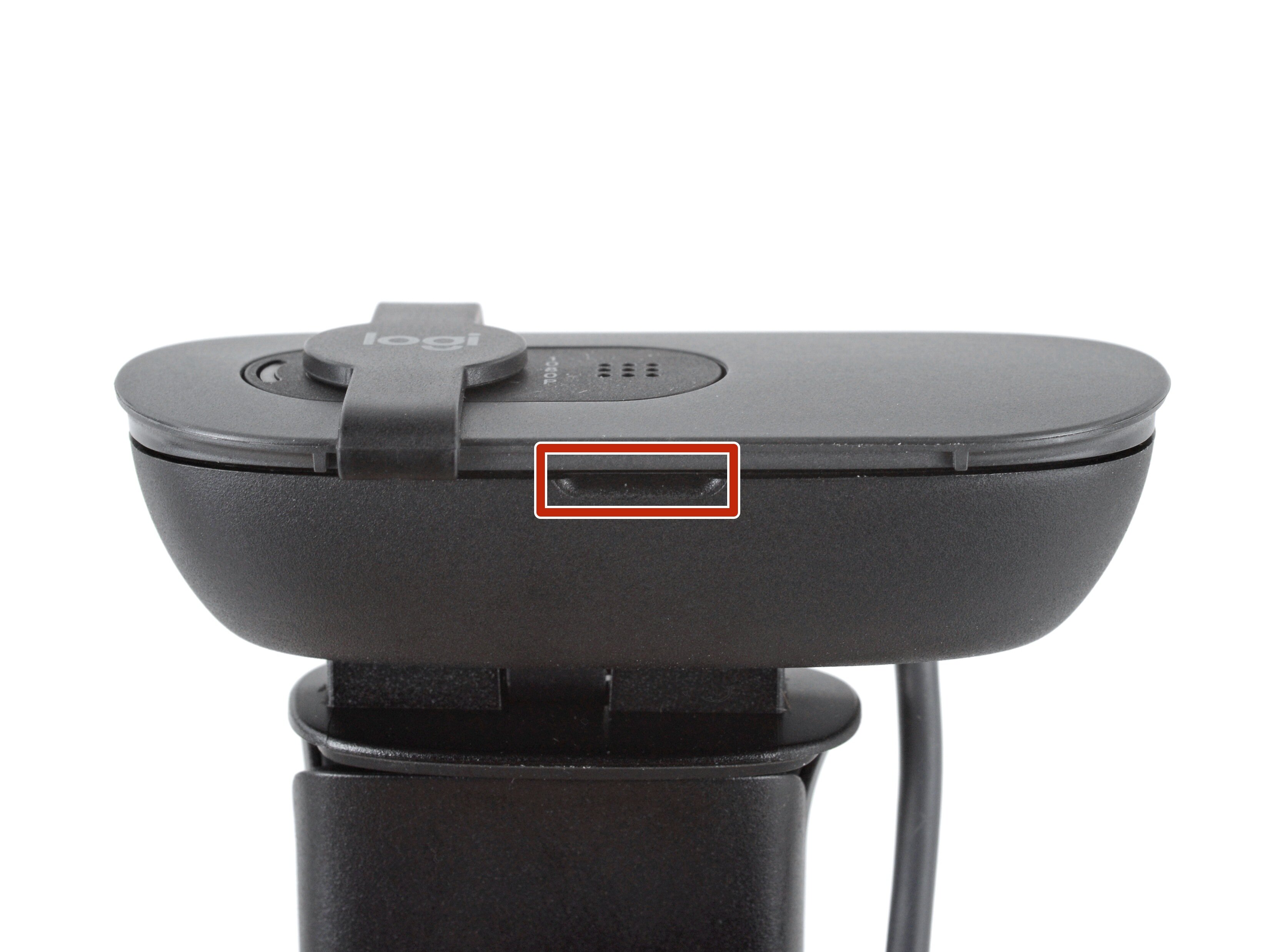

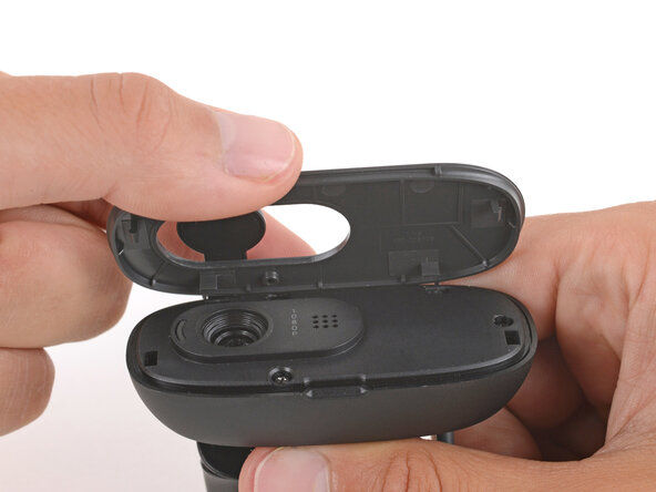

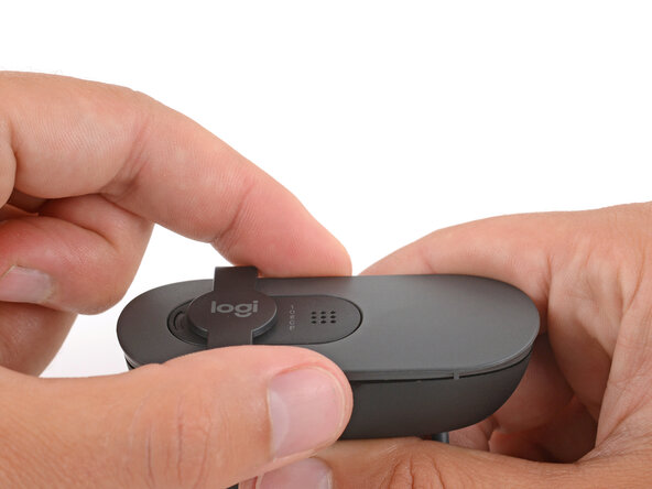

  2. How to Open Your Logitech Brio 100 Webcam, Remove the front cover: crwdns2935265:02crwdnd2935265:01crwdnd2935265:03crwdne2935265:0 How to Open Your Logitech Brio 100 Webcam, Remove the front cover: crwdns2935265:02crwdnd2935265:02crwdnd2935265:03crwdne2935265:0 How to Open Your Logitech Brio 100 Webcam, Remove the front cover: crwdns2935265:02crwdnd2935265:03crwdnd2935265:03crwdne2935265:0
    • Use your finger to pry up and remove the front cover by the notch on the bottom edge.
    • You'll feel and hear "clicks" as the clips securing the cover release.
    • During reassembly, put the cover in place and press firmly around the perimeter to engage all the clips.

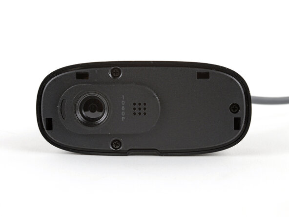

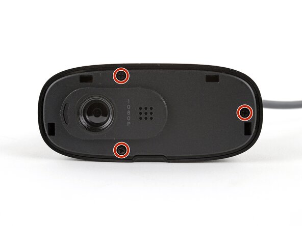

  3. How to Open Your Logitech Brio 100 Webcam, Remove the inner housing screws: crwdns2935265:03crwdnd2935265:01crwdnd2935265:02crwdne2935265:0 How to Open Your Logitech Brio 100 Webcam, Remove the inner housing screws: crwdns2935265:03crwdnd2935265:02crwdnd2935265:02crwdne2935265:0
    • Use a Phillips screwdriver to remove the three 5.1 mm‑long screws securing the inner housing.

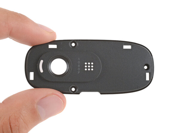

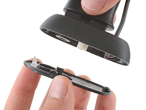

  4. How to Open Your Logitech Brio 100 Webcam, Remove the inner housing: crwdns2935265:04crwdnd2935265:01crwdnd2935265:02crwdne2935265:0 How to Open Your Logitech Brio 100 Webcam, Remove the inner housing: crwdns2935265:04crwdnd2935265:02crwdnd2935265:02crwdne2935265:0
    • Slowly flip your webcam over and let the inner housing fall out.

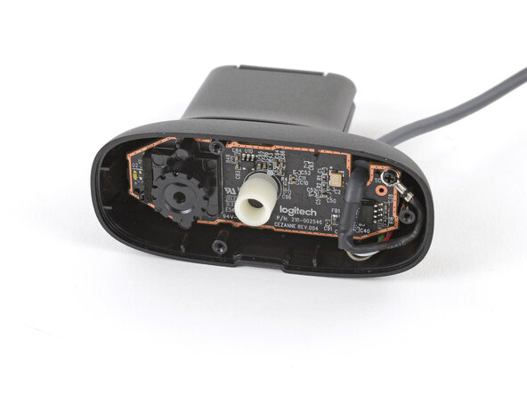

  5. How to Open Your Logitech Brio 100 Webcam, Your webcam is open: crwdns2935265:05crwdnd2935265:01crwdnd2935265:01crwdne2935265:0
    • Your webcam is now open, with the internals accessible.
