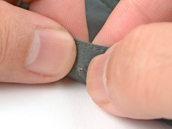

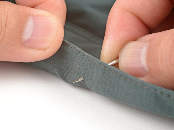

  2. How to Install a Plastic Snap With a Handheld Tool, Pierce the fabric: crwdns2935265:02crwdnd2935265:01crwdnd2935265:02crwdne2935265:0 How to Install a Plastic Snap With a Handheld Tool, Pierce the fabric: crwdns2935265:02crwdnd2935265:02crwdnd2935265:02crwdne2935265:0
    • Push the point of an awl through the fabric to pierce a hole for the snap.
    • It's better to measure twice, pierce once! Piercing the fabric multiple times within a small area will weaken the fabric.

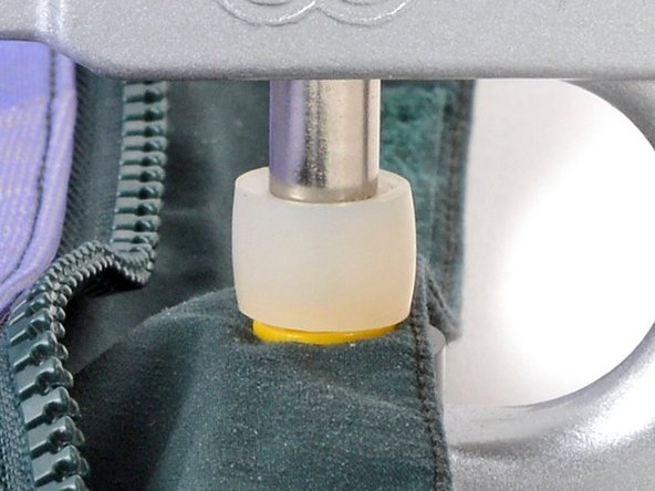

  4. How to Install a Plastic Snap With a Handheld Tool: crwdns2935265:04crwdnd2935265:01crwdnd2935265:03crwdne2935265:0 How to Install a Plastic Snap With a Handheld Tool: crwdns2935265:04crwdnd2935265:02crwdnd2935265:03crwdne2935265:0 How to Install a Plastic Snap With a Handheld Tool: crwdns2935265:04crwdnd2935265:03crwdnd2935265:03crwdne2935265:0
    • Place either a stud or a socket on top of the pin.
    • If you can't see the pin after placing the stud or socket, the fabric is too thick for the snap. You'll need a cap with a longer pin.

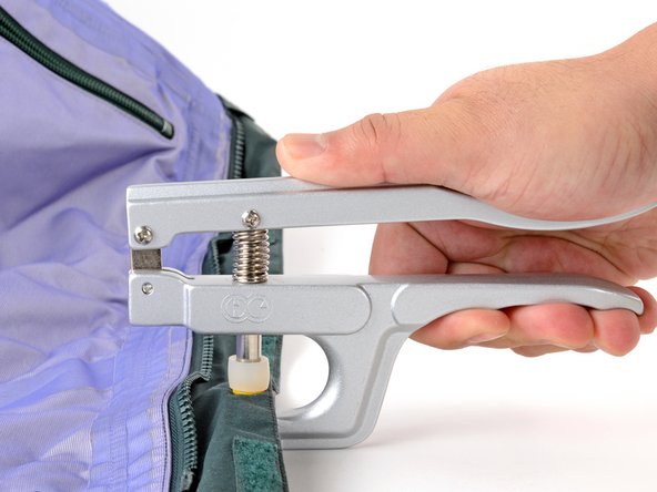

  5. How to Install a Plastic Snap With a Handheld Tool: crwdns2935265:05crwdnd2935265:01crwdnd2935265:02crwdne2935265:0 How to Install a Plastic Snap With a Handheld Tool: crwdns2935265:05crwdnd2935265:02crwdnd2935265:02crwdne2935265:0
    • Make sure the snap is facing the correct side for the clothing item.
    • Center the snap components in the fastener tool. The cap should sit fully in the black die cup.
  6. How to Install a Plastic Snap With a Handheld Tool: crwdns2935265:06crwdnd2935265:01crwdnd2935265:03crwdne2935265:0 How to Install a Plastic Snap With a Handheld Tool: crwdns2935265:06crwdnd2935265:02crwdnd2935265:03crwdne2935265:0 How to Install a Plastic Snap With a Handheld Tool: crwdns2935265:06crwdnd2935265:03crwdnd2935265:03crwdne2935265:0
    • Firmly squeeze the fastener tool handles. The white rubber head should bulge slightly from the force.
    • Release the handles and remove the tool from the snap.

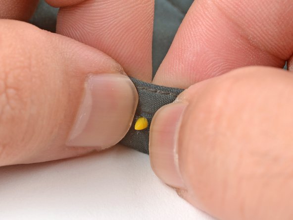

  7. How to Install a Plastic Snap With a Handheld Tool, Check the new snap: crwdns2935265:07crwdnd2935265:01crwdnd2935265:02crwdne2935265:0 How to Install a Plastic Snap With a Handheld Tool, Check the new snap: crwdns2935265:07crwdnd2935265:02crwdnd2935265:02crwdne2935265:0
    • Visually inspect the snap. The center pin should be evenly flattened.
    • Pull on the snap. The snap shouldn't feel loose.
    • If the pin isn't evenly flattened or the snap feels loose, use the fastener tool to compress the snap again. If that doesn't fix it, remove the snap and start again.
