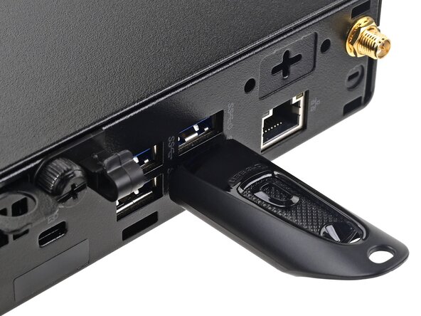

    • Connect a USB flash drive with at least 4 GB of capacity to the fastest available port on the computer.
    • Use a USB 3 drive connected to a USB 3 port for faster installation. USB 3 ports are usually colored blue and/or labeled SuperSpeed (SS).

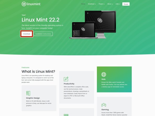

    • Navigate to the Linux Mint website and click Download.
    • Select a desktop environment (Cinnamon, Xfce, or MATE) based on the description and screenshot. Select Download on the one you choose.
    • Linux Mint provides regional download mirrors. The file is identical for each. Pick the one that matches your region or preference.

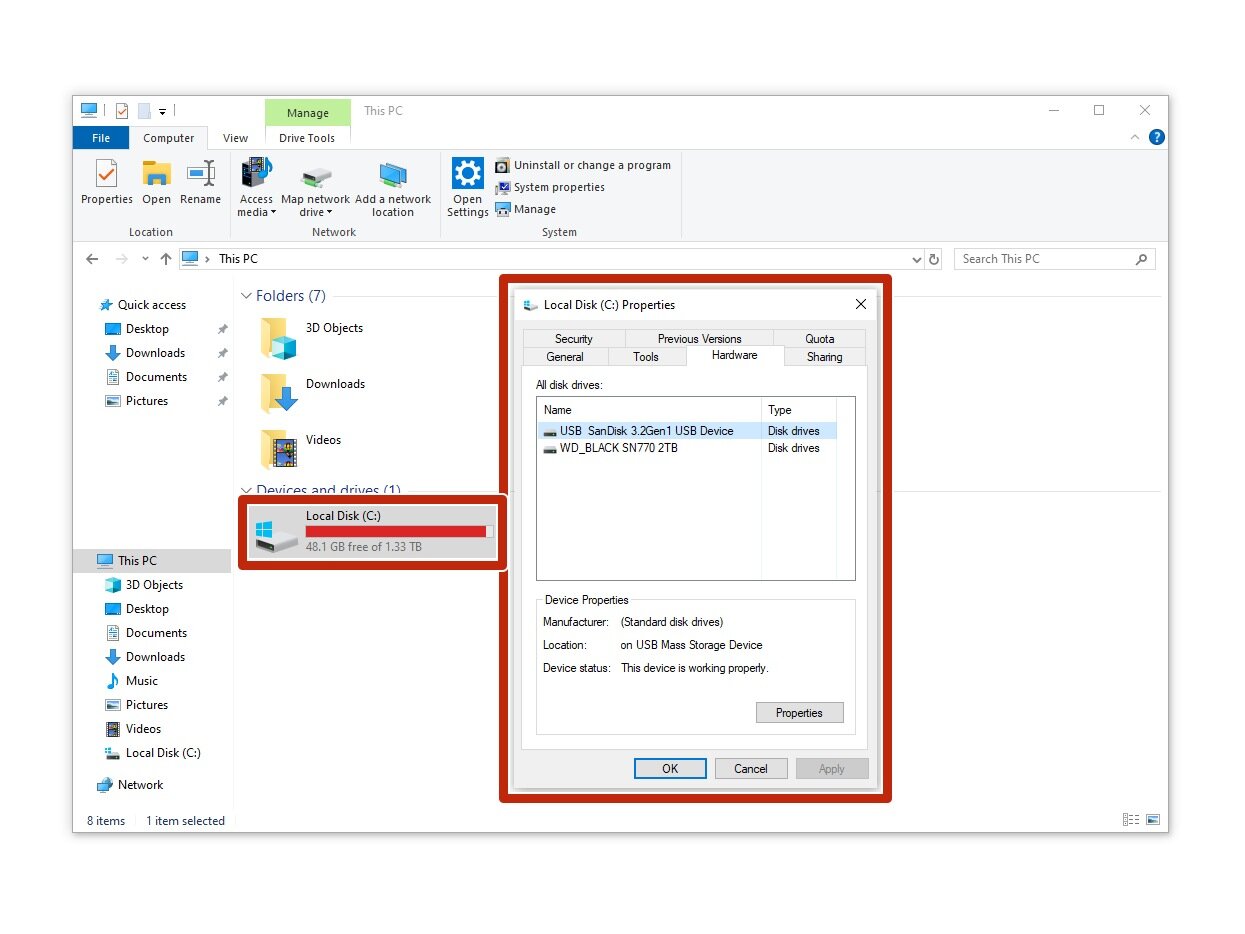

    • If you have multiple drives, check the contents of each in the This PC section of File Explorer and note their capacity and model. Right‑click each drive and click Properties then Hardware. This helps prevent picking the wrong drive later.

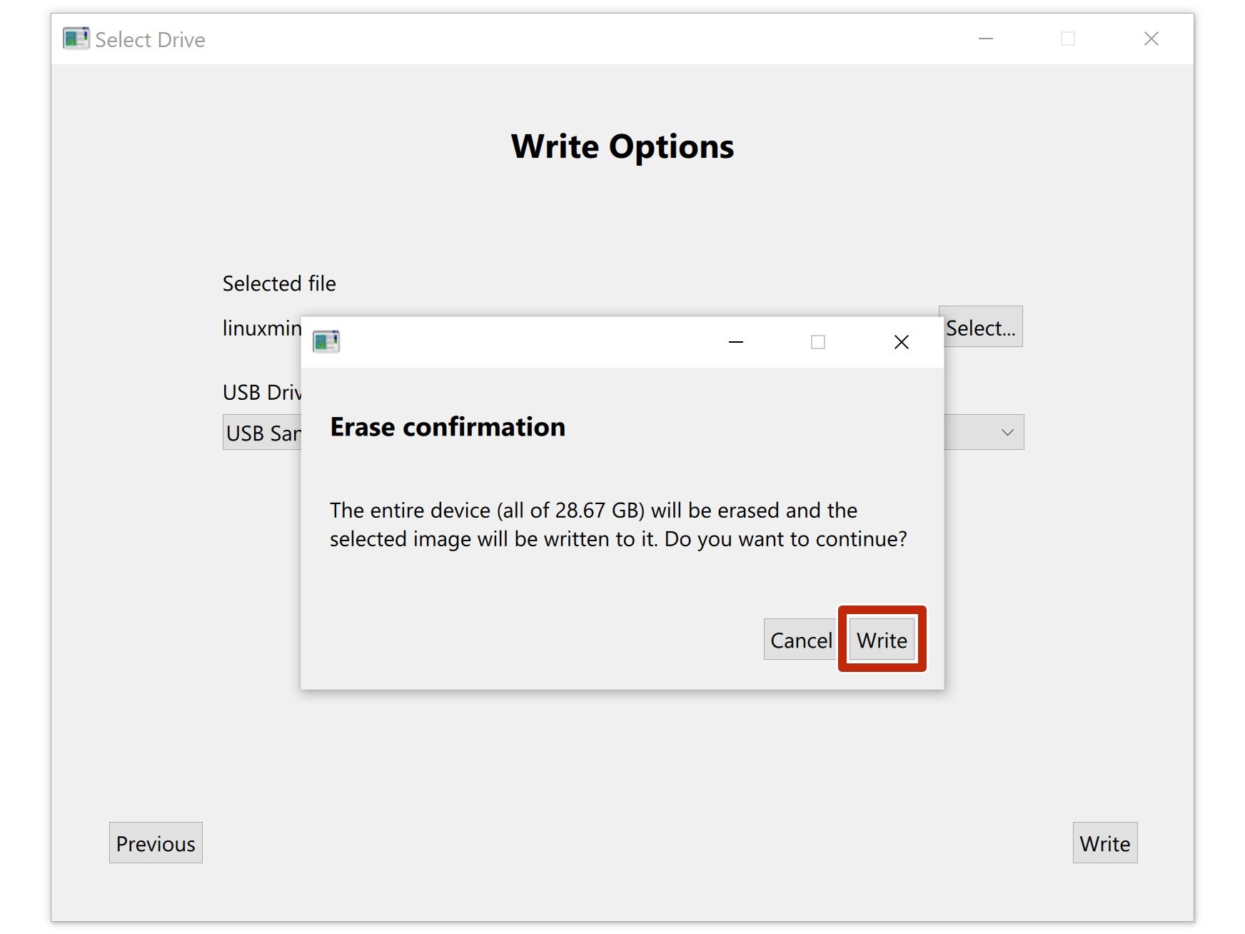

    • Select the USB drive you want to be erased and have the Linux Mint installer written to.
    • Double-check everything is correct, then select Write. A window will pop up asking to confirm. Select Write to erase the chosen drive and write the Linux Mint installer to it.
    • Wait for the installer to be written to the USB drive, then select Finish.

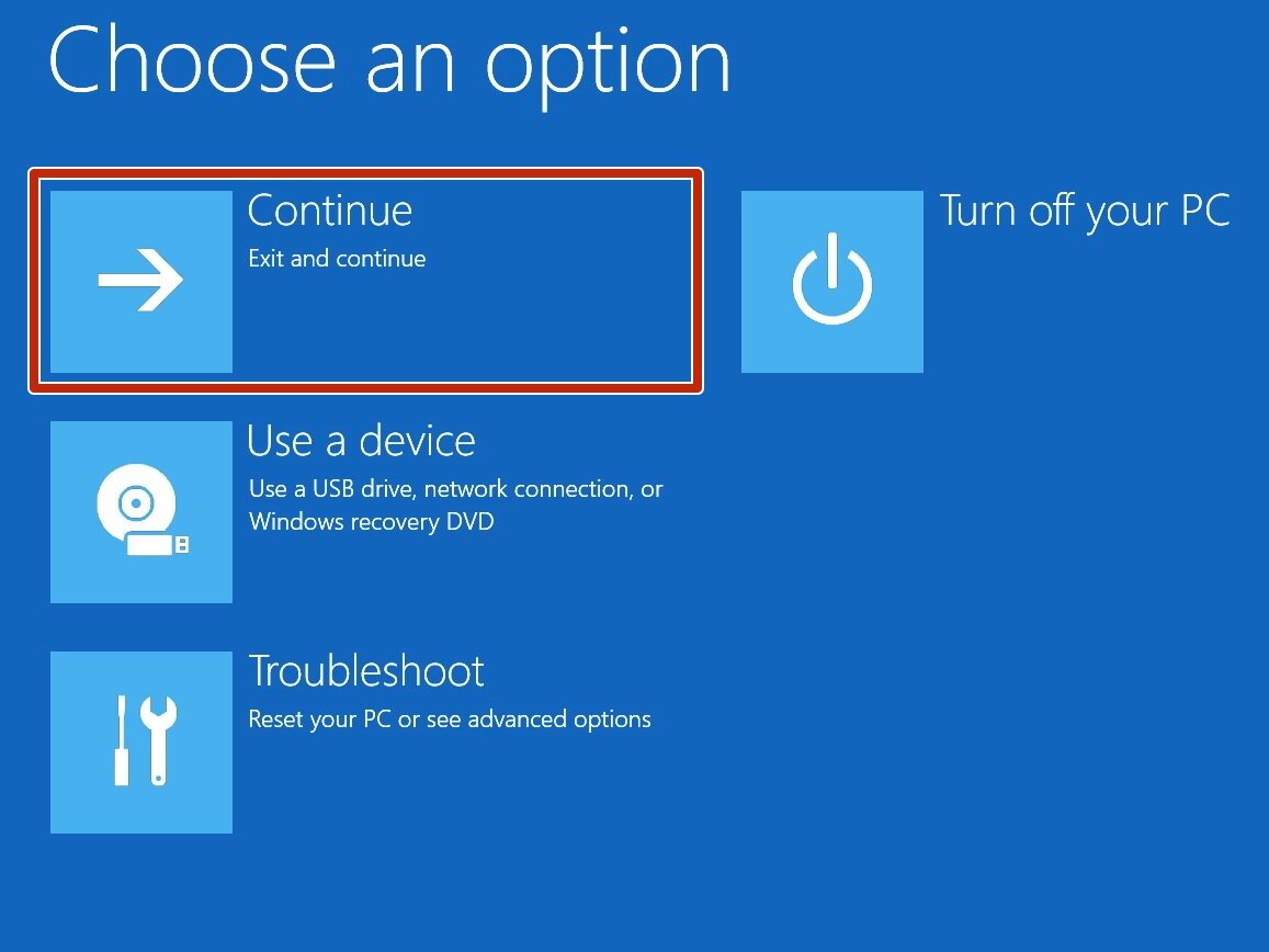

    • Open the Settings app and navigate to Update & Security → Recovery then select "Restart now" under Advanced startup.
    • You can also hold the Shift key while clicking Restart in the Start Menu.
    • In Advanced startup navigate to Use a device → UEFI: USB. This will boot the computer from the flash drive.
    • If the USB option doesn't appear in this menu, select Continue to restart the computer and try again.
