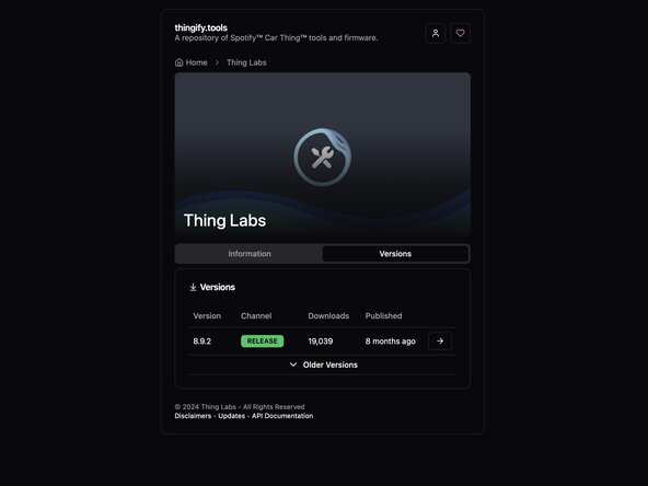

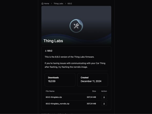

    • On your computer navigate to thingify.tools and select the right arrow for the latest release. Download the file x.x.x-thinglabs.zip.
    • Extract your downloaded zip file into an accessible location.

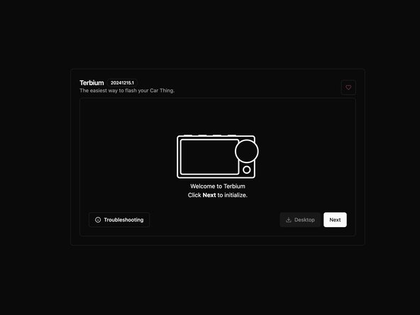

    • Once your file has been extracted navigate to the Terbium web tool.
    • Terbium requires WebUSB and a File System Access API. It is reccomended you use either Chrome, Chromium, or the Edge web browser.
