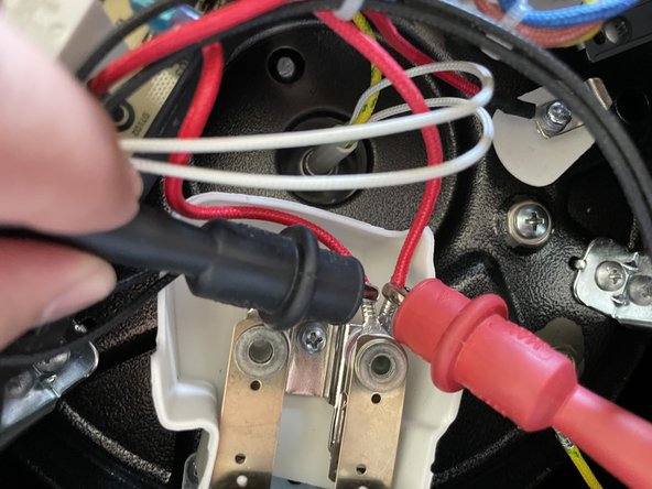

    • Attach a multimeter/ohmmeter lead to both exposed ends of the sensor wires, making sure the leads don't touch each other.
    • Test lead polarity doesn't matter for these tests.
    • Set your meter to resistance mode or continuity mode.
    • In its resting state, the pressure sensor should be continuous, which means the meter should read almost zero resistance.
    • If the meter shows a high resistance or no continuity, it could mean that the sensor contacts are dirty. Double-check your meter contacts and make sure they're grasping onto the wires.
    • Use a spudger or your finger to firmly press on the top of the sensor until it clicks.
    • The meter should change to show no continuity (0.L, in my meter's case). If it doesn't, there is a potential electrical short—the contacts may be fused, or you may need to replace the sensor.

    • If your tests suggest that you may have dirty contacts, or you suspect the contacts have fused, follow the next steps to remove the sensors to clean them.
    • Use a Phillips screwdriver to remove the screw securing the sensors to the pressure cooker.
    • This screw can be very tight. Be sure to use the right sized screwdriver to avoid stripping it.
    • Lift the sensor assembly out of its recess.
  7. How to Fix the C6 Error for a Pressure Cooker: crwdns2935265:09crwdnd2935265:01crwdnd2935265:03crwdne2935265:0 How to Fix the C6 Error for a Pressure Cooker: crwdns2935265:09crwdnd2935265:02crwdnd2935265:03crwdne2935265:0 How to Fix the C6 Error for a Pressure Cooker: crwdns2935265:09crwdnd2935265:03crwdnd2935265:03crwdne2935265:0
    • Press down on the sensor to open the contacts.
    • Use some sandpaper, a file, or electrical contact cleaner to clean the contacts. Be sure to clean both mating surfaces.

We almost had to throw some food away because the “C6 L” error in the middle of making dinner. Your instructions were clear and fixed the issue. Thanks Arthur!
Kyle P - crwdns2934203:0crwdne2934203:0 crwdns2950251:0crwdne2950251:0
Thanks for this helpful tutorial?
Abdul Kadir - crwdns2934203:0crwdne2934203:0 crwdns2950251:0crwdne2950251:0
Great and informative presentation! The pictures show exactly what to do and make everything perfectly clear. In my case, I was able to clean the contacts and the pot is back to working order. It took more time to find my multi-meter than it did to fix the problem. As a bonus, I had to look up what a “spudger” is… Now I can stop calling it that “stick thingy.” ?
Jerry Z - crwdns2934203:0crwdne2934203:0 crwdns2950251:0crwdne2950251:0
My IP-DUO80 from 2016 died with C6H. The high pressure switch didn’t click so I ordered and waiting delivery on a KS0105A dual switch. Apparently there’s another version (YCD3008) but I don’t know the difference. I saw your warning not to try calibrating the switch. Anyway, I did find a suggestion for the single high/low switch to turn the sensitivity screw clockwise/counter-clockwise as needed to adjust the high and low pressures.
Teddy Sam - crwdns2934203:0crwdne2934203:0 crwdns2950251:0crwdne2950251:0
Wow this post was just 11 hours ago. My
IP-DUO80 from 2016 died with C6H as well last night….wierd. Worked fine for years. Thanks for the part numbers. I have yet to pull the switch to see how bad the contacts are but the high pressure side definitely doesnt click when pushed. If cleaning doesn't help I will order a new switch.
