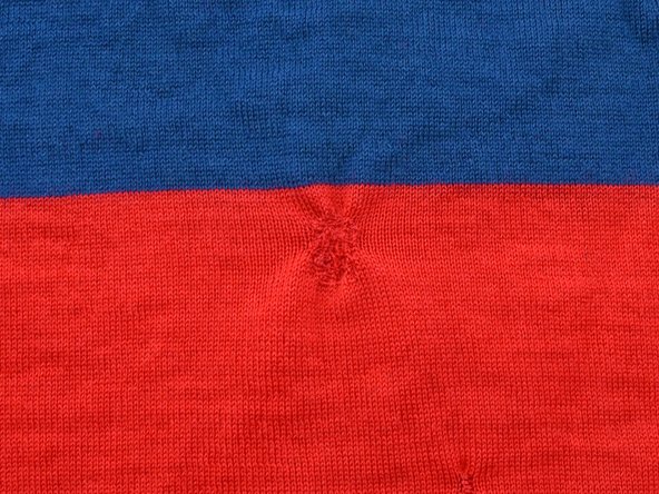

    • Inspect the damage. Clean any dirt or debris from the area.
    • Tie off any loose threads from the hole.

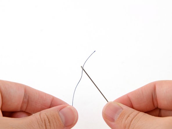

  3. How to Darn a Hole in a Knitted Garment: crwdns2935265:03crwdnd2935265:01crwdnd2935265:03crwdne2935265:0 How to Darn a Hole in a Knitted Garment: crwdns2935265:03crwdnd2935265:02crwdnd2935265:03crwdne2935265:0 How to Darn a Hole in a Knitted Garment: crwdns2935265:03crwdnd2935265:03crwdnd2935265:03crwdne2935265:0
    • Insert one end of the thread through the eye of the needle.

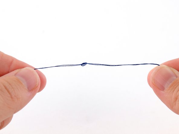

  4. How to Darn a Hole in a Knitted Garment: crwdns2935265:04crwdnd2935265:01crwdnd2935265:03crwdne2935265:0 How to Darn a Hole in a Knitted Garment: crwdns2935265:04crwdnd2935265:02crwdnd2935265:03crwdne2935265:0 How to Darn a Hole in a Knitted Garment: crwdns2935265:04crwdnd2935265:03crwdnd2935265:03crwdne2935265:0
    • Align the two ends of the thread.
    • Your needle should be threaded between these two ends.
    • Tie the ends off in an overhand knot.
    • Tie a second overhand knot to make the knot in the thread larger.

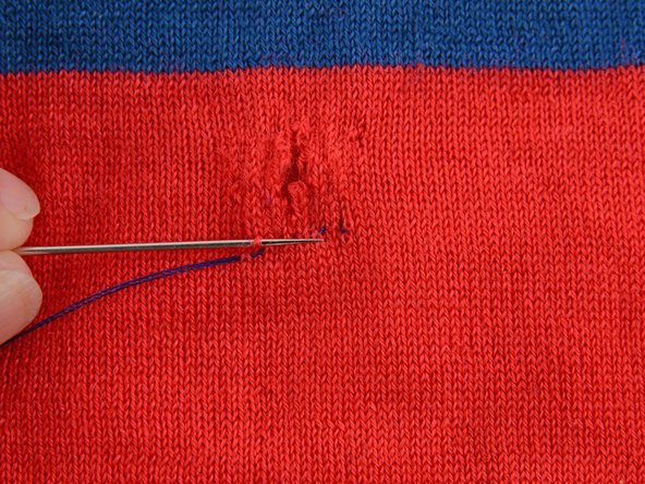

  6. How to Darn a Hole in a Knitted Garment: crwdns2935265:06crwdnd2935265:01crwdnd2935265:03crwdne2935265:0 How to Darn a Hole in a Knitted Garment: crwdns2935265:06crwdnd2935265:02crwdnd2935265:03crwdne2935265:0 How to Darn a Hole in a Knitted Garment: crwdns2935265:06crwdnd2935265:03crwdnd2935265:03crwdne2935265:0
    • Pull the needle through to the front of the garment until the thread is taut and the knot catches in the back.
    • Take a single straight stitch going into a single layer of fabric and coming back up one row of the knit closer to the hole.
  7. How to Darn a Hole in a Knitted Garment: crwdns2935265:07crwdnd2935265:01crwdnd2935265:02crwdne2935265:0 How to Darn a Hole in a Knitted Garment: crwdns2935265:07crwdnd2935265:02crwdnd2935265:02crwdne2935265:0
    • Pull the needle through until the thread is taut, but not scrunching or gathering the fabric.
  8. How to Darn a Hole in a Knitted Garment: crwdns2935265:08crwdnd2935265:01crwdnd2935265:03crwdne2935265:0 How to Darn a Hole in a Knitted Garment: crwdns2935265:08crwdnd2935265:02crwdnd2935265:03crwdne2935265:0 How to Darn a Hole in a Knitted Garment: crwdns2935265:08crwdnd2935265:03crwdnd2935265:03crwdne2935265:0
    • Take another straight stitch towards the hole, going in and out of a single layer of the garment, passing the thread under a single row of the knit.
    • Try to work perpendicular to the grain of the knit, creating a straight row of stitches.
    • Pull the needle through until the thread is taut, but not pulling or scrunching the fabric.
  9. How to Darn a Hole in a Knitted Garment: crwdns2935265:09crwdnd2935265:01crwdnd2935265:01crwdne2935265:0
    • Continue working across the hole taking stitches under every other row of the knit.
    • This photo illustrates how the needle should go under every other row of stitches. If you are new to sewing, it is better to take one stitch at a time.
    • When you get about a centimeter past the hole, pull the needle through until the thread is taut, but not gathering or scrunching the fabric.

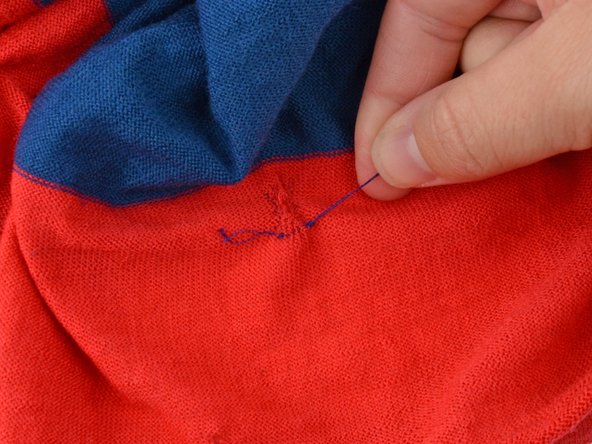

  13. How to Darn a Hole in a Knitted Garment: crwdns2935265:013crwdnd2935265:01crwdnd2935265:02crwdne2935265:0 How to Darn a Hole in a Knitted Garment: crwdns2935265:013crwdnd2935265:02crwdnd2935265:02crwdne2935265:0
    • When you have finished sewing rows, take the needle and insert it across the top corner of your stitching at a forty-five degree angle, taking a stitch.
    • As you begin to pull the needle through you will see a loop form. Catch the loop with your finger.
    • Do not pull the thread taut yet.

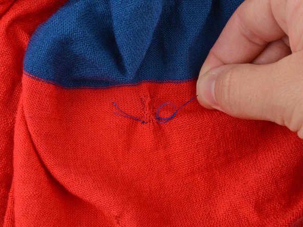

  14. How to Darn a Hole in a Knitted Garment: crwdns2935265:014crwdnd2935265:01crwdnd2935265:02crwdne2935265:0 How to Darn a Hole in a Knitted Garment: crwdns2935265:014crwdnd2935265:02crwdnd2935265:02crwdne2935265:0
    • Insert the needle into the loop.
    • Pull the needle through the loop.

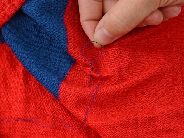

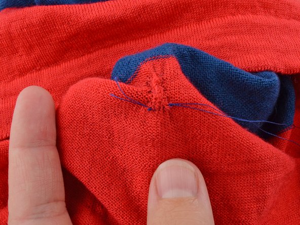

  22. How to Darn a Hole in a Knitted Garment: crwdns2935265:022crwdnd2935265:01crwdnd2935265:03crwdne2935265:0 How to Darn a Hole in a Knitted Garment: crwdns2935265:022crwdnd2935265:02crwdnd2935265:03crwdne2935265:0 How to Darn a Hole in a Knitted Garment: crwdns2935265:022crwdnd2935265:03crwdnd2935265:03crwdne2935265:0
    • On the backside, take a small stitch very close to where the needle came through.
    • Slowly pull the needle through the fabric, creating a loop.
    • Catch the loop in your fingers.
    • Put the needle through the loop.
  23. How to Darn a Hole in a Knitted Garment: crwdns2935265:023crwdnd2935265:01crwdnd2935265:03crwdne2935265:0 How to Darn a Hole in a Knitted Garment: crwdns2935265:023crwdnd2935265:02crwdnd2935265:03crwdne2935265:0 How to Darn a Hole in a Knitted Garment: crwdns2935265:023crwdnd2935265:03crwdnd2935265:03crwdne2935265:0
    • Pull the needle through the loop, creating a knot.
    • Pull the thread taut, tightening the knot.
