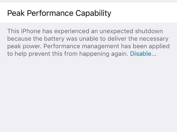

  5. How to Check Your iPhone's Battery Health: crwdns2935265:05crwdnd2935265:01crwdnd2935265:03crwdne2935265:0 How to Check Your iPhone's Battery Health: crwdns2935265:05crwdnd2935265:02crwdnd2935265:03crwdne2935265:0 How to Check Your iPhone's Battery Health: crwdns2935265:05crwdnd2935265:03crwdnd2935265:03crwdne2935265:0
    • Peak Performance Capability tells you whether your battery can still supply sufficient power for the iPhone's most intense processing tasks. Normal peak performance is what you're aiming for.
    • If it says your iPhone has experienced an expected shutdown, that means your battery couldn't supply the needed power quickly enough, and the system shut down as a result.
    • Your iPhone will throttle its own performance—slowing itself down—in order to prevent further unexpected shutdowns. This can be disabled to manually enable peak performance.
    • Once you disable performance management, you cannot enable it again. It is automatically enabled after an unexpected shutdown.
    • Once your battery falls below a specific threshold (typically 80%), you will be notified that your battery's health is significantly degraded.
