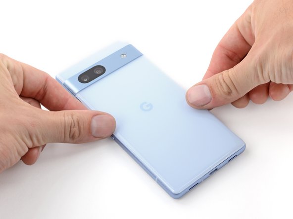

How to Apply Rear Cover Adhesive in Your Google Pixel 7a
  1. How to Apply Rear Cover Adhesive in Your Google Pixel 7a, Remove the old adhesive from the frame: crwdns2935265:01crwdnd2935265:01crwdnd2935265:03crwdne2935265:0 How to Apply Rear Cover Adhesive in Your Google Pixel 7a, Remove the old adhesive from the frame: crwdns2935265:01crwdnd2935265:02crwdnd2935265:03crwdne2935265:0 How to Apply Rear Cover Adhesive in Your Google Pixel 7a, Remove the old adhesive from the frame: crwdns2935265:01crwdnd2935265:03crwdnd2935265:03crwdne2935265:0

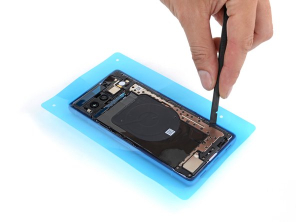

    • Use the point of a spudger to scrape up an edge of the rear cover adhesive from the frame until you have a large enough clump to grab on to.
    • Use tweezers or your fingers to peel the adhesive from the entire perimeter of the frame.
    • Remove the adhesive from the antenna housing.

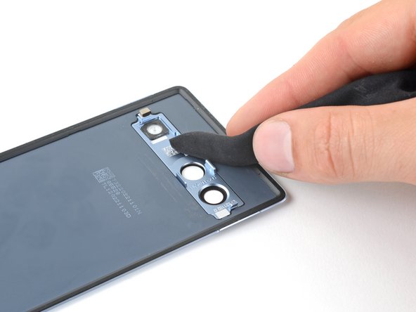

  2. How to Apply Rear Cover Adhesive in Your Google Pixel 7a, Remove the old adhesive from the rear cover: crwdns2935265:02crwdnd2935265:01crwdnd2935265:03crwdne2935265:0 How to Apply Rear Cover Adhesive in Your Google Pixel 7a, Remove the old adhesive from the rear cover: crwdns2935265:02crwdnd2935265:02crwdnd2935265:03crwdne2935265:0 How to Apply Rear Cover Adhesive in Your Google Pixel 7a, Remove the old adhesive from the rear cover: crwdns2935265:02crwdnd2935265:03crwdnd2935265:03crwdne2935265:0
    • Be careful not to touch the lens covers on your rear cover. If they're dirty, wipe them with a clean and dry microfiber cloth.
    • If you're reusing your rear cover, remove any old adhesive:
    • If necessary, soften the adhesive near the camera bar with a heated iOpener or hair dryer.
    • Use your finger to roll the adhesive strips until you can grab them.
    • Peel the adhesive strips from the rear cover.

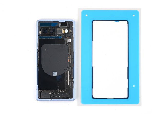

  3. How to Apply Rear Cover Adhesive in Your Google Pixel 7a, Clean the frame and rear cover: crwdns2935265:03crwdnd2935265:01crwdnd2935265:03crwdne2935265:0 How to Apply Rear Cover Adhesive in Your Google Pixel 7a, Clean the frame and rear cover: crwdns2935265:03crwdnd2935265:02crwdnd2935265:03crwdne2935265:0 How to Apply Rear Cover Adhesive in Your Google Pixel 7a, Clean the frame and rear cover: crwdns2935265:03crwdnd2935265:03crwdnd2935265:03crwdne2935265:0
    • Use a pipette or syringe to apply a few drops of highly-concentrated isopropyl alcohol (over 90%) to the perimeter of the frame and the antenna housing.
    • Wipe any adhesive residue away using a microfiber or lint-free cloth.
    • If you're reusing your rear cover, clean it just as you did the frame.

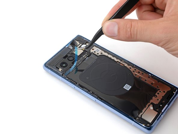

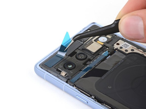

  4. How to Apply Rear Cover Adhesive in Your Google Pixel 7a, Apply the lower rear cover adhesive: crwdns2935265:04crwdnd2935265:01crwdnd2935265:02crwdne2935265:0 How to Apply Rear Cover Adhesive in Your Google Pixel 7a, Apply the lower rear cover adhesive: crwdns2935265:04crwdnd2935265:02crwdnd2935265:02crwdne2935265:0
    • If you have a new rear cover, your part may come with the lower and top rear cover adhesive pre-installed and you can skip down two steps to apply the perimeter adhesive.
    • Remove the long, thin strip of rear cover adhesive from its liner.
    • Place the adhesive onto the logic board cover, just below the rear cameras.

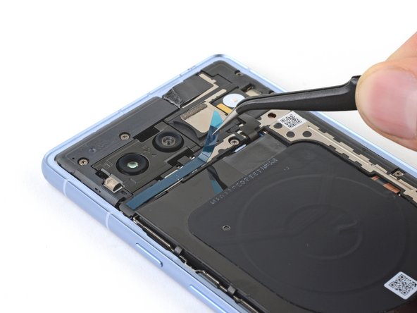

  5. How to Apply Rear Cover Adhesive in Your Google Pixel 7a, Apply the top rear cover adhesive: crwdns2935265:05crwdnd2935265:01crwdnd2935265:02crwdne2935265:0 How to Apply Rear Cover Adhesive in Your Google Pixel 7a, Apply the top rear cover adhesive: crwdns2935265:05crwdnd2935265:02crwdnd2935265:02crwdne2935265:0
    • Peel the short, wide strip of rear cover adhesive from its liner.
    • Place the adhesive onto the antenna housing, just above the rear cameras.

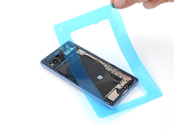

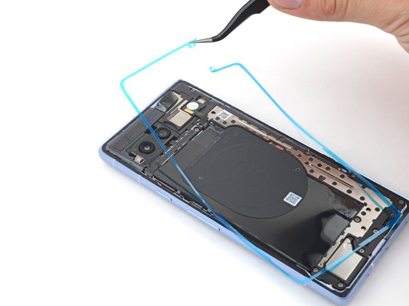

  6. How to Apply Rear Cover Adhesive in Your Google Pixel 7a, Orient the rear cover perimeter adhesive: crwdns2935265:06crwdnd2935265:01crwdnd2935265:03crwdne2935265:0 How to Apply Rear Cover Adhesive in Your Google Pixel 7a, Orient the rear cover perimeter adhesive: crwdns2935265:06crwdnd2935265:02crwdnd2935265:03crwdne2935265:0 How to Apply Rear Cover Adhesive in Your Google Pixel 7a, Orient the rear cover perimeter adhesive: crwdns2935265:06crwdnd2935265:03crwdnd2935265:03crwdne2935265:0

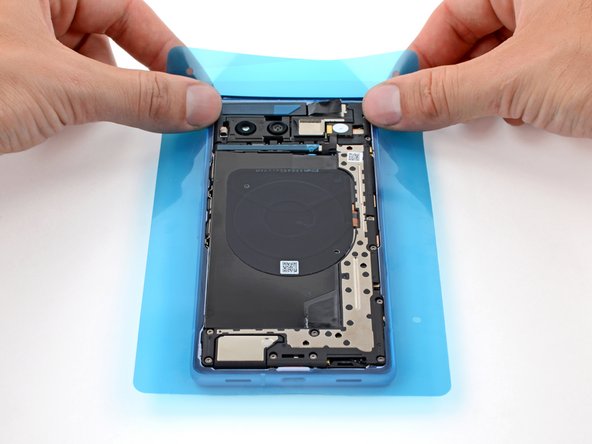

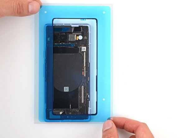

    • Before installing new adhesive, it's helpful to make sure both the phone and adhesive sheet are aligned and ready to go.
    • Orient your replacement adhesive over the frame so that its pull tabs are in the upper right corner.
  7. How to Apply Rear Cover Adhesive in Your Google Pixel 7a, Apply the perimeter adhesive: crwdns2935265:07crwdnd2935265:01crwdnd2935265:03crwdne2935265:0 How to Apply Rear Cover Adhesive in Your Google Pixel 7a, Apply the perimeter adhesive: crwdns2935265:07crwdnd2935265:02crwdnd2935265:03crwdne2935265:0 How to Apply Rear Cover Adhesive in Your Google Pixel 7a, Apply the perimeter adhesive: crwdns2935265:07crwdnd2935265:03crwdnd2935265:03crwdne2935265:0
    • The perimeter adhesive is difficult to align and can't be adjusted after it adheres. Work slowly and make sure the edges stay lined up with the frame as you go.

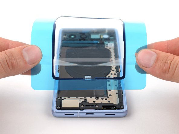

    • Peel the bottom edge of the rear cover perimeter adhesive from its liner. Leave the rest of the liner in place to protect it while you lay the adhesive down.
    • Hold the large liner out of the way and align the bottom edge of the adhesive with the frame.
    • Press the bottom edge of the adhesive into place.

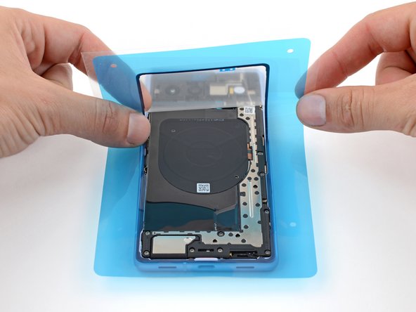

  8. How to Apply Rear Cover Adhesive in Your Google Pixel 7a: crwdns2935265:08crwdnd2935265:01crwdnd2935265:03crwdne2935265:0 How to Apply Rear Cover Adhesive in Your Google Pixel 7a: crwdns2935265:08crwdnd2935265:02crwdnd2935265:03crwdne2935265:0 How to Apply Rear Cover Adhesive in Your Google Pixel 7a: crwdns2935265:08crwdnd2935265:03crwdnd2935265:03crwdne2935265:0

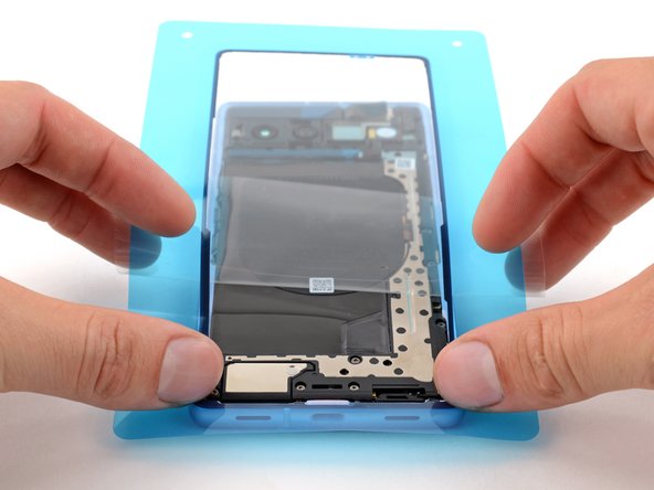

    • Slowly peel the large liner from the adhesive and work up the frame, laying the long edges of the adhesive into place as you go.
    • Before placing the top edge of the adhesive, fully remove the liner.
    • The adhesive may stretch or compress before reaching the top edge. Adjust it to fit the top edge if it comes out of alignment.
    • Press the top edge of the adhesive into place.

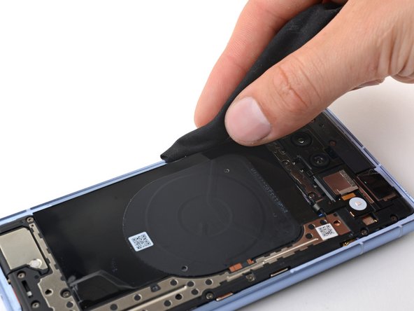

  9. How to Apply Rear Cover Adhesive in Your Google Pixel 7a, Secure the adhesive: crwdns2935265:09crwdnd2935265:01crwdnd2935265:03crwdne2935265:0 How to Apply Rear Cover Adhesive in Your Google Pixel 7a, Secure the adhesive: crwdns2935265:09crwdnd2935265:02crwdnd2935265:03crwdne2935265:0 How to Apply Rear Cover Adhesive in Your Google Pixel 7a, Secure the adhesive: crwdns2935265:09crwdnd2935265:03crwdnd2935265:03crwdne2935265:0
    • Use the flat end of your spudger to press around the entire perimeter of the adhesive to strengthen its bond to the frame.
    • Peel the large blue adhesive liner from the frame.

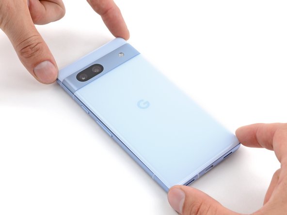

  11. How to Apply Rear Cover Adhesive in Your Google Pixel 7a, Install the rear cover: crwdns2935265:011crwdnd2935265:01crwdnd2935265:03crwdne2935265:0 How to Apply Rear Cover Adhesive in Your Google Pixel 7a, Install the rear cover: crwdns2935265:011crwdnd2935265:02crwdnd2935265:03crwdne2935265:0 How to Apply Rear Cover Adhesive in Your Google Pixel 7a, Install the rear cover: crwdns2935265:011crwdnd2935265:03crwdnd2935265:03crwdne2935265:0
    • Align the rear cover over the frame and press it into place.
    • Firmly press around the perimeter of the rear cover to secure it.
    • To further strengthen the adhesive bond, lightly heat it with a hair dryer or heat gun before pressing around the rear cover's perimeter.
