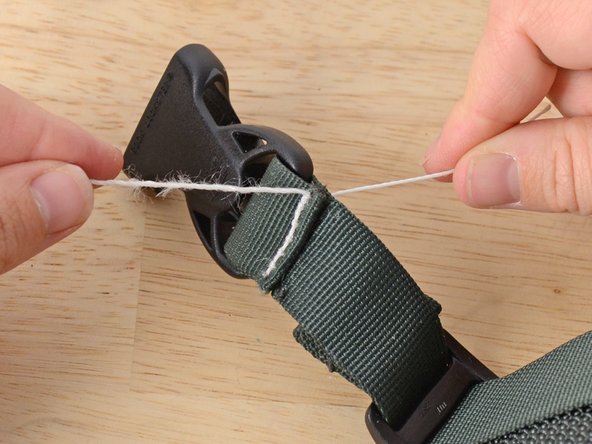

  3. How To Sew With An Awl: crwdns2935265:03crwdnd2935265:01crwdnd2935265:02crwdne2935265:0 How To Sew With An Awl: crwdns2935265:03crwdnd2935265:02crwdnd2935265:02crwdne2935265:0
    • Thread the needle with very thick thread.
    • Align your material. In this case we are resewing the webbing holding a buckle in place.

  7. How To Sew With An Awl: crwdns2935265:07crwdnd2935265:01crwdnd2935265:03crwdne2935265:0 How To Sew With An Awl: crwdns2935265:07crwdnd2935265:02crwdnd2935265:03crwdne2935265:0 How To Sew With An Awl: crwdns2935265:07crwdnd2935265:03crwdnd2935265:03crwdne2935265:0
    • Pull the thread from the eye of the needle, creating a loop.
    • Put the short, free end of the thread through the loop you just created in the thread.
  8. How To Sew With An Awl: crwdns2935265:08crwdnd2935265:01crwdnd2935265:02crwdne2935265:0 How To Sew With An Awl: crwdns2935265:08crwdnd2935265:02crwdnd2935265:02crwdne2935265:0
    • Holding the short, free end of the thread taught, pull the awl back out through the material.
    • Pull both ends of the thread taught.
  9. How To Sew With An Awl: crwdns2935265:09crwdnd2935265:01crwdnd2935265:03crwdne2935265:0 How To Sew With An Awl: crwdns2935265:09crwdnd2935265:02crwdnd2935265:03crwdne2935265:0 How To Sew With An Awl: crwdns2935265:09crwdnd2935265:03crwdnd2935265:03crwdne2935265:0
    • Continue reinserting the awl, creating a loop of thread from the eye of the needle, threading the short, free end, and removing the awl to create your stitches.
    • While you are getting the hang of it, refer back to steps 6-9 of this guide.
