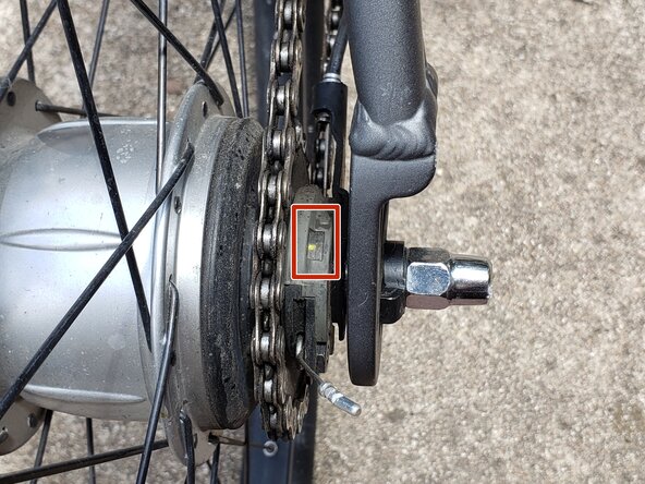

    • Set the gearing to the 4th position on your shifter.
  2. How To Adjust Shimano Nexus 8-Speed Internal Gear Hub (SG-8R20): crwdns2935265:02crwdnd2935265:01crwdnd2935265:02crwdne2935265:0 How To Adjust Shimano Nexus 8-Speed Internal Gear Hub (SG-8R20): crwdns2935265:02crwdnd2935265:02crwdnd2935265:02crwdne2935265:0
    • Locate the alignment indicators on the right side (chain side) of the gear hub.
    • If you see two alignment indicators already aligned, your bike is already perfectly tuned!
    • If you can only see one indicator (as in picture 1), then your shifting is far out of alignment.
    • Flip the bike and check the underside indicator.
    • If the indicator closer the the wheel is further from the front of the bike, tighten the cable.
    • If you can see two indicators in the window or the underside indicators are within a quarter inch of each other, then skip to Step 5.
