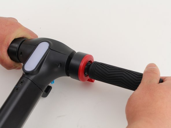

    • Unscrew the scooter handle.
    • The scooter handles are left-handed or reverse threaded, so twist clockwise to remove them.

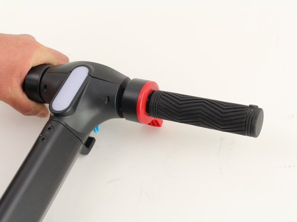

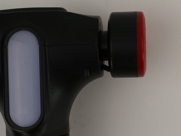

  2. Hover-1 Eagle Throttle/Brake Lever Replacement: crwdns2935265:02crwdnd2935265:01crwdnd2935265:03crwdne2935265:0 Hover-1 Eagle Throttle/Brake Lever Replacement: crwdns2935265:02crwdnd2935265:02crwdnd2935265:03crwdne2935265:0 Hover-1 Eagle Throttle/Brake Lever Replacement: crwdns2935265:02crwdnd2935265:03crwdnd2935265:03crwdne2935265:0
    • Push back the fastening clips by wedging the plastic spudger between the clip and the throttle handle.
    • Insert iFixit opening picks between each fastening clip and the throttle handle to prevent re-fastening.
    • Pull the throttle lever off gently by pulling towards you.
    • The spring housed in the handle can sometimes send the lever flying. Maintain a firm grip on the throttle lever.

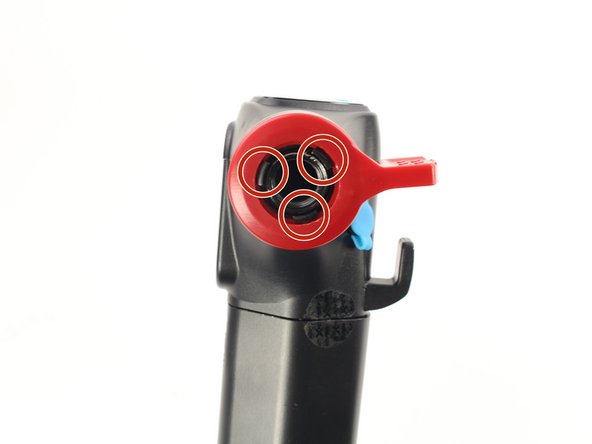

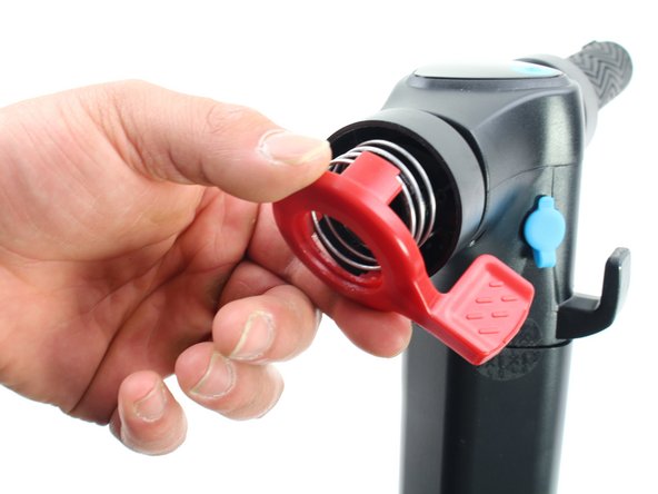

  3. Hover-1 Eagle Throttle/Brake Lever Replacement: crwdns2935265:03crwdnd2935265:01crwdnd2935265:03crwdne2935265:0 Hover-1 Eagle Throttle/Brake Lever Replacement: crwdns2935265:03crwdnd2935265:02crwdnd2935265:03crwdne2935265:0 Hover-1 Eagle Throttle/Brake Lever Replacement: crwdns2935265:03crwdnd2935265:03crwdnd2935265:03crwdne2935265:0
    • To reassemble, insert the spring into the placement hole, housed inside the throttle handle. Insert the other end of the spring into the placement hole inside the throttle body housing.
  4. Hover-1 Eagle Throttle/Brake Lever Replacement: crwdns2935265:04crwdnd2935265:01crwdnd2935265:03crwdne2935265:0 Hover-1 Eagle Throttle/Brake Lever Replacement: crwdns2935265:04crwdnd2935265:02crwdnd2935265:03crwdne2935265:0 Hover-1 Eagle Throttle/Brake Lever Replacement: crwdns2935265:04crwdnd2935265:03crwdnd2935265:03crwdne2935265:0
    • Twist the throttle lever back to its original orientation by rotating it to the left.
    • Apply pressure to the throttle handle until you hear the fastening clips take hold the of the throttle lever.
    • Make sure the throttle lever is fully inserted and flush with the display throttle body.

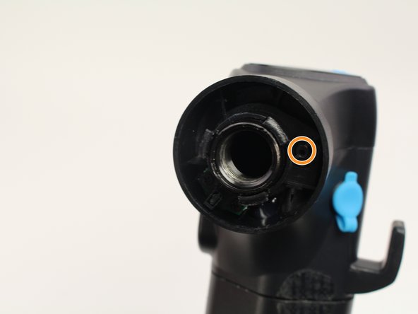

  5. Hover-1 Eagle Throttle/Brake Lever Replacement: crwdns2935265:05crwdnd2935265:01crwdnd2935265:03crwdne2935265:0 Hover-1 Eagle Throttle/Brake Lever Replacement: crwdns2935265:05crwdnd2935265:02crwdnd2935265:03crwdne2935265:0 Hover-1 Eagle Throttle/Brake Lever Replacement: crwdns2935265:05crwdnd2935265:03crwdnd2935265:03crwdne2935265:0
    • Reattach the scooter handle.
    • Make sure to twist the handles counterclockwise to tighten.

I cant squeeze the spudger and the pick between this and the spudger broke…what the!!!
