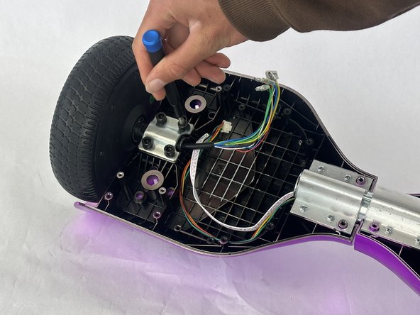

  6. Hover-1 All Star Wheel Replacement, Mainboard: crwdns2935265:06crwdnd2935265:01crwdnd2935265:01crwdne2935265:0
    • Remove the four Phillips #1 screws that secure the mainboard.
  7. Hover-1 All Star Wheel Replacement: crwdns2935265:07crwdnd2935265:01crwdnd2935265:01crwdne2935265:0
    • Disconnect all cables connected to the mainboard.
    • Also disconnect the three colored cables by pulling them apart.
  8. Hover-1 All Star Wheel Replacement: crwdns2935265:08crwdnd2935265:01crwdnd2935265:02crwdne2935265:0 Hover-1 All Star Wheel Replacement: crwdns2935265:08crwdnd2935265:02crwdnd2935265:02crwdne2935265:0
    • Lift the mainboard up and out.
  9. Hover-1 All Star Wheel Replacement, Wheel: crwdns2935265:09crwdnd2935265:01crwdnd2935265:02crwdne2935265:0 Hover-1 All Star Wheel Replacement, Wheel: crwdns2935265:09crwdnd2935265:02crwdnd2935265:02crwdne2935265:0
    • Remove the four 5 mm hex bolts that secure the wheel.
  10. Hover-1 All Star Wheel Replacement: crwdns2935265:010crwdnd2935265:01crwdnd2935265:01crwdne2935265:0
    • Remove the wheel assembly.
