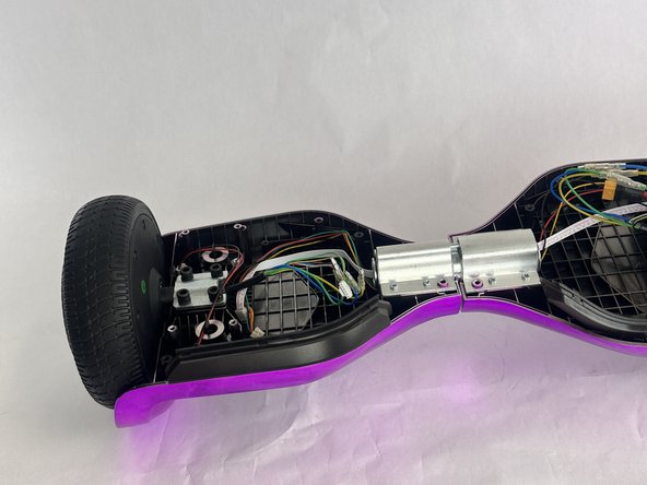

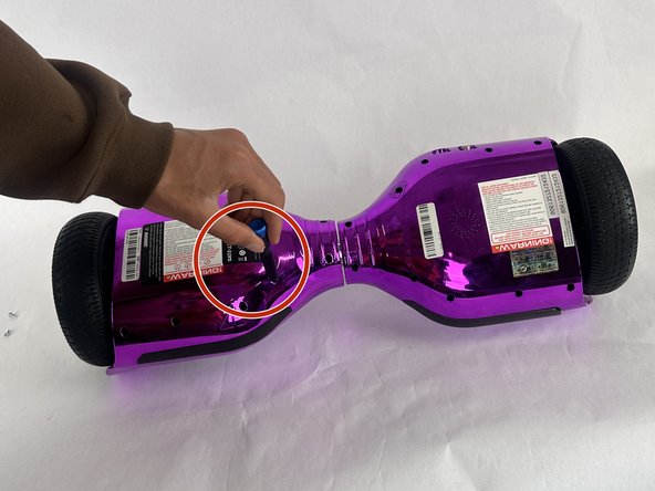

    • Turn the hoverboard upside down and remove the twenty Phillips #1 screws that secure the casing.
  2. Hover-1 All Star Rubber Pedal Replacement: crwdns2935265:02crwdnd2935265:01crwdnd2935265:02crwdne2935265:0 Hover-1 All Star Rubber Pedal Replacement: crwdns2935265:02crwdnd2935265:02crwdnd2935265:02crwdne2935265:0
    • After all the screws are removed simply pull off the bottom part of the casing in two pieces (Right and Left).

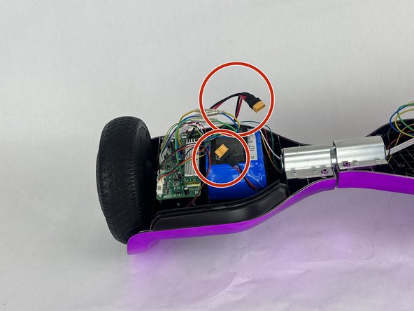

  3. Hover-1 All Star Rubber Pedal Replacement, Battery: crwdns2935265:03crwdnd2935265:01crwdnd2935265:02crwdne2935265:0 Hover-1 All Star Rubber Pedal Replacement, Battery: crwdns2935265:03crwdnd2935265:02crwdnd2935265:02crwdne2935265:0
    • Disconnect the battery from the circuit board via the orange connector.

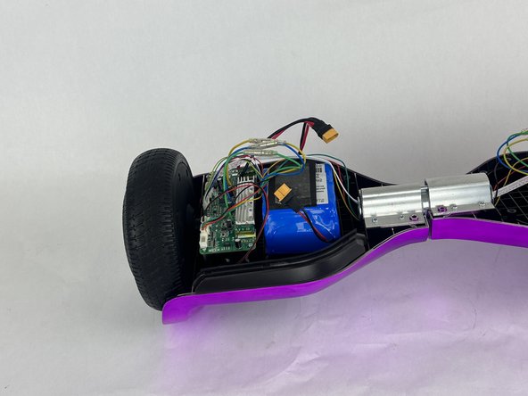

  4. Hover-1 All Star Rubber Pedal Replacement: crwdns2935265:04crwdnd2935265:01crwdnd2935265:02crwdne2935265:0 Hover-1 All Star Rubber Pedal Replacement: crwdns2935265:04crwdnd2935265:02crwdnd2935265:02crwdne2935265:0
    • Remove the four small screws that secures the plastic battery bracket with a Phillips #1 screwdriver.
    • Remove the plastic bracket.
    • Once the plastic restraint is removed the battery will have nothing else holding it in but a piece of double sided tape on the bottom.

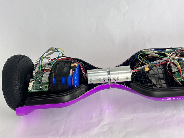

  5. Hover-1 All Star Rubber Pedal Replacement: crwdns2935265:05crwdnd2935265:01crwdnd2935265:01crwdne2935265:0
    • Remove the battery.
    • This step will likely require you to use the plastic prying tool because the tape is very strong.

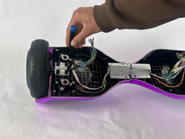

  9. Hover-1 All Star Rubber Pedal Replacement, Rubber Pedal: crwdns2935265:09crwdnd2935265:01crwdnd2935265:02crwdne2935265:0 Hover-1 All Star Rubber Pedal Replacement, Rubber Pedal: crwdns2935265:09crwdnd2935265:02crwdnd2935265:02crwdne2935265:0
    • Remove the six screws with a Phillips #1 screwdriver.
  10. Hover-1 All Star Rubber Pedal Replacement: crwdns2935265:010crwdnd2935265:01crwdnd2935265:01crwdne2935265:0
    • Flip over the hoverboard and remove the rubber pedal.
    • There will be 2 small springs located here (blue arrows) that will come out with the pedal.
