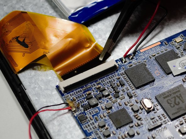

    4. Hott T725-8G Screen/Display Replacement: crwdns2935265:04crwdnd2935265:01crwdnd2935265:02crwdne2935265:0 Hott T725-8G Screen/Display Replacement: crwdns2935265:04crwdnd2935265:02crwdnd2935265:02crwdne2935265:0
      • Use a pair of Precision Tweezers to squeeze the clip of the ribbon wire to release it.

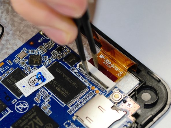

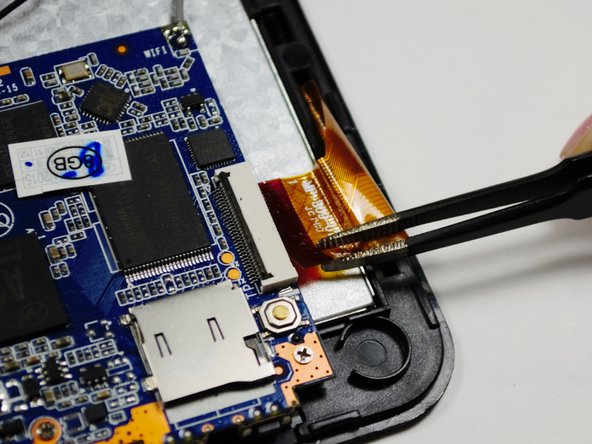

    5. Hott T725-8G Screen/Display Replacement: crwdns2935265:05crwdnd2935265:01crwdnd2935265:03crwdne2935265:0 Hott T725-8G Screen/Display Replacement: crwdns2935265:05crwdnd2935265:02crwdnd2935265:03crwdne2935265:0 Hott T725-8G Screen/Display Replacement: crwdns2935265:05crwdnd2935265:03crwdnd2935265:03crwdne2935265:0
      • Using a pair of the Precision Tweezers, remove the ribbon wire from the clip.
