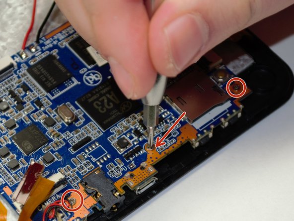

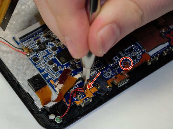

  3. Hott T725-8G Motherboard Replacement: crwdns2935265:03crwdnd2935265:01crwdnd2935265:03crwdne2935265:0 Hott T725-8G Motherboard Replacement: crwdns2935265:03crwdnd2935265:02crwdnd2935265:03crwdne2935265:0 Hott T725-8G Motherboard Replacement: crwdns2935265:03crwdnd2935265:03crwdnd2935265:03crwdne2935265:0
    • Use the #000 Phillips screw driver to remove all three 2.2mm screws attached to the mother board.
You are now able to remove the motherboard.
