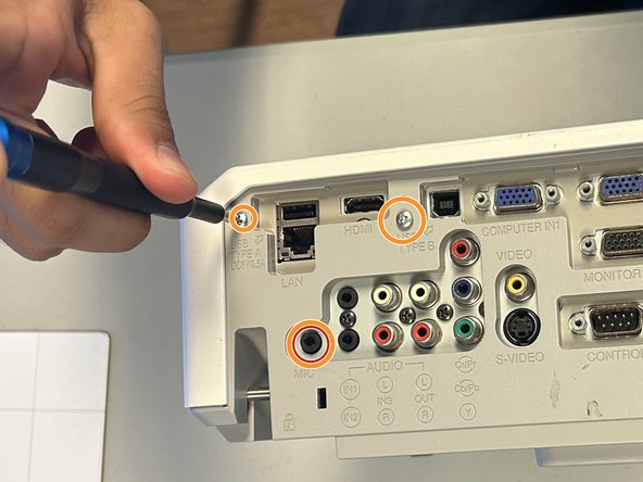

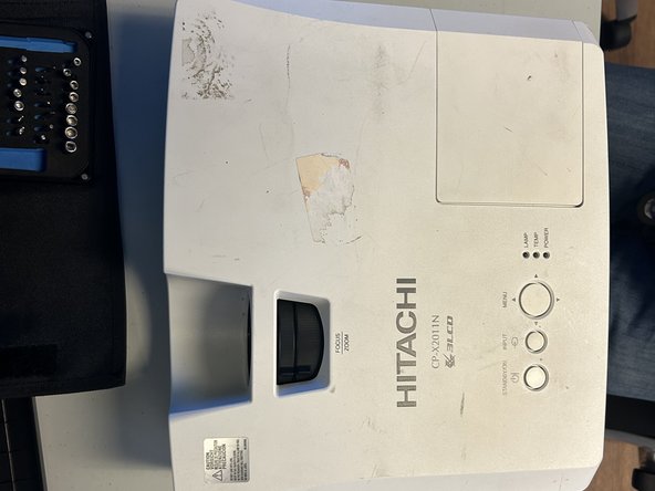

    • Orient the projector with the underside facing up and remove all nine 11.5 mm screws with a Phillips #00 screwdriver.
    • On the outlet area on the rear of the device, remove all three 11.5 mm screws with a Phillips #00 screwdriver.
    • Carefully remove the cover using your hands.

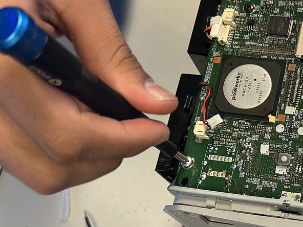

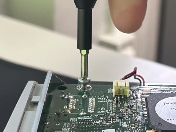

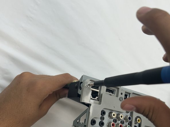

    • Remove all four 10.47 mm screws holding the motherboard in place with a Phillips #00 screwdriver.

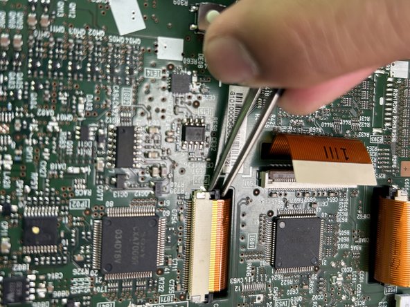

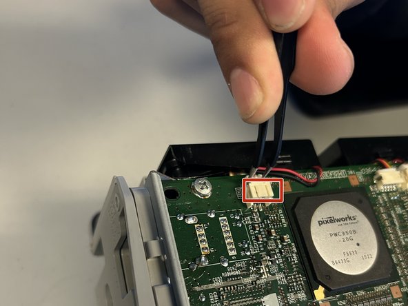

  3. Hitachi CP-X2011N Speakers Replacement: crwdns2935265:03crwdnd2935265:01crwdnd2935265:03crwdne2935265:0 Hitachi CP-X2011N Speakers Replacement: crwdns2935265:03crwdnd2935265:02crwdnd2935265:03crwdne2935265:0 Hitachi CP-X2011N Speakers Replacement: crwdns2935265:03crwdnd2935265:03crwdnd2935265:03crwdne2935265:0
    • Carefully disconnect all seven ribbon cables and wire connections from the motherboard using tweezers.
  4. Hitachi CP-X2011N Speakers Replacement: crwdns2935265:04crwdnd2935265:01crwdnd2935265:01crwdne2935265:0
    • Carefully remove the motherboard from the projector.
  5. Hitachi CP-X2011N Speakers Replacement: crwdns2935265:05crwdnd2935265:01crwdnd2935265:03crwdne2935265:0 Hitachi CP-X2011N Speakers Replacement: crwdns2935265:05crwdnd2935265:02crwdnd2935265:03crwdne2935265:0 Hitachi CP-X2011N Speakers Replacement: crwdns2935265:05crwdnd2935265:03crwdnd2935265:03crwdne2935265:0

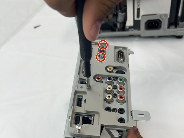

    • Remove all jack standoff screws to detach the ports from the cover using a Phillips #00 screwdriver.
  6. Hitachi CP-X2011N Speakers Replacement: crwdns2935265:06crwdnd2935265:01crwdnd2935265:01crwdne2935265:0
    • Remove the motherboard.

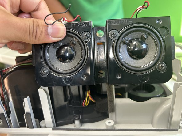

  7. Hitachi CP-X2011N Speakers Replacement, Speakers: crwdns2935265:07crwdnd2935265:01crwdnd2935265:02crwdne2935265:0 Hitachi CP-X2011N Speakers Replacement, Speakers: crwdns2935265:07crwdnd2935265:02crwdnd2935265:02crwdne2935265:0
    • Lift the speakers up and out of their housing.
