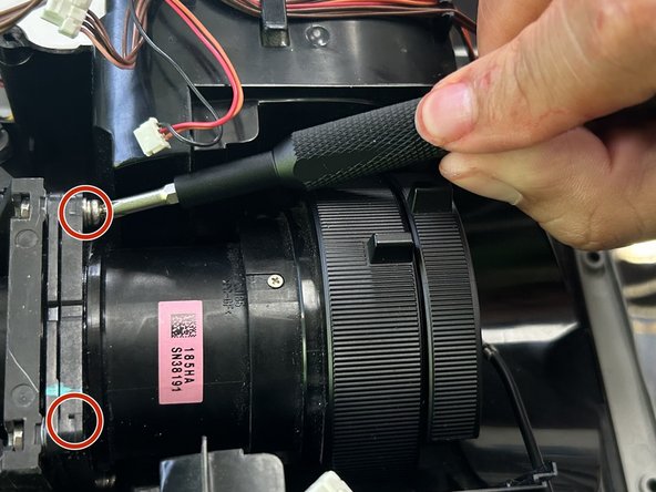

  7. Hitachi CP-X2011N Lens Replacement, Lens: crwdns2935265:07crwdnd2935265:01crwdnd2935265:02crwdne2935265:0 Hitachi CP-X2011N Lens Replacement, Lens: crwdns2935265:07crwdnd2935265:02crwdnd2935265:02crwdne2935265:0
    • Unscrew the two 6 mm screws securing the lens with a a Phillips #00 screwdriver.
  8. Hitachi CP-X2011N Lens Replacement: crwdns2935265:08crwdnd2935265:01crwdnd2935265:01crwdne2935265:0
    • Unscrew the bottom two 6 mm screws securing the projector with a Phillips #00 screwdriver.
