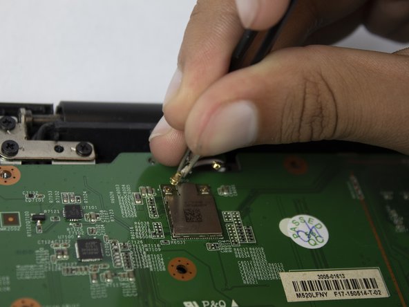

  7. Hisense Chromebook C11 Hard Drive Replacement, Hard Drive: crwdns2935265:07crwdnd2935265:01crwdnd2935265:02crwdne2935265:0 Hisense Chromebook C11 Hard Drive Replacement, Hard Drive: crwdns2935265:07crwdnd2935265:02crwdnd2935265:02crwdne2935265:0
    • Unscrew all of the screws that you can access on the hard drive.
    • If you cannot reach the screw beneath the black strip, move on to the next step.

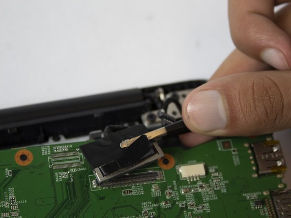

  8. Hisense Chromebook C11 Hard Drive Replacement: crwdns2935265:08crwdnd2935265:01crwdnd2935265:03crwdne2935265:0 Hisense Chromebook C11 Hard Drive Replacement: crwdns2935265:08crwdnd2935265:02crwdnd2935265:03crwdne2935265:0 Hisense Chromebook C11 Hard Drive Replacement: crwdns2935265:08crwdnd2935265:03crwdnd2935265:03crwdne2935265:0
    • Remove the black strip using the tweezers.

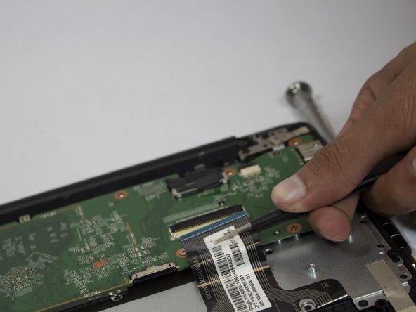

  10. Hisense Chromebook C11 Hard Drive Replacement: crwdns2935265:010crwdnd2935265:01crwdnd2935265:02crwdne2935265:0 Hisense Chromebook C11 Hard Drive Replacement: crwdns2935265:010crwdnd2935265:02crwdnd2935265:02crwdne2935265:0
    • Remove the ribbon with the tweezers.

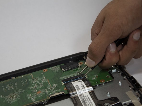

  11. Hisense Chromebook C11 Hard Drive Replacement: crwdns2935265:011crwdnd2935265:01crwdnd2935265:02crwdne2935265:0 Hisense Chromebook C11 Hard Drive Replacement: crwdns2935265:011crwdnd2935265:02crwdnd2935265:02crwdne2935265:0
    • Using the tweezers, carefully remove the latches attaching the silver computer chip.

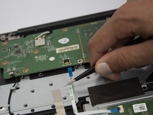

  12. Hisense Chromebook C11 Hard Drive Replacement: crwdns2935265:012crwdnd2935265:01crwdnd2935265:02crwdne2935265:0 Hisense Chromebook C11 Hard Drive Replacement: crwdns2935265:012crwdnd2935265:02crwdnd2935265:02crwdne2935265:0
    • Continue gently removing all remaining points of attachment.

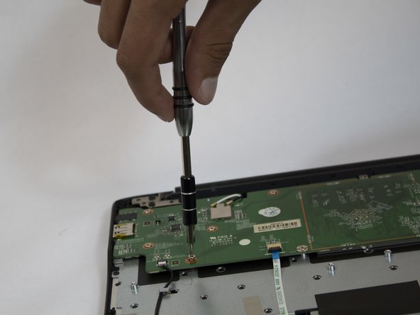

  13. Hisense Chromebook C11 Hard Drive Replacement: crwdns2935265:013crwdnd2935265:01crwdnd2935265:01crwdne2935265:0
    • Carefully remove the hard drive.
